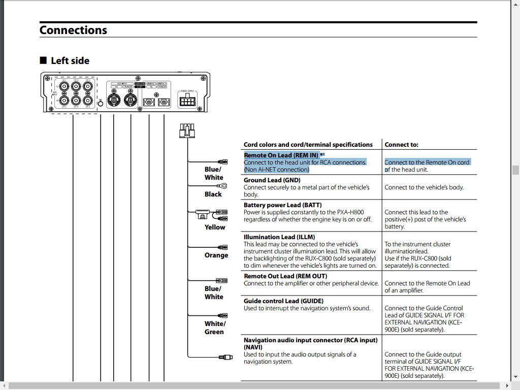

I'm assuming you guys cant follow simple instructions....
http://imgur.com/a/W4Cp4
Does the DSP turn on when you activate the 'radio' function of the HU? If so then you taped the wrong blue wire...the blue/white turns on amps etc....you may have tapped the antenna turn-on wire.
If that's not the case then you did something else wrong...my Alpine HU activates my PXA when I turn it on (HU).

We must've connected the incorrect blue/white wire then! I will check with my installer guy next Tues when I go out there, and will email him, too!

My Alpine PXA-H800 DSP now TURNS ON AND OFF with my HU!! Amps do too!!
Must be that chicken I sacrificed!! ;-)
