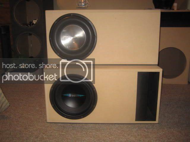

according to AudioPhil who is the biggest TC ***** around he found that 1.6 cubes tuned to 28 yielded the best results.....after bulding a few boxes for mine and testing it i found it to be correct
what kind of results I would rather have these wang then loose db's for sq. Also dbeez for depth lets stay 33 on the safe side how does it look for 4.2-4.5 cubes?
Mine in 1.75@29 htz sounds really good:)
He builds for a flat response in box, not in a car environment. Build for the car and cut frequencies the right way.
anyone who has Ti's doesnt go for straight SQ murph....these results were for SQL...these things were made to get loud and do work....
well how what would you say about these in 2 cubic feet each (after displacement) at 32hz or should I go 30hz 1.8ish cubic feet?
