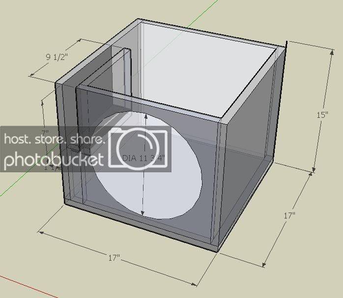

ok soo i was up all night "trying" to understand tuning and all that good shit haha and here's what i came up with for the treo 12...i sketched up 2 possible enclosures. let me know if im right wrong or somewhere close to where i should be haha
First Box Tuned to 35 Hz in a 1.877ft^3
H:15
W:17
L:17
Vent: 1.5x7x9

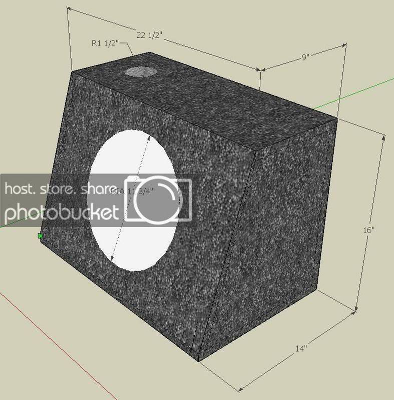

Second is tuned to 28Hz with 1.765ft^3
H:16
W:22.5
Top L:9
Bottom L:14
Port:
3inch DIA
11.6inches deep
