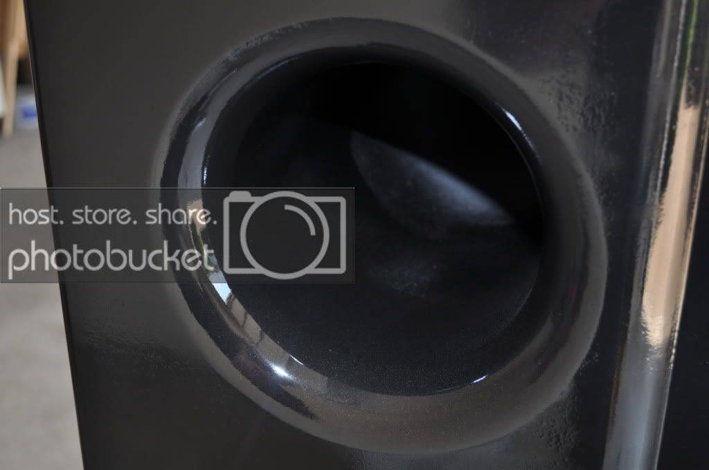

When I flare PVC, I normally use a 1 1/4" roundover bit on a double stacked baffle where the PVC meets the exterior of the box. This might save you some space and help you out.
