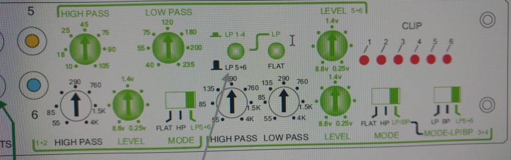

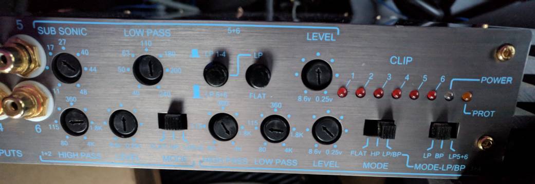

Is it possible to do this using my zed amp? What amp do you guys recommend for this?

Yes--Theres no need to buy another amp--The Zed you have is totally capable of providing the correct crossover points for a 3way active setup. They layed out the controols in a confusing way, so to avoid confusion, Id print off a few paper copies of the diagram & Use a sharpie to circle all the controls for ch 1&2, then 3&4 on the mext copy, then 5&6 on the third sheet. then go to the amp & methodically select your settings.
hope that helps.
