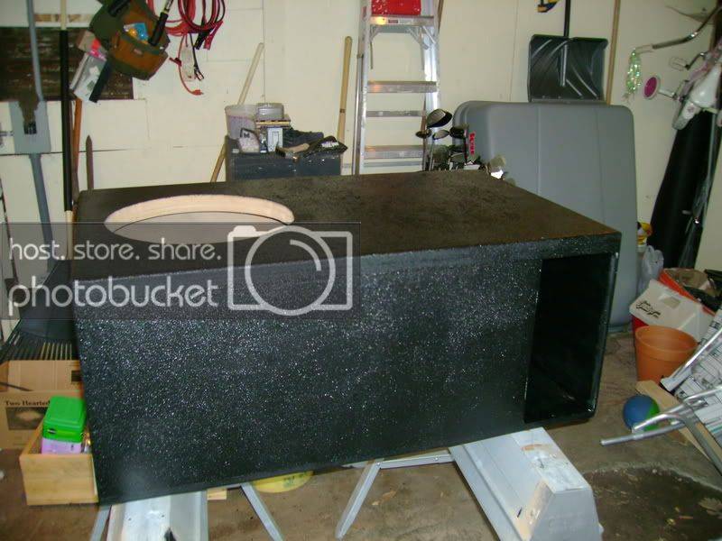

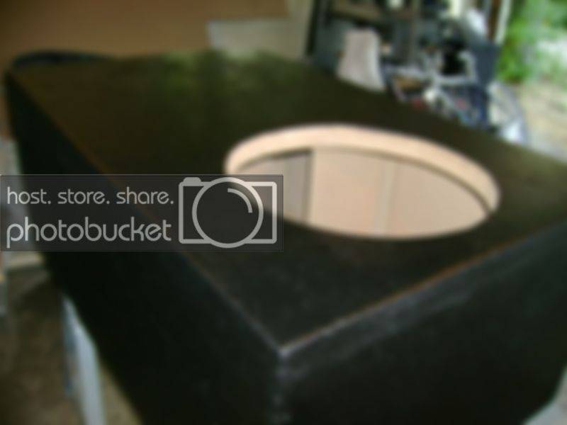

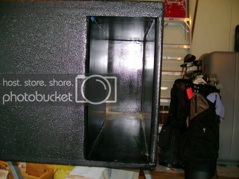

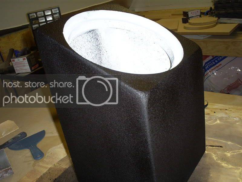

Yeah, but it is from far away. UPS put a few dents in it so you will see some imperfections. This is without the port painted, which is finished presently.
It is pretty durable imo.

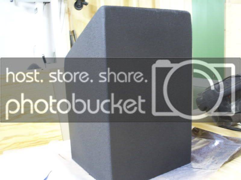

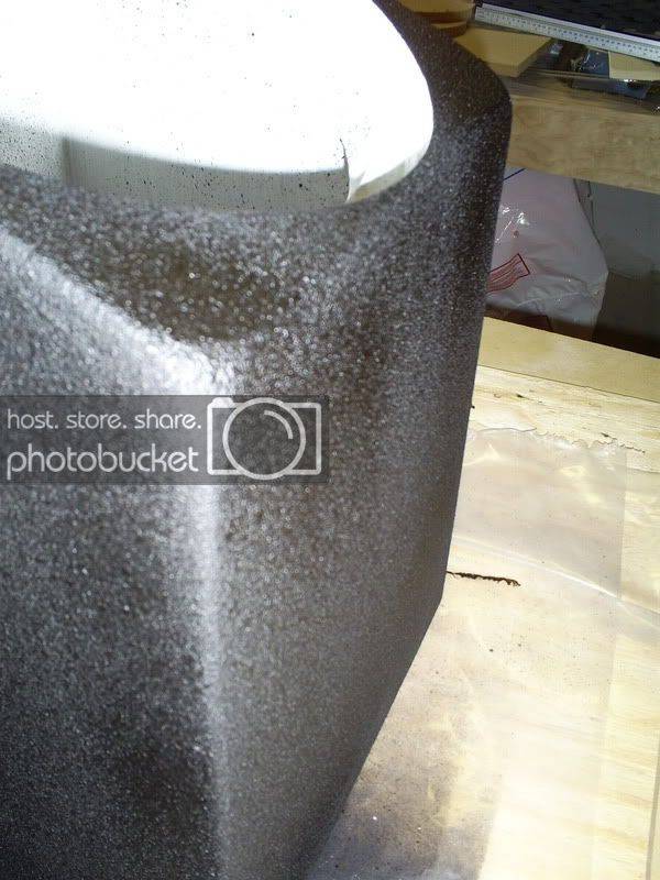

I just did a box for my friend single cab truck with spray on bed liner/undercoat. I started the walmart bed liner but it was terrible for spray. I then went to the spray on 3M rubberized undercoat, and IMO it cam out very nice. Takes a good few days to completely set and harden but if very strong and went on very well. If you want to see the progress of the box and how sh*ty it looked before the heres the link
http://s145.photobucket.com/albums/r228/netq/Thomas/
but heres some pics of it finished up.
Hope that helps!
net

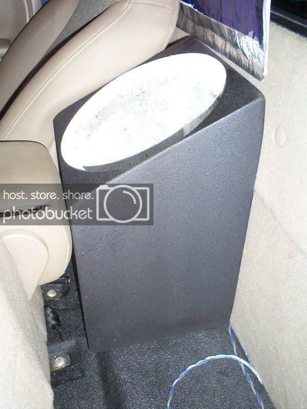

heres the box I did for my Xterra
no primer, just sanded. Port was primed and painted with gloss black latex paint. Very smooth and looks good against the bedliner
My AQ HDC3 15" is in there right now for a temporary setup in my MDX
