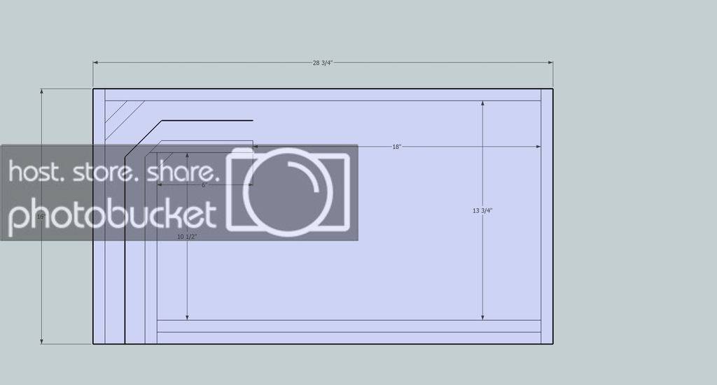

The real way to elbow your ports...
I was actually thinking about doing that. Kerfing the whole port. It'd be a btch to work with unless you have a really long / wide table / fence.
EDIT:: Got Bass ?, I'm tryin' to see if RE has an optimum port area... but, 49 cubic inches seems to be good. It's not set in stone yet, so, when RE responds, I'll put it in stone.

New port area is 35 with a 5.6:1 ratio. So, shouldn't be too bad. I'll sand the corners a bit just in case.
If you want me to make it less deep, and wider or taller, just ask. Takes me 5 minutes to re-do it. The current external dimensions are 28.75"W X 16"D x 15.5"H
Wasted_Ink is going to do a brief picture walk through, so I'll post it up here when he's done, or he can.

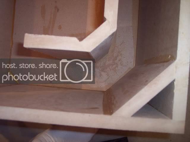

my second box ever made //content.invisioncic.com/y282845/emoticons/smile.gif.1ebc41e1811405b213edfc4622c41e27.gif
and its not the perfect port. actual rounded inner and outer corners would be best. the perfect port would be strait.

It looks good. I would've put a piece in between the inside port, or resin it up to strengthen it a bit. No offense, just looks kinda flimsy.
Thats why you a noob. Its screwed on the bottom and the top, It isnt going no where. Not to mention the glue..........

I wasn't saying you HAD to do it this way, or you're wrong. This is just the proper way to do it. You can do whatever the hell you want. Leave it with out an elbow at all, I could care less. I was just informing the people who want to know the right way to elbow a corner, rather than just creating a bottle neck. I still don't know why you're trolling this thread.
Not sure why some people are getting on the OP's case. This isn't really a debate! Whether or not you feel it is necessary or not, the OP's method of elbowing mimics a kerfed elbow and is superior to that of a straight 90 degree bend.
