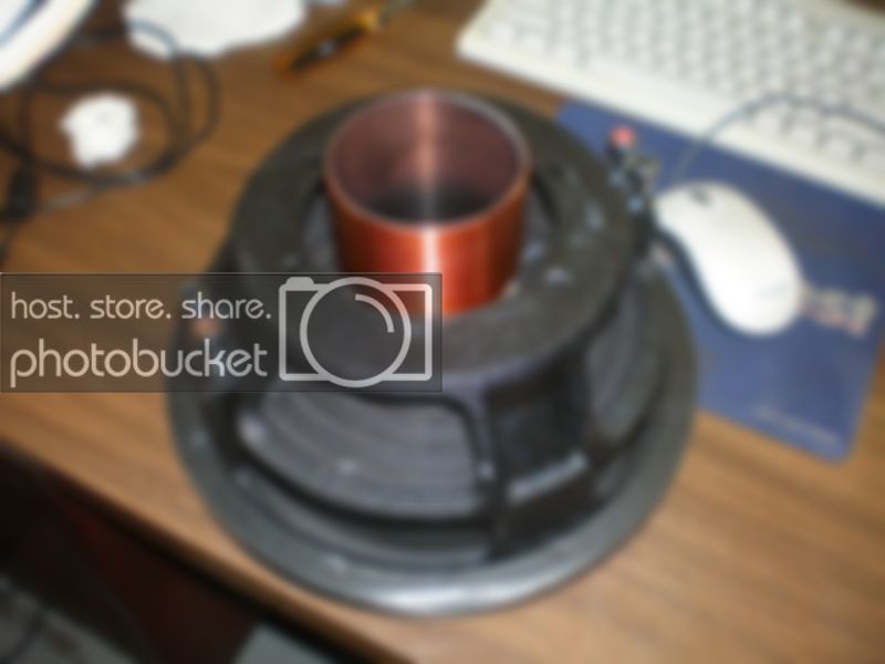

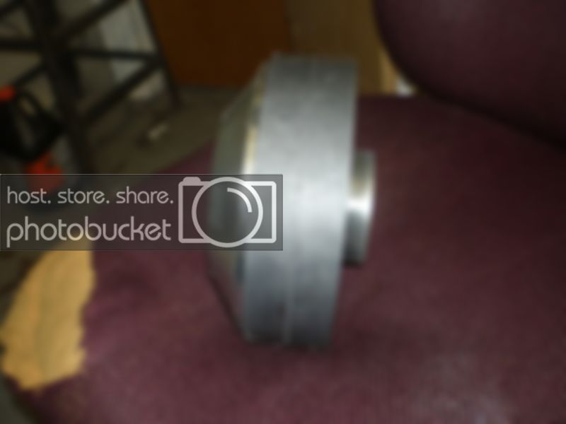

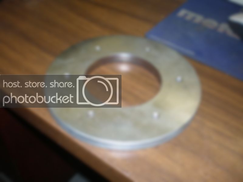

Can someone tell me what is wrong with these pictures?
~Magick_Man~
well it started out as a oem10.
and now it is this.
seems that the glue used to attach the top plate sucks big time.
i am attempting to salvage the driver since the voice coil wasn't destroyed.
now i just need to find a glue that will actually hold it together.
~Magick_Man~
well it started out as a oem10.and now it is this.
~Magick_Man~
thats weird, cause i have never seen that happen. what did the glue look like when it came off?
well there wasn't that much of it.
and in spots it was still sticky.
so i immagine it was either bad glue or something else in the process went wrong.
i only hope the bottom plate doesn't do the same thing //content.invisioncic.com/y282845/emoticons/frown.gif.a3531fa0534503350665a1e957861287.gif
~Magick_Man~
Not the easiest to reattach a top plate once things are magnetized. You need to be careful and make a nice long gage to slide things back into place while the glue dries. (pinching fingers between a top plate and a stack of charged magnets is less than fun) You wont have much of a choice recentering the "top assembly" either as you are relying on the 6 mounting screws to the top plate and not the soft parts around the pole piece. But, considering the gaps are normally a little on the larger side it should be good.
