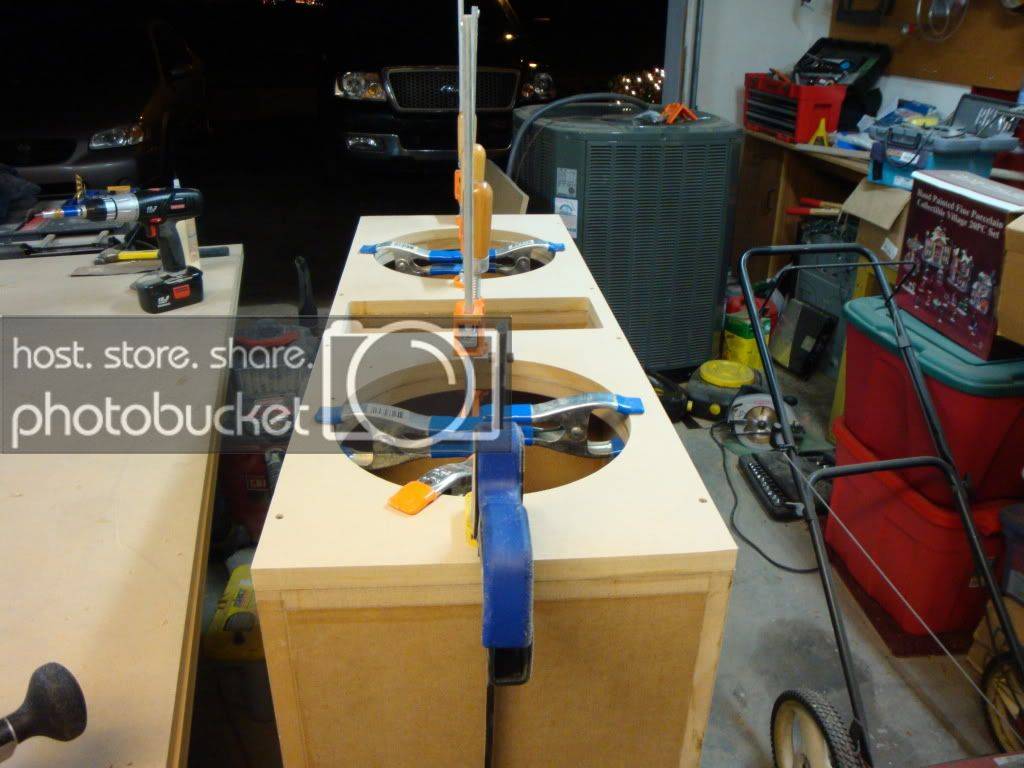

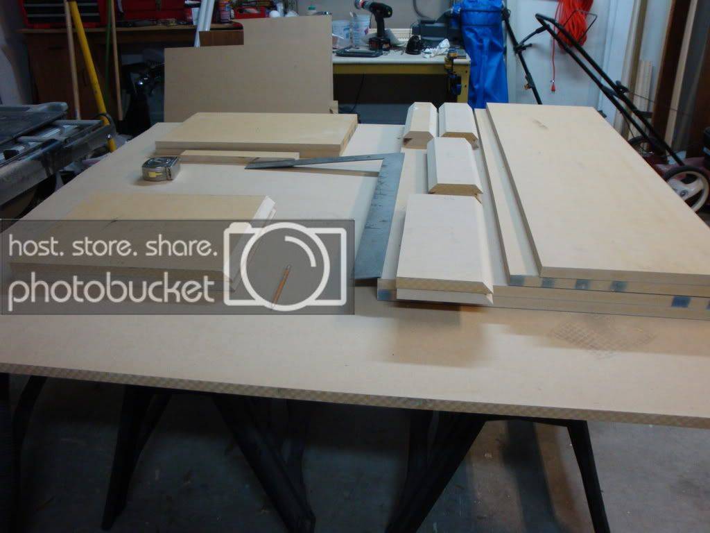

Some progress I made today.

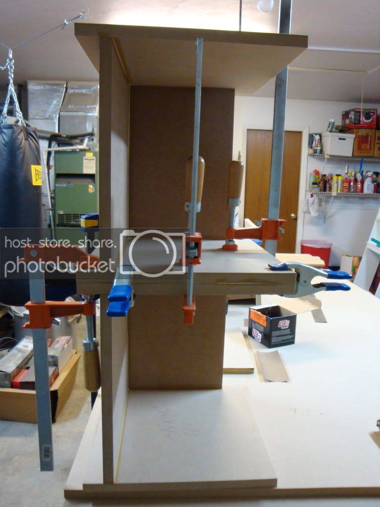

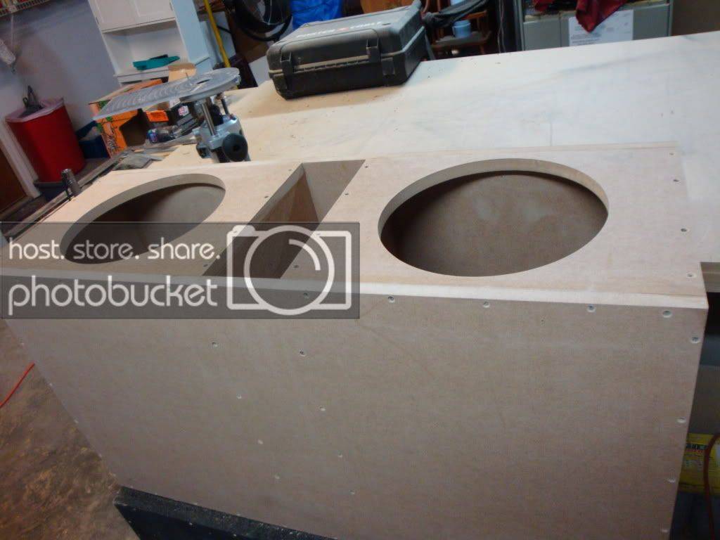

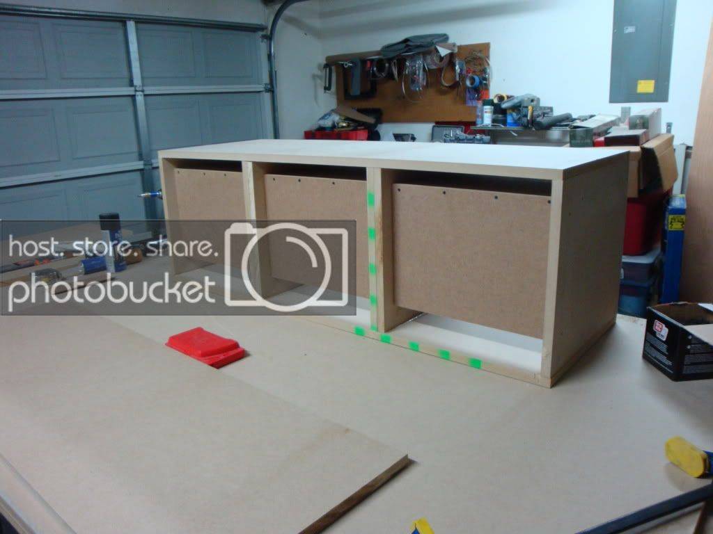

This is the mock up of what I have so far. I will be doing a countersunk baffle as before with the exception of a second mounting baffle. x3 baffle this time. Firing it into the cabin as well. Hopefully I can make the "tunnel" the box will slide into tomorrow after the game.

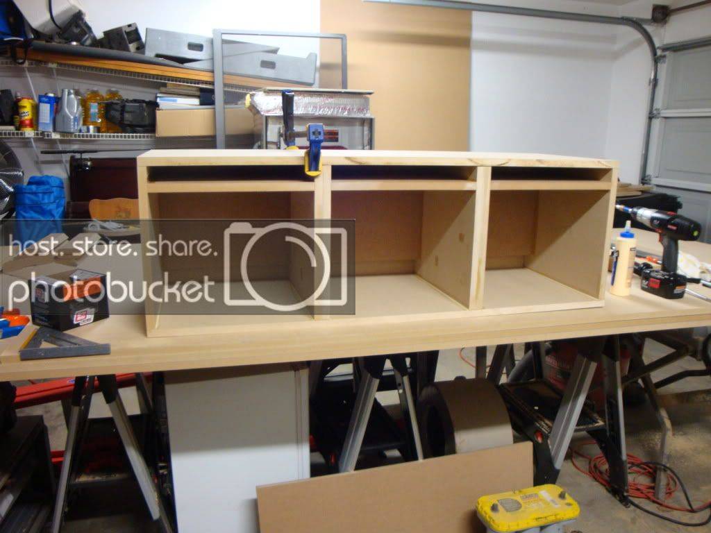

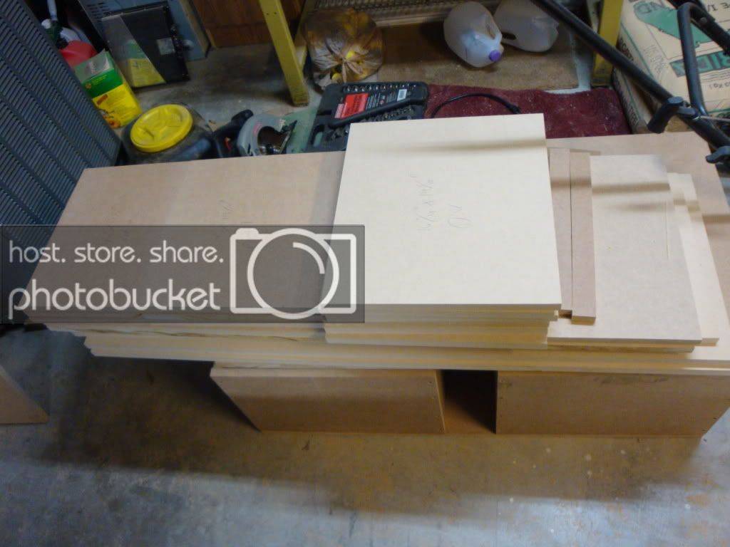

So I had to take some time out to do another box.

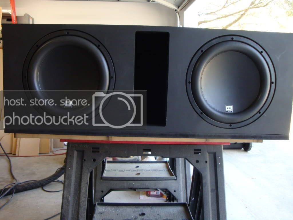

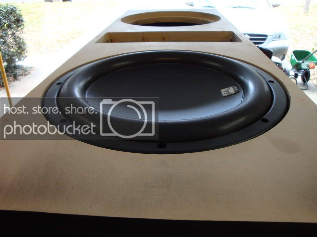

It is for 3-12" W6's 1.5cf per chamber and tuned to 34Hz.
I didn't get to hear it, but the word is it was impressive. //content.invisioncic.com/y282845/emoticons/smile.gif.1ebc41e1811405b213edfc4622c41e27.gif

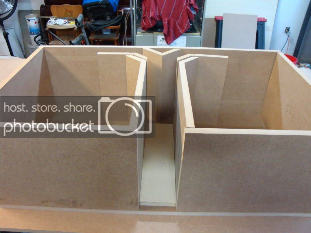

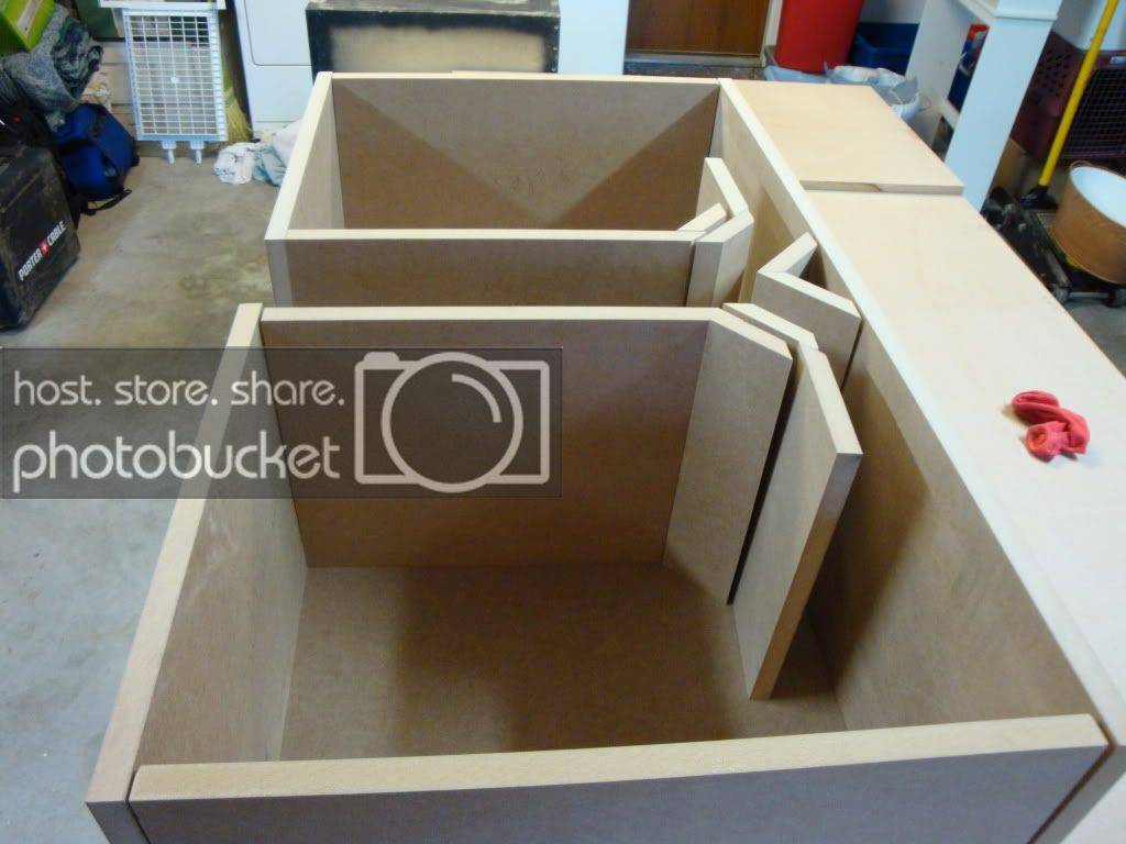

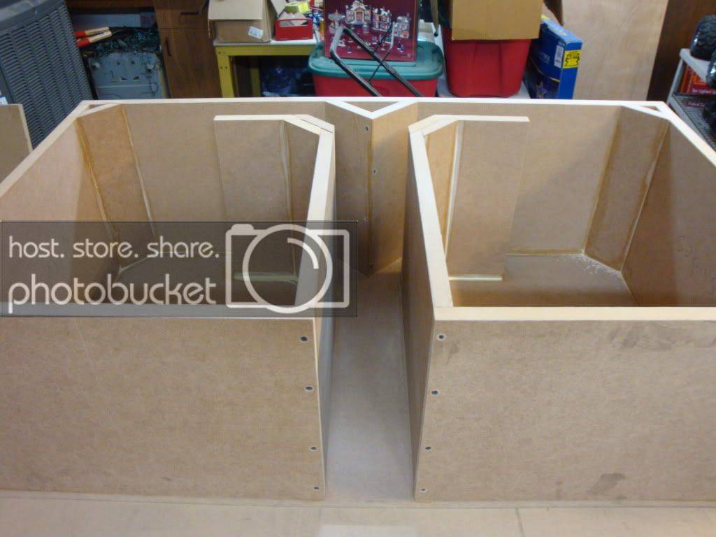

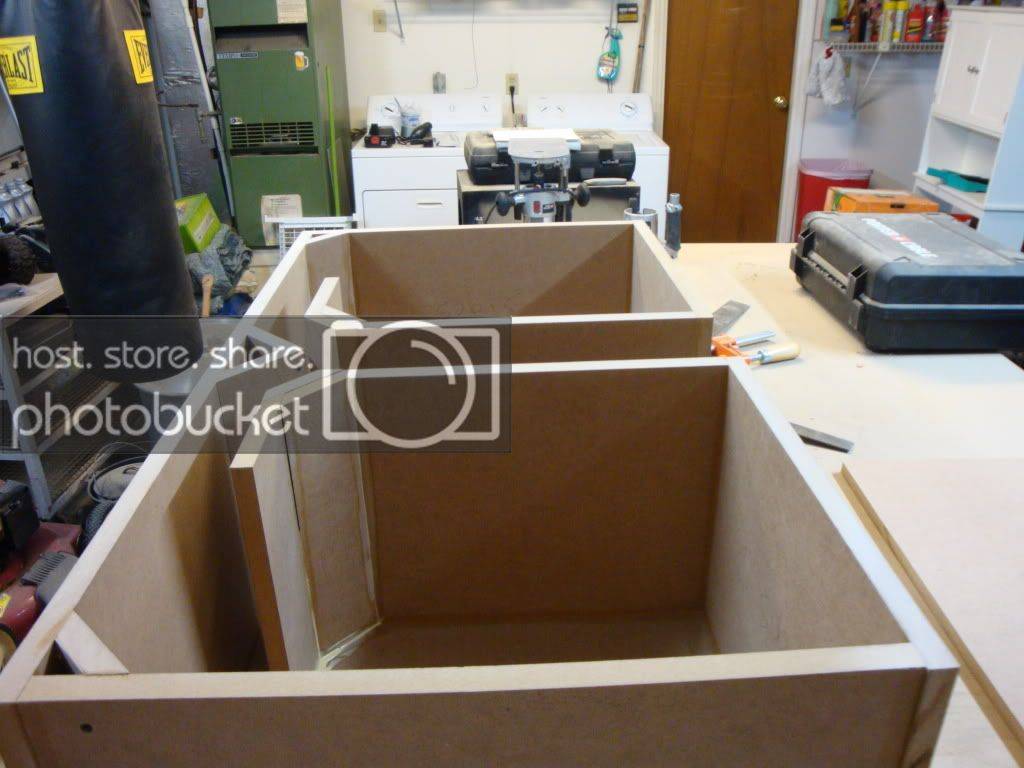

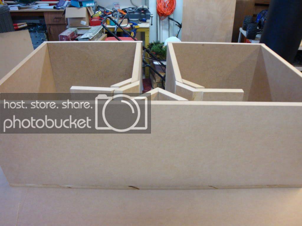

Now back to my original project. I was able to finish the ports and back wall and add the additional 45's today. Tomorrow I will hopefully get the other two baffles cut out and attached. The top is cut, just waiting for a final sanding and glue & screw.
I also hope to get the mount cut so I can determine the placement in the car. I still have a lot to do. //content.invisioncic.com/y282845/emoticons/smile.gif.1ebc41e1811405b213edfc4622c41e27.gif

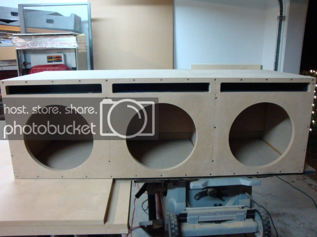

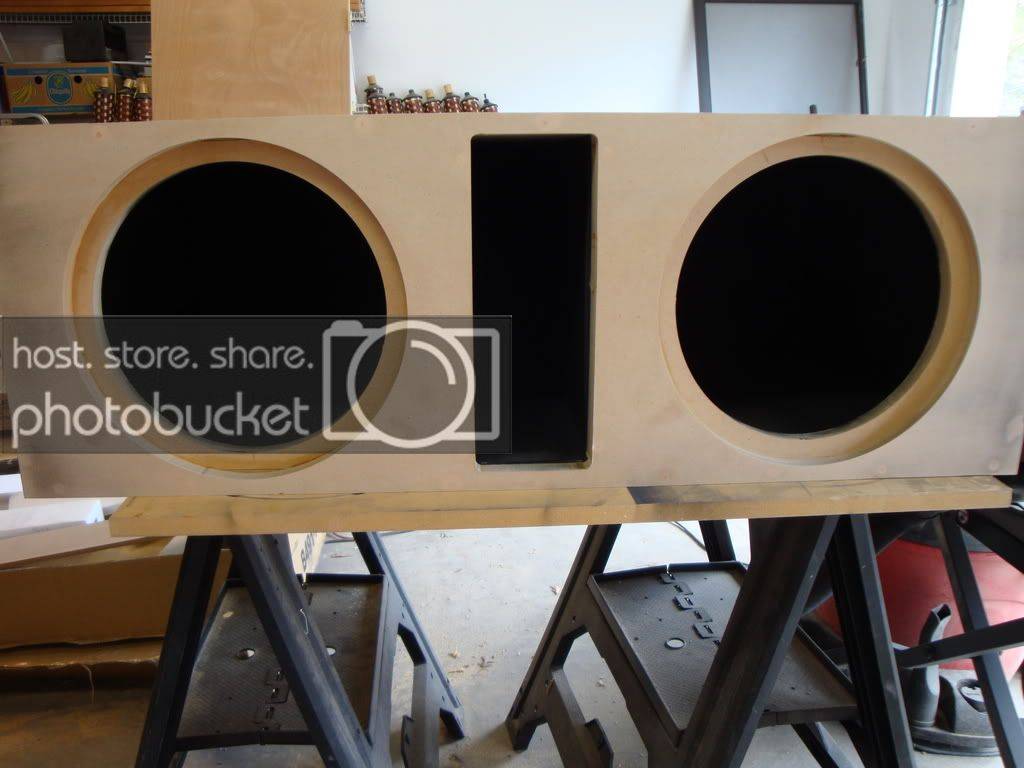

So I got uber motivated for some reason. I finished up the sanding so everything was flush up top and glued and screwed the top on, finished the initial flush cuts, and cut out the first 2 of 6 circles for the sub mounts. //content.invisioncic.com/y282845/emoticons/smile.gif.1ebc41e1811405b213edfc4622c41e27.gif
It is only 7:20PM here so I may go ahead and cut out the other two baffles and get those mounted so I can do the round over on the port and start planning the rest.
Second baffle is cut and installed. I am done though. The countersunk 3rd baffle will have to wait till tomorrow.

Looks and sounds excellent, some good flex there..
Nice job.
Thanks! I don't think it is too shabby for 2 sq subs. //content.invisioncic.com/y282845/emoticons/smile.gif.1ebc41e1811405b213edfc4622c41e27.gif
