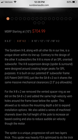

U guys don’t even know what you talking about. The x8 is the Spl 8” from sundown and does not have more lowwws then the SA8... u want an SA8 for more well rounded subwoofer.
Go to sundowns website site and read it. The x8 is SPL woofer not lowww end woofer
