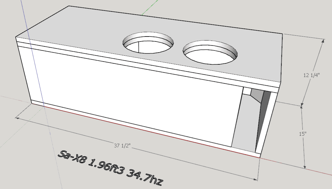

Last pair of X8's I designed for were around 4ft3 gross. I think the box was 12.25" h x x 37"w x 15" d. Is your current enclosure anywhere near that size? Also was about 2ft3 net with 32.5in2 of port at 16.58in2^ft3. Tuned to 34hz or so it supposedly got down well according to the guy I designed it for. Goin' from the Sa-8's to X's I think the enclosure should be changed.
This was it...
