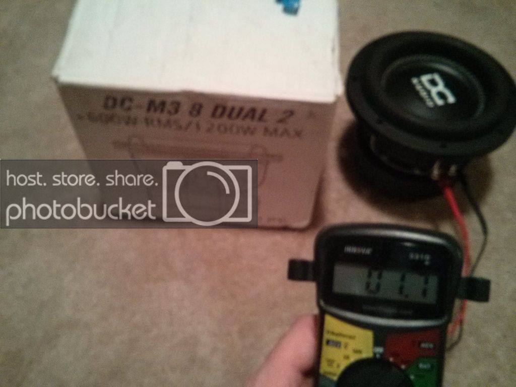

Check the coils yourself with a simple DMM. If they are D4, then those are normal readings....the person is lying or forgot what impedance the sub is. Checking D4 will result in less than 4.0 always reads less than the standard number. Same goes with dual 2 ohm. Have an example below of my DC Audio m3 8. It's dual 2 ohm so I checked it upon arrival.
Thanks Boomin_Tahoe and everyone who chimed in, feeling much better about my purchase //content.invisioncic.com/y282845/emoticons/smile.gif.1ebc41e1811405b213edfc4622c41e27.gif
