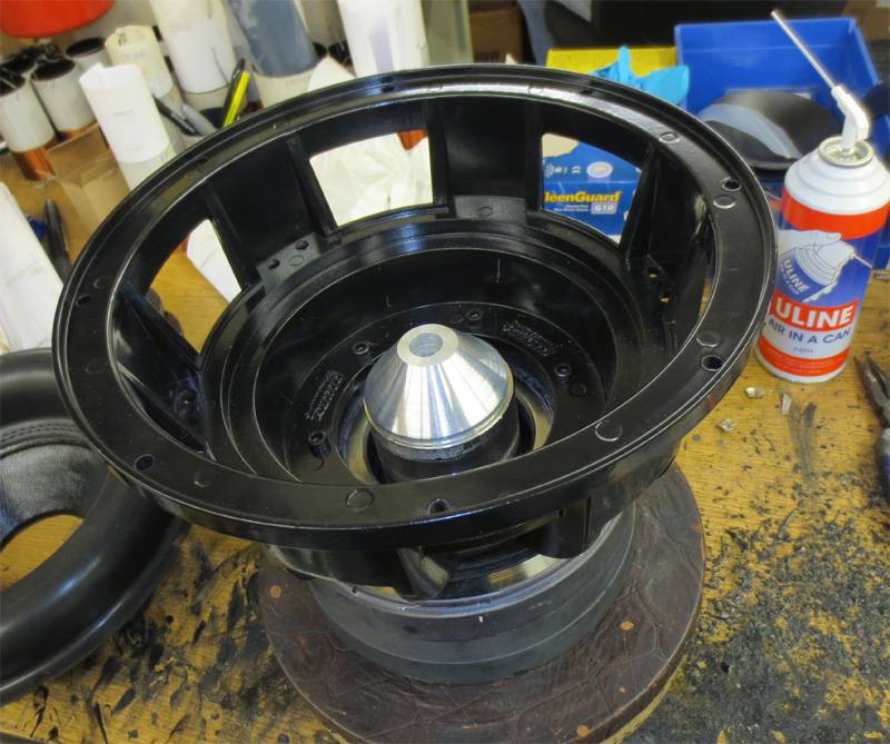

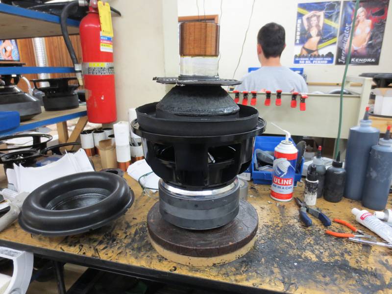

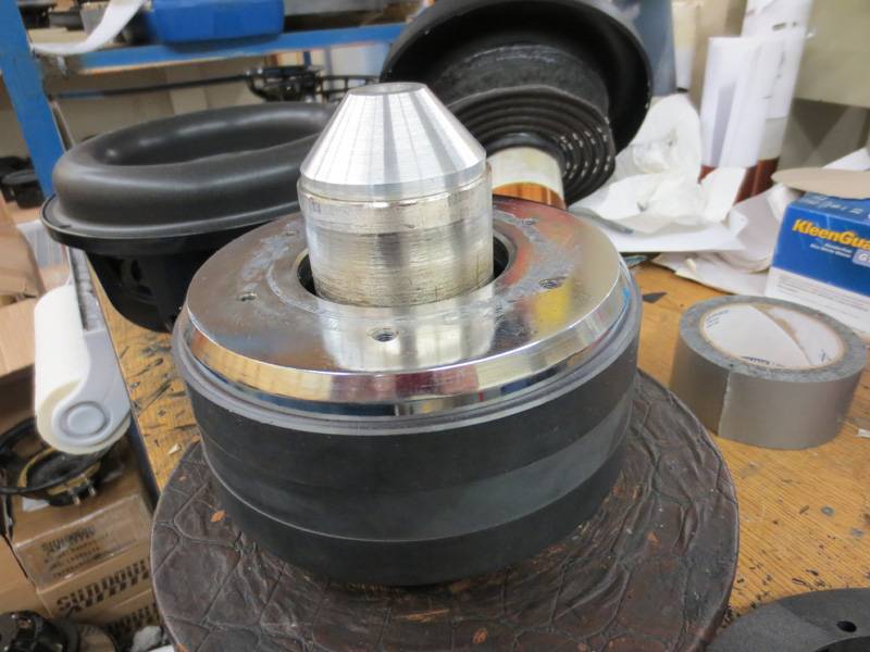

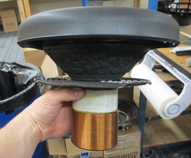

Here are a few pics of the X-10 soft parts and motor that haven't been show yet :
* Original parts; 60mm long 3" D4 coil
* Fun pic with parts upside-down on the motor and frame
* Very tall pole extension to keep the coil from smacking into the top plate when it leaves the gap (as the suspension allows that much throw) + the top plate has a small bevel on it as well as another safety measure. The tall pole extension also gives us more linear x-max.
* Frame on the motor. One thing about the new motors with the tall extensions is that they won't work on "standard" frames as the pole extension would be too tall -- unless, of course, one machined customer spacers to get the basket higher. Other coils will work on the gap but other frames aren't practical to use (except other tall frames like the Ti style).
