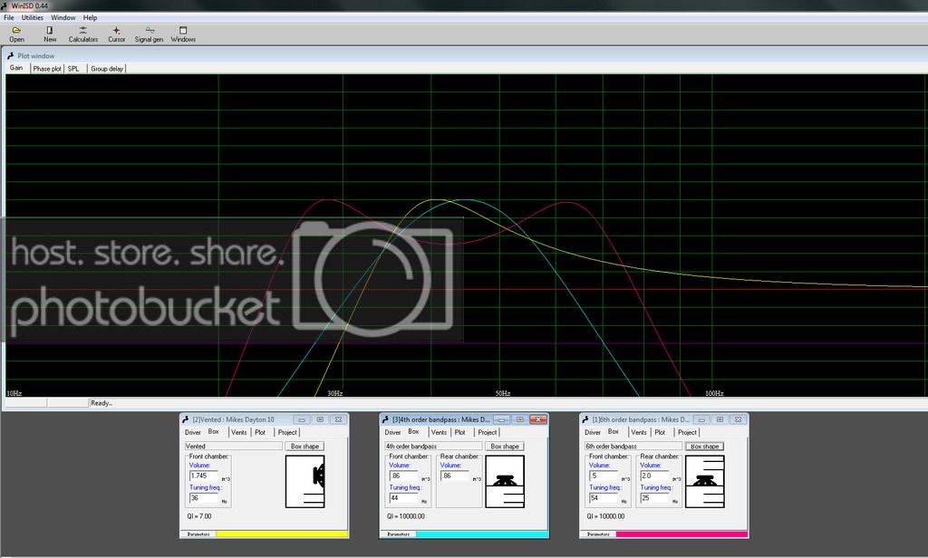

Ok so I played around in WinISD with the Dayton Audio 10" and if I am reading these right, specifically the 6th order enclosure, this sub should be able to cover all the sub frequencies I would need it too right? The DSP should have no issues equalizing 2.5db in the middle right? That looks pretty flat to me and a "3 cubic foot" enclosure should be able to fit most trunks or cargo areas if designed correctly. I hope the pic is readable... I did a ported, 4th order and 6th order. How would you guys interpret this image?
