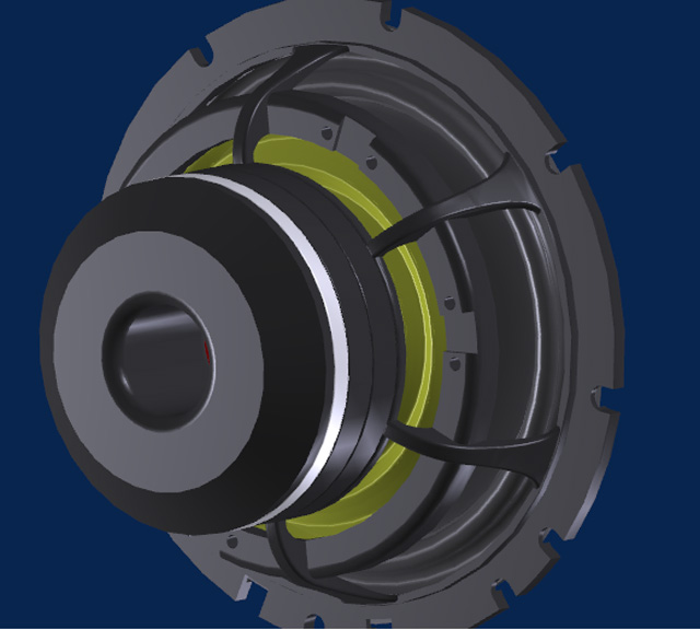

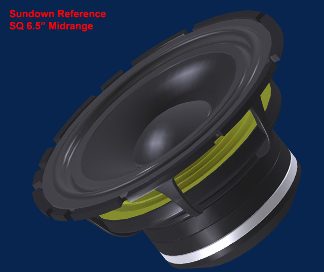

* Powerful Neo motor with very thick top plate (hint hint)... the surround is a specially tooled until to have identical forward and rearward compliance. The motor features two internal shorting rings and a naturally low inductance already. I will say that this driver does feature double-digit one-way excursion (linear) so will offer very powerful mid-bass.
* Very open frame similar to Dynaudio or Scan-Speak and the like but this particular unit will be tooled just for this driver. As this is an SQ unit we opted for a large open pole vent to keep air noise to a minimum. The coil is a fairly large diameter unit for a mid so thermal handling is not a concern.

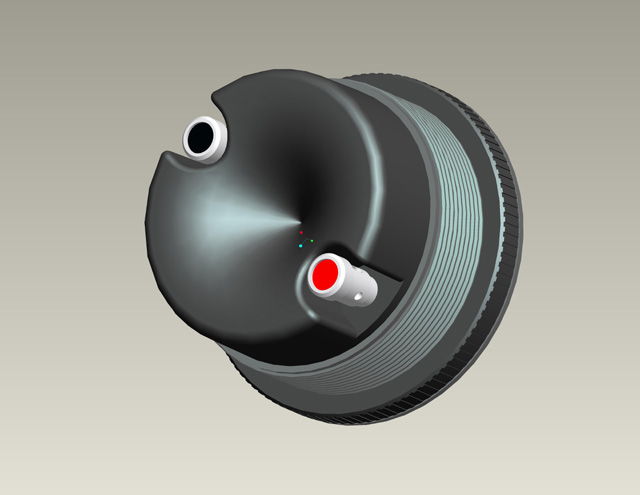

* Specially tuned rear chamber (the shape is for specific acoustic purposes)

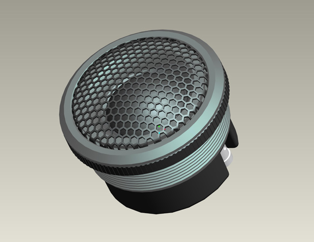

* The housing mounts similarly to many other high-end tweeters so bears a resemblance to a few but this particular housing will be tooled for the specific internal needs of our tweeter. Higher end tweeters such as this unit have quite a bit going on internally to damp the rear wave and tune the Fs of the unit.

It reminds me of a neo version of the exodus 6.5 that used to be around.
The old Exodus 6.5 WAS neo... does look like similar motor and frame. A very good platform IMO.
