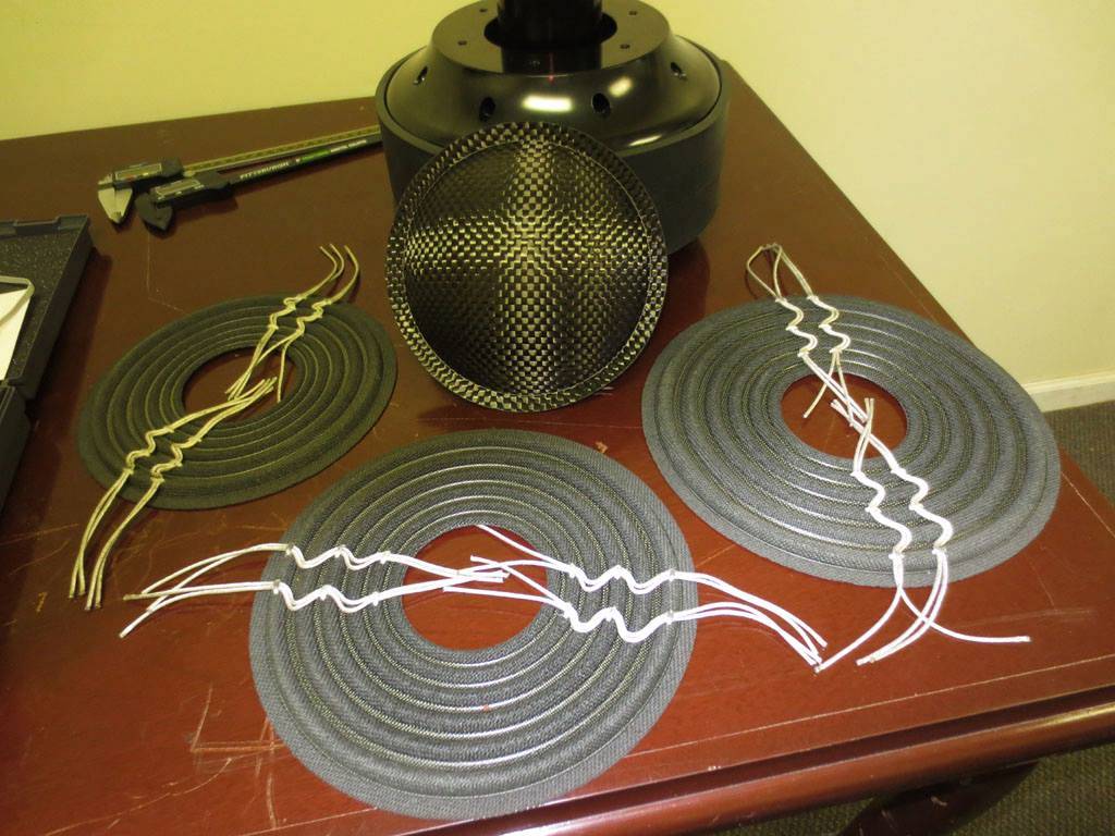

1) New heavy duty "stackable" SPL spiders... same material and similar geometry to the NS v.1 / v.2 spiders but available in all of the new larger sizes. There are several advantages to these for SPL applications.
* They are lighter. The spider "packs" on stock woofers require more layers for a givens stiffness and the layers are all permanently adhered together over their entire surface area with a flexible adhesive. The extra spider material and the adhesive both have mass.
* They are more consistent over time and temperature range in terms of their stiffness. The "packs" can change FS a bit based on heat or cold as the bonding adhesive will loosen up or stiffen based on temperature.
* They tighten up more over stroke. This leads to the desirable climb in FS over stroke for SPL applications. It also gives a more "traditional" sound for those that may not like the ultra linear sound of the new drivers.
* There is more adjust-ability as we can stack however many or however few you want.

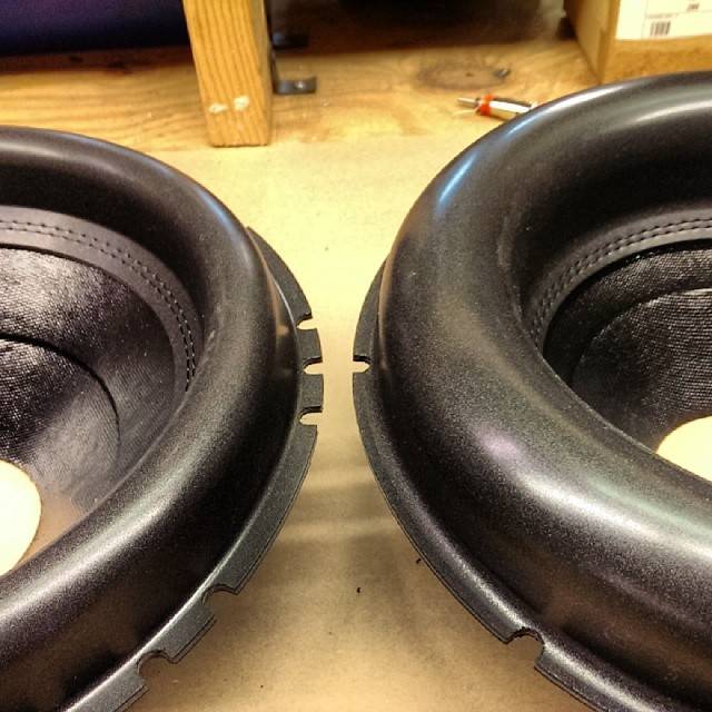

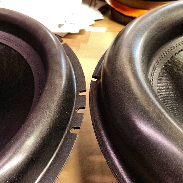

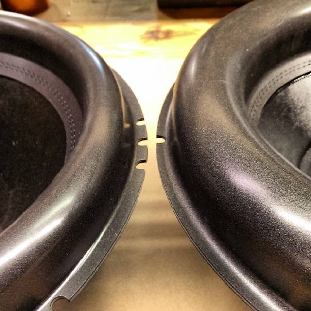

** 10 Inch SPL Roll vs. Mega-Roll
** 12 Inch SPL Roll vs. Mega-Roll
** 15 Inch SPL Roll vs. Mega-Roll
** 18 Inch SPL Roll vs. Mega-Roll
** "SPL" Spiders -- these are like extra large NS v.1/v.2 Spiders
