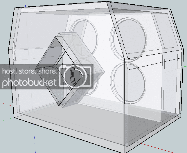

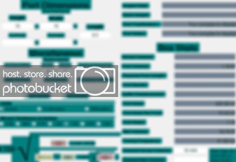

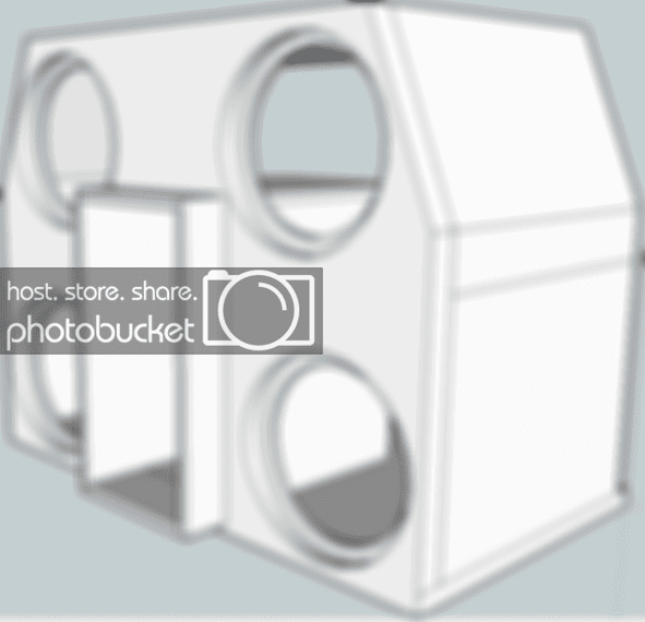

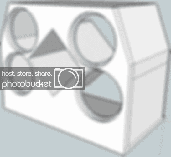

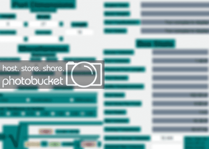

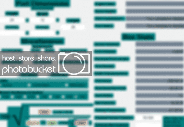

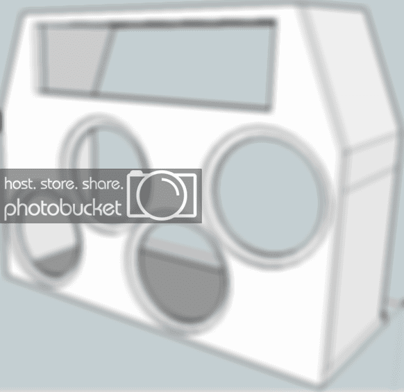

okay so ive been working on a few designs i wanna do a wall behind my second row seats so a "C" pillar walls. not sure if i wanna go 4th order or just ported. what are your thoughts.
info-
subs: 4 sundown e15's
vehicle: 2004 toyota sequoia
location in vehicle : behind second row, c pilar
box type: walled 4th order or ported wall
amp: ta1.3000d
[/url
I like the tuning and net volume. If anything I would skin down the size of the port slightly but keep the tuning closer to the same
you think i should tune more towards the 34hz range
