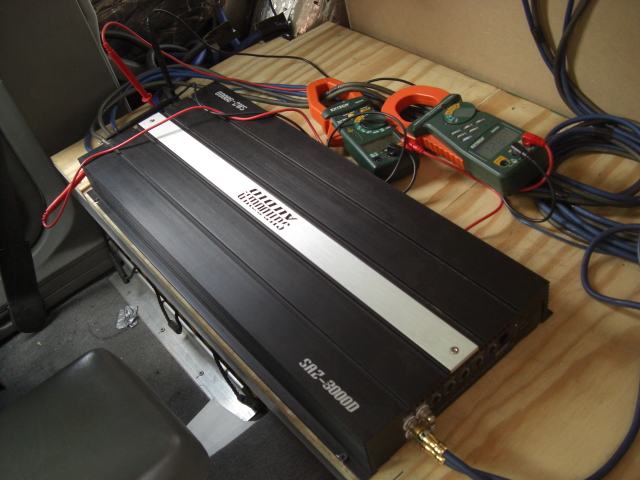

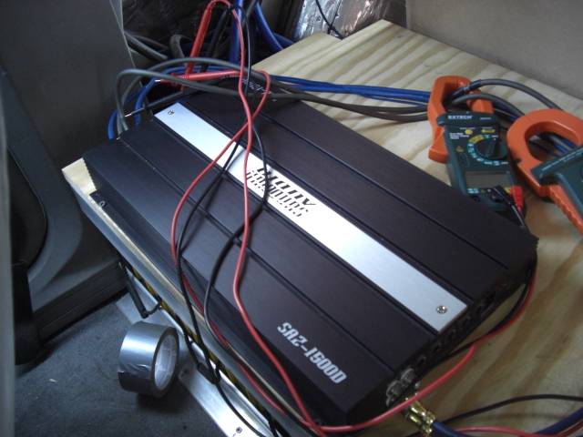

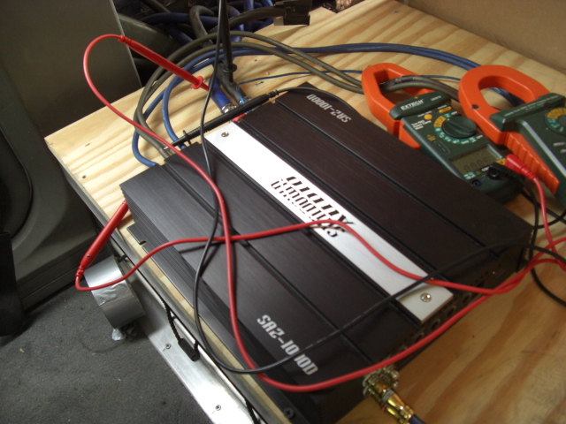

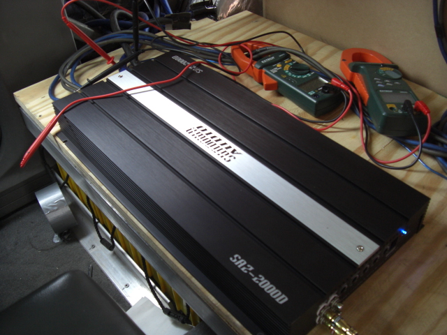

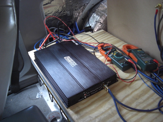

I am going to go through and drop the SAZ-1000D, SAE-1200D, SAZ-1500D, SAZ-2000D, SAZ-3000D, and SAZ-3500D in the Jeep and do a power clamp test so we have a rough and UNIFORM comparison between the amps in the same setup.
Test Frequency - 50 Hz

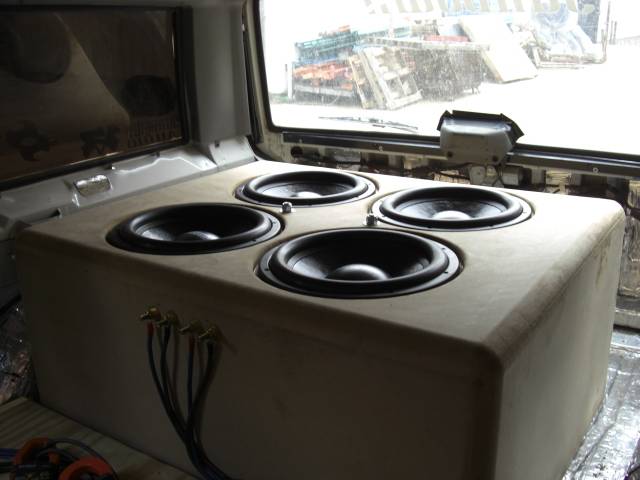

Test Load - 4x SA-12s all in parallel for 0.4375 DCR (1/2 nominal)
Test Electrical - 6x Stinger SPV-70 + 225-Amp Alternator (vehicle only at idle)
Amp gain set to 1/2 - Head Unit Sub Control 10/10 - Head Unit Volume 50/50
Setting gain to half on each amp is, of course, not an exact match... but for the sake of roughly comparing the amps I think it serves the purpose.
SAZ-1000D:
POWER : 1040 Watts
AMP VOLTAGE (measured) : 37.2 V
AMP CURRENT (calculated) : 27.95 A
ACTUAL IMPEDANCE (calculated) : 1.33 ohms
SUPPLY VOLTAGE : 13.15 V
http://www.sundownaudio.com/misc/_AMP_POWE...0D/CIMG2498.MOV
* Power Clamp
http://www.sundownaudio.com/misc/_AMP_POWE...0D/CIMG2499.MOV
* Voltage Measurement

SAZ-1500D:
POWER : 1970 Watts
AMP VOLTAGE (measured) : 49.25 V
AMP CURRENT (calculated) : 40 A
ACTUAL IMPEDANCE (calculated) : 1.23 ohms
SUPPLY VOLTAGE : 12.85 V
http://www.sundownaudio.com/misc/_AMP_POWE...0D/CIMG2493.MOV
* Power Clamp
http://www.sundownaudio.com/misc/_AMP_POWE...0D/CIMG2494.MOV
SAZ-2000D:
POWER : 2440 Watts
AMP VOLTAGE (measured) : 56.18 V
AMP CURRENT (calculated) : 43.43 A
ACTUAL IMPEDANCE (calculated) : 1.29 ohms
SUPPLY VOLTAGE : 12.5 V
http://www.sundownaudio.com/misc/_AMP_POWE...0D/CIMG2503.MOV
* Power Clamp
http://www.sundownaudio.com/misc/_AMP_POWE...0D/CIMG2504.MOV
SAZ-3000D:
POWER : 3280 Watts
AMP VOLTAGE (measured) : 61.28 V
AMP CURRENT (calculated) : 53.52 A
ACTUAL IMPEDANCE (calculated) : 1.14 ohms
SUPPLY VOLTAGE : 12.1 V
http://www.sundownaudio.com/misc/_AMP_POWE...0D/CIMG2506.MOV
* Power Clamp
http://www.sundownaudio.com/misc/_AMP_POWE...0D/CIMG2507.MOV

These are not necessarily definitive tests on the amps.
All applications are different and I could have probably squeezed more out of an amp here or there... but for the sake of this test I just set the gain knobs to physically 1/2 way up.
Just a rough guide to show what the amps can do!
I may go back one day and do an SPL comparison as well -- as we have seen up to 1 dB increase from the 3000D to the 3500D even though the power test doesn't seem to indicate as much. With the SPL portion I would sit down and tweak knobs until I got maximum SPL per amp.
I tested amps from smallest to largest (for the most part except 1200D was tested last) -- so the batteries did not have a complete full charge by the time I got to the big amps, just a few minutes of alternator charge time... that just means the bigger amps will produce more than posted if I had a complete charge. This was mentioned in my initial post so I thought I would post it here as well.
