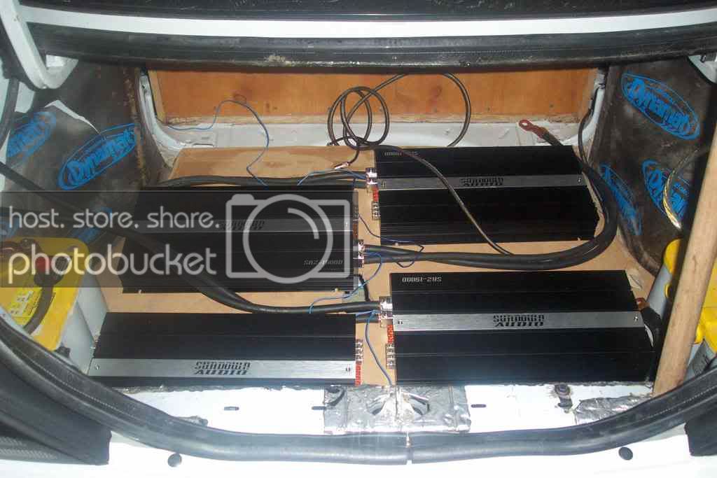

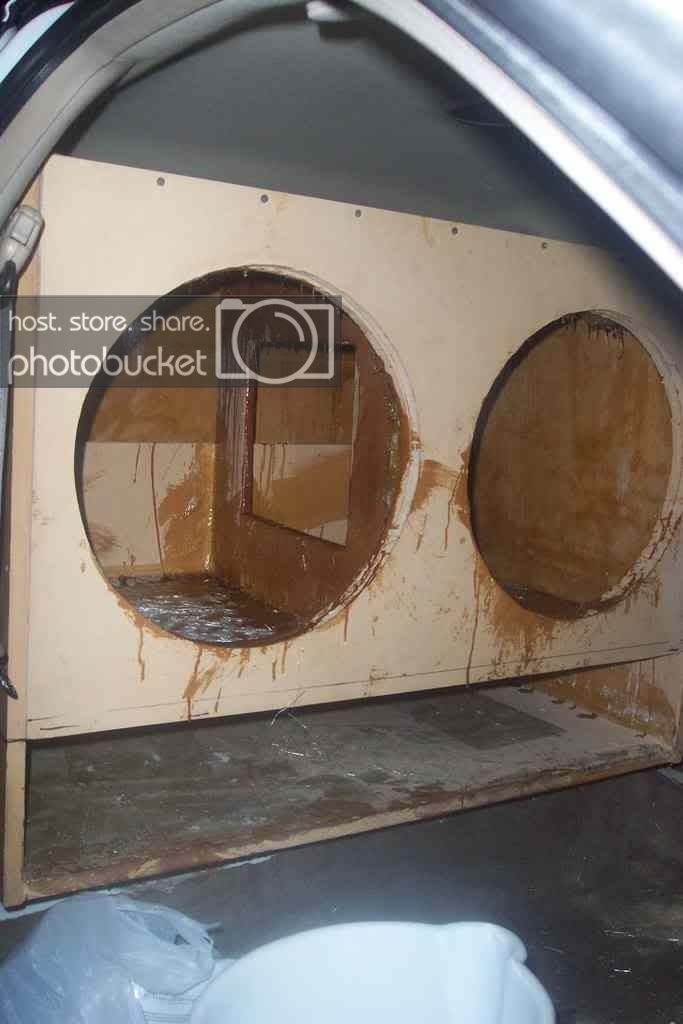

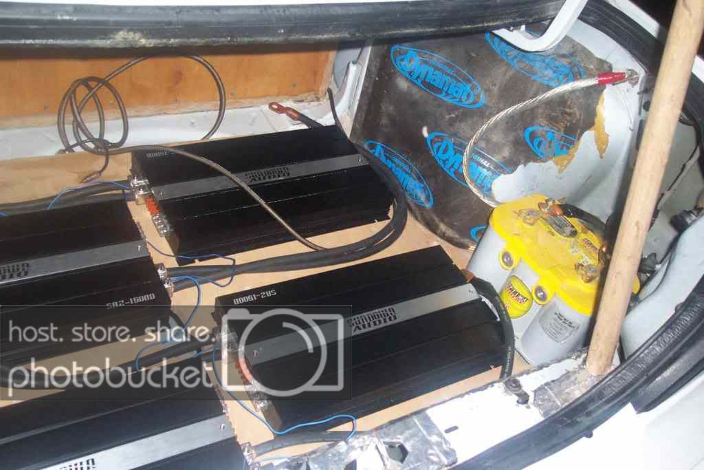

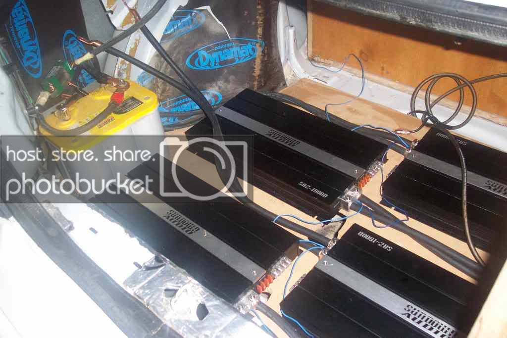

its a mess. but i like the amps for sure. weird brace your using in that box. personally, i would have just double layered the outside panels and triple the front and leave it at that
It's a rather thick looking "window" brace and is stronger than just doubling up exterier walls and it ties them all together. Good choice...
Like the amps, I happen to run 4 of them myself //content.invisioncic.com/y282845/emoticons/wink.gif.608e3ea05f1a9f98611af0861652f8fb.gif
No offense or anything my man . But the bracing he has in place will provide more structural bracing than what you suggested //content.invisioncic.com/y282845/emoticons/smile.gif.1ebc41e1811405b213edfc4622c41e27.gif
Yeah man, no offense.
Subs will be 2 RE XXX 18s (05 models) and the box is tuned to 30 so I didnt want the port flexing at all. I have some more pictures. More cleaned up. Also with the amps in the back will be covered anyways . I need trunk space. Im going to add another layer of MDF, wrap it in suede and flush mount the subs. But I will say, quite a mess. The brace touches the front baffle, the top, and the port. Just 3/4 MDF.
