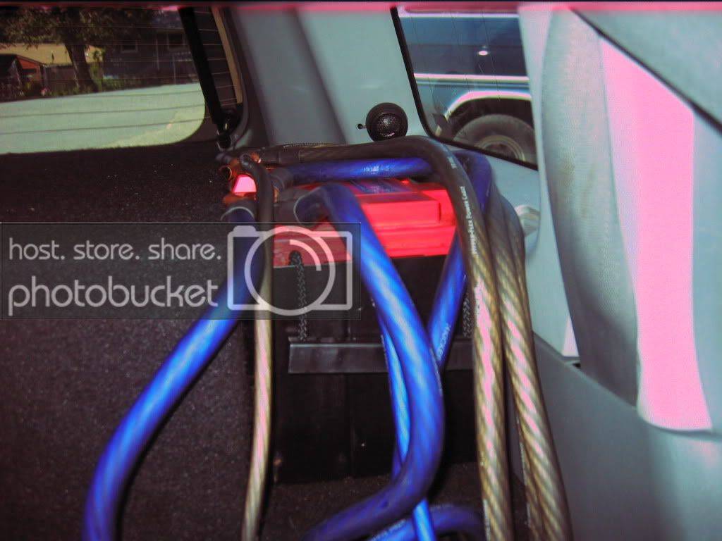

Are you finding that the back seats, when reclined, are pinching the power wire too much? I have 4 awg and it gets caught up pretty well. And your wiring looks a bit bigger than 4 awg.

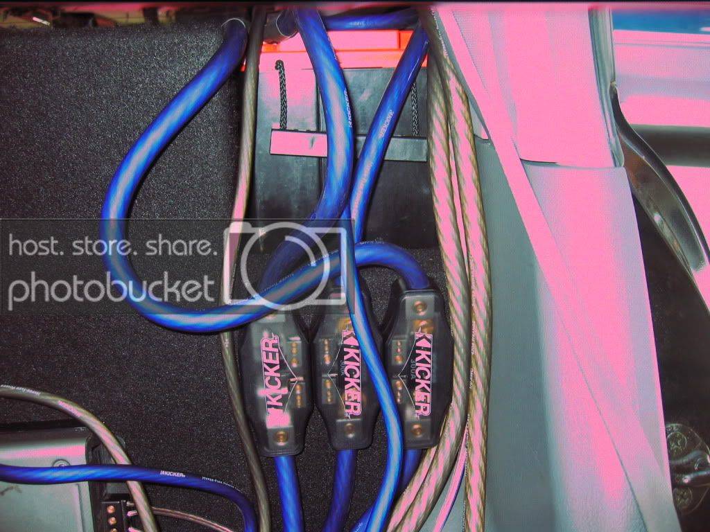

So how many PKD1 kits did you go through?
lol i only bout 2 and then pieced all the rest together. there is like at leas 100 feet or 1/0 in there
-Matt
yeah its 1/0 and i haven't had any trouble with it pinching, not even with my 4 gauge...also my seats don't go back very far because of the box

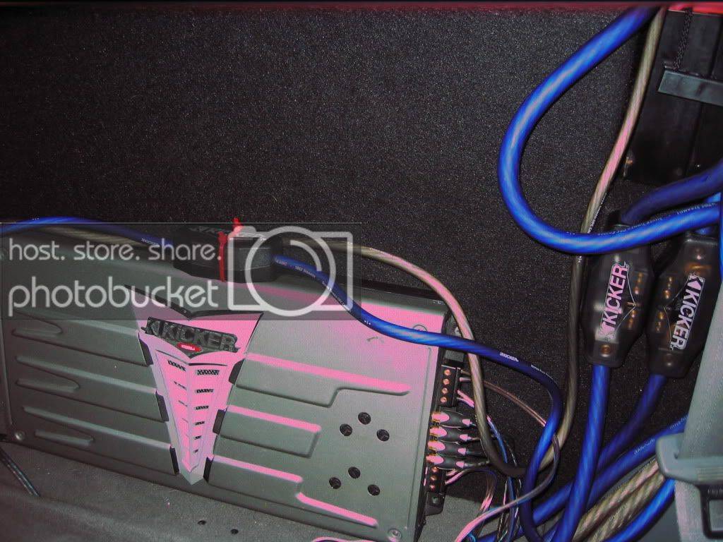

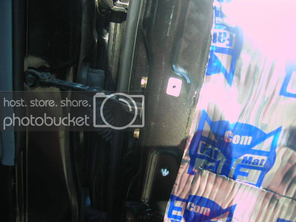

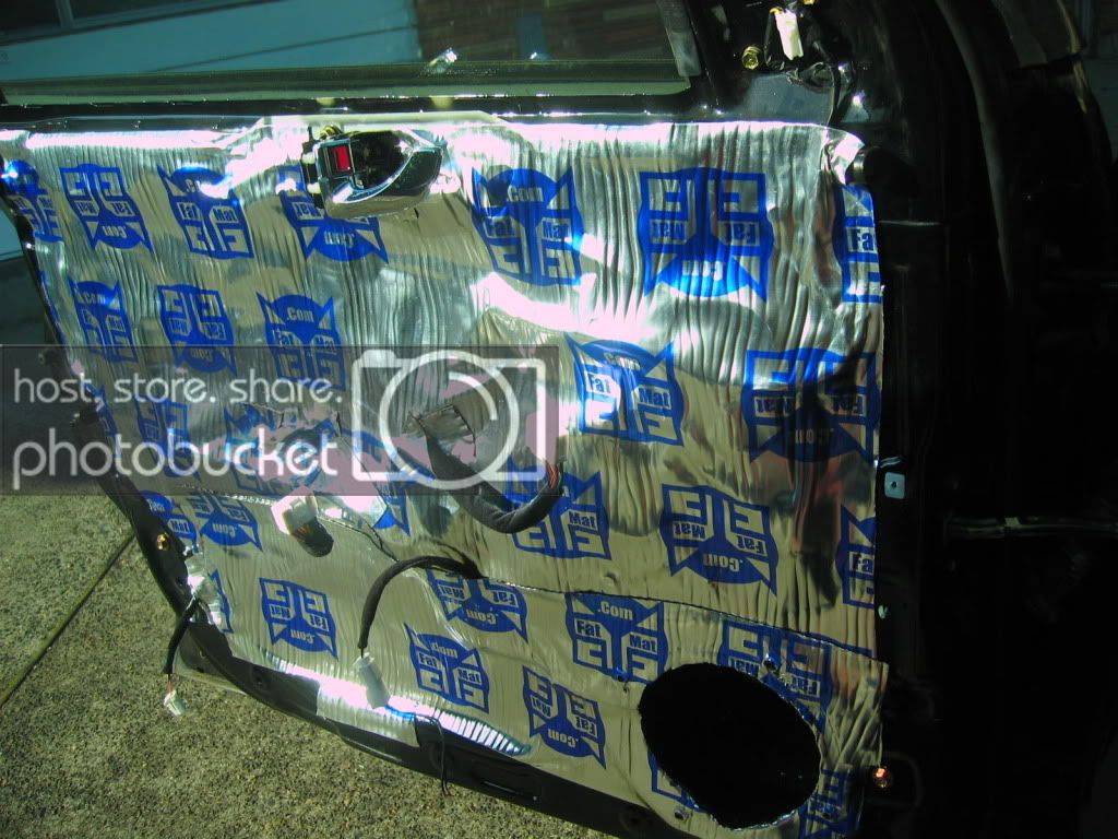

well got some more work on it done, got my kicker kx650.4 in and needed to run some wire soo..

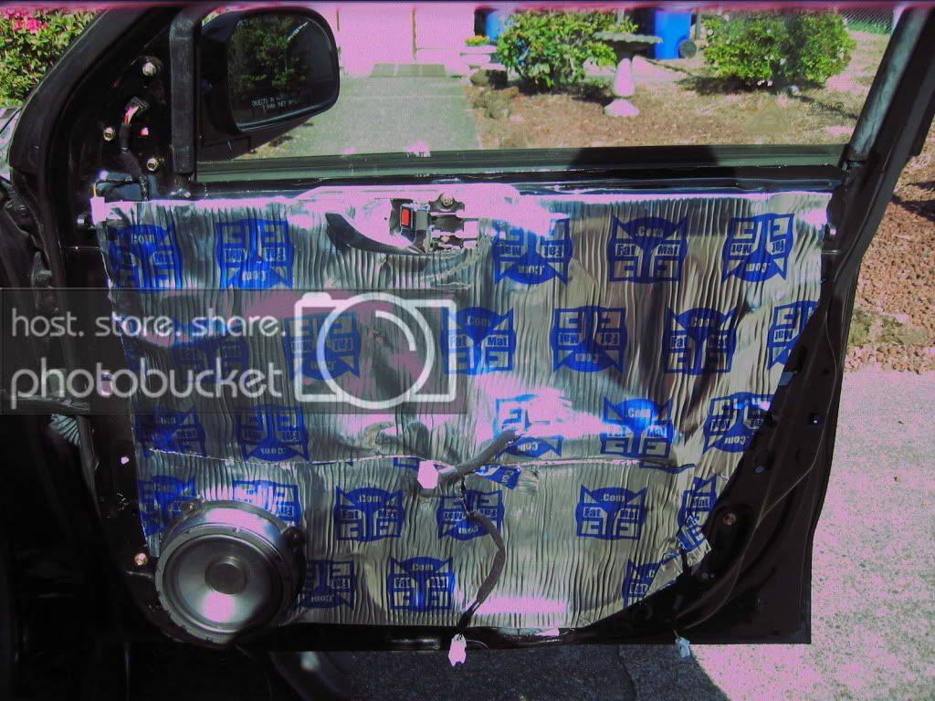

took the panels apart

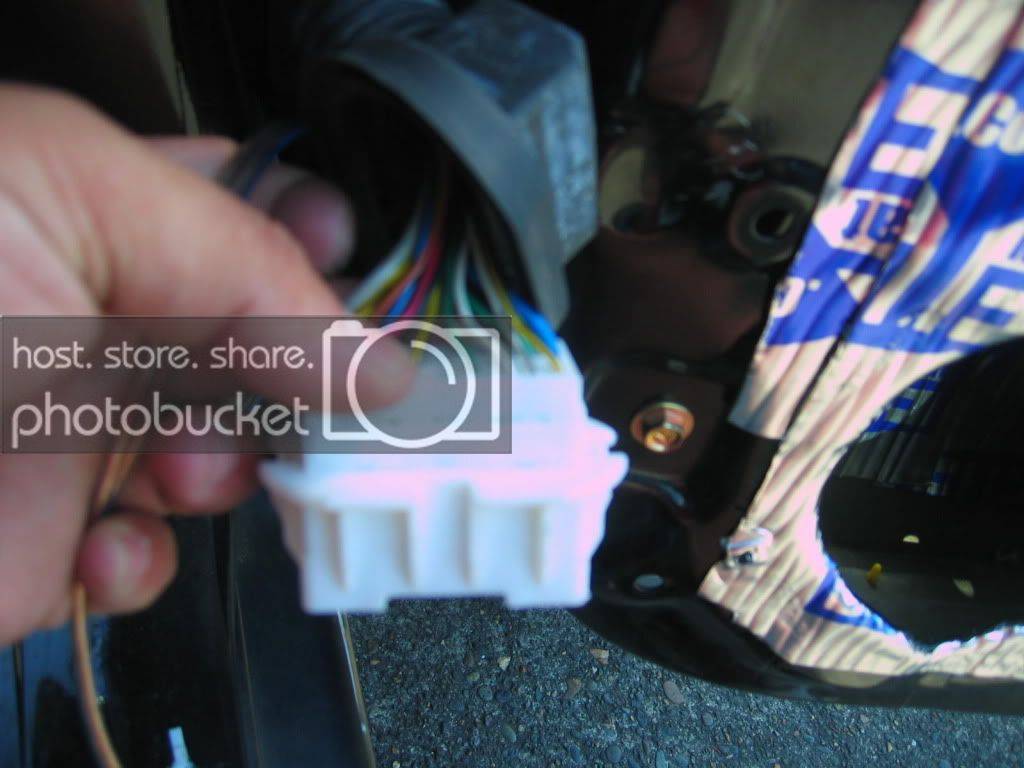

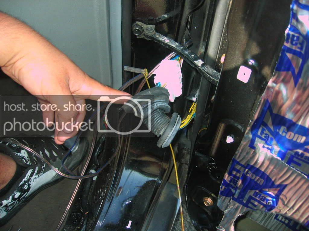

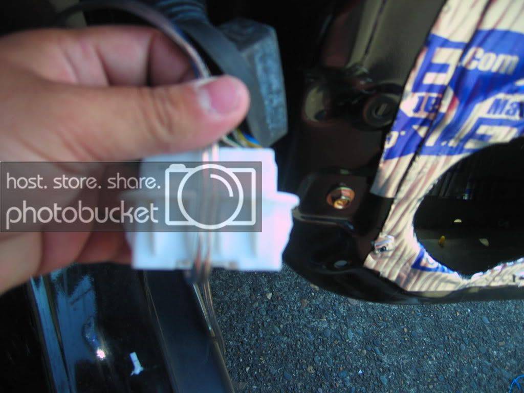

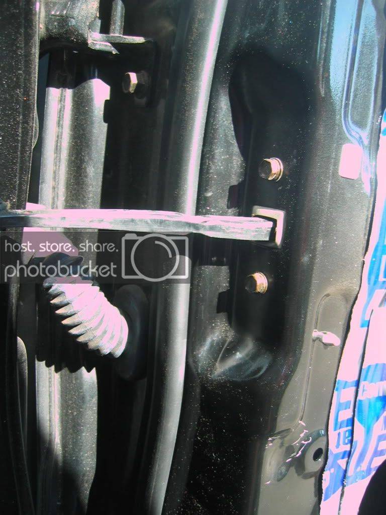

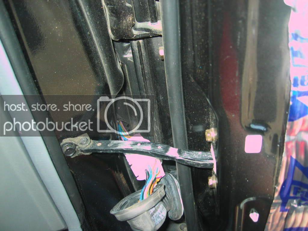

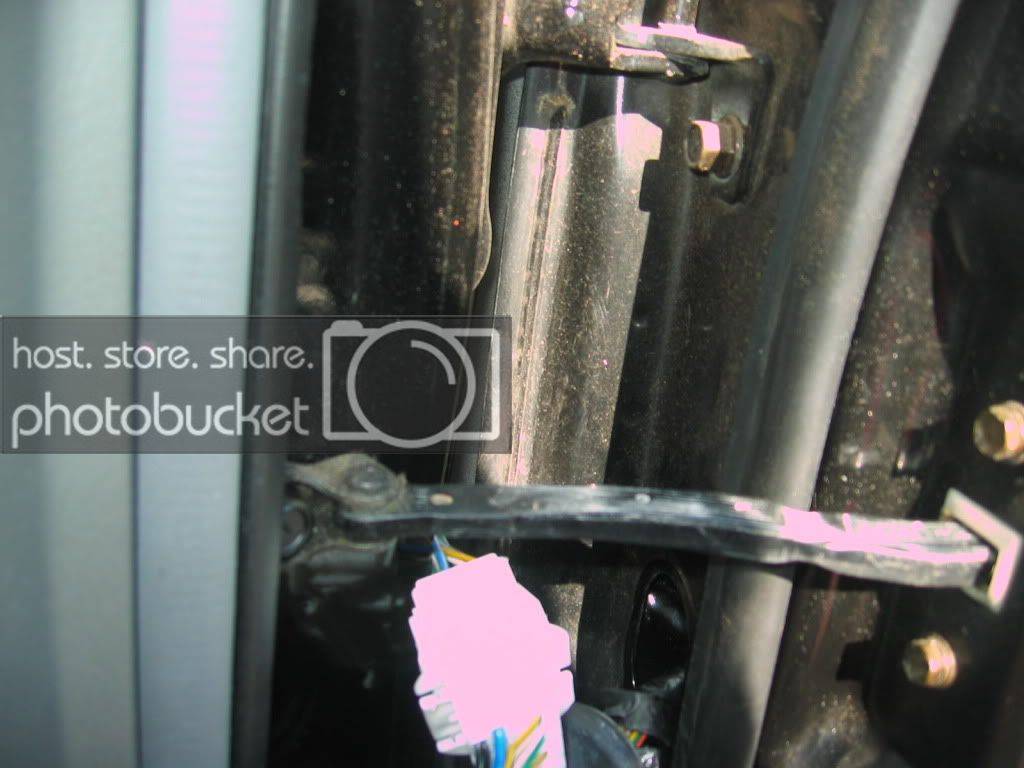

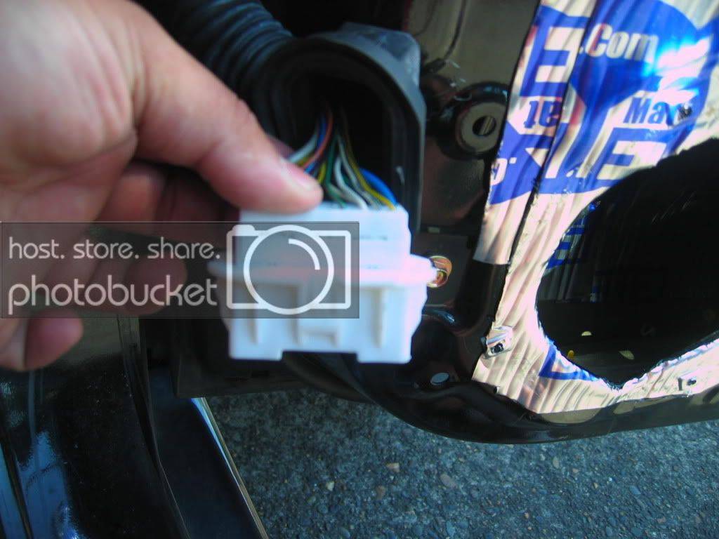

now this thing was a pain in the *** to do because in the doors there is a wire harness connector instead of just wire so hears some pics.
got the rubber off and pulled the clip out of its hole, has 2 tabs that hold it on the top and bottom

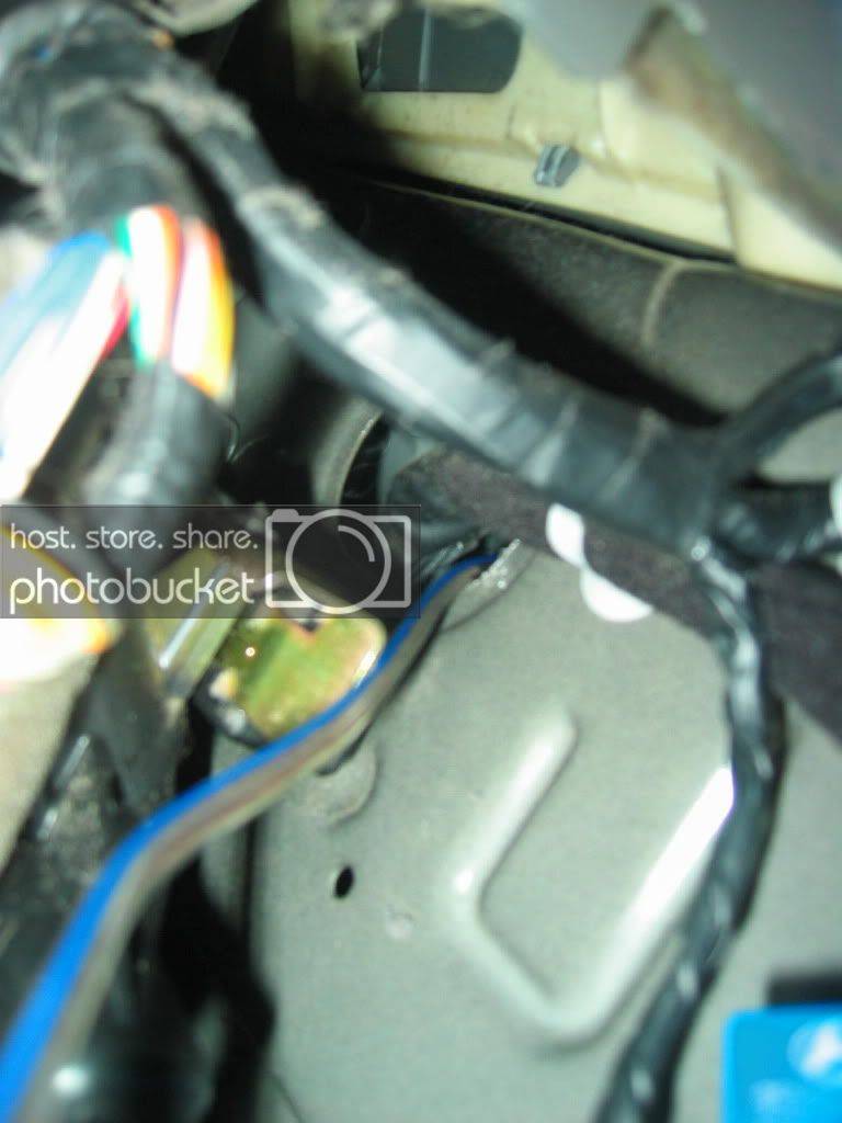

as you can kinda see there is a tab on the inside on the plug so i just cut ot out and ran my wire there
wire run in kick panel..
