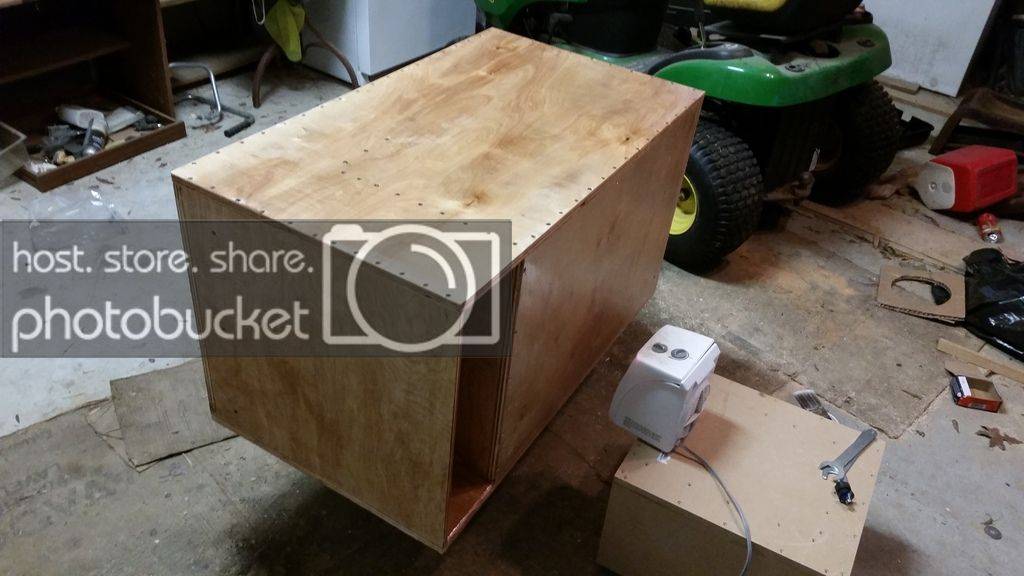

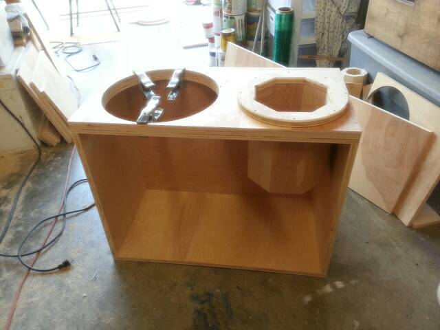

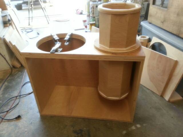

This. Sp4 15, daily tuning is 29. Spl is 45 with a grip of port area. Interchangeable octoports.

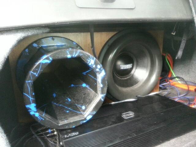

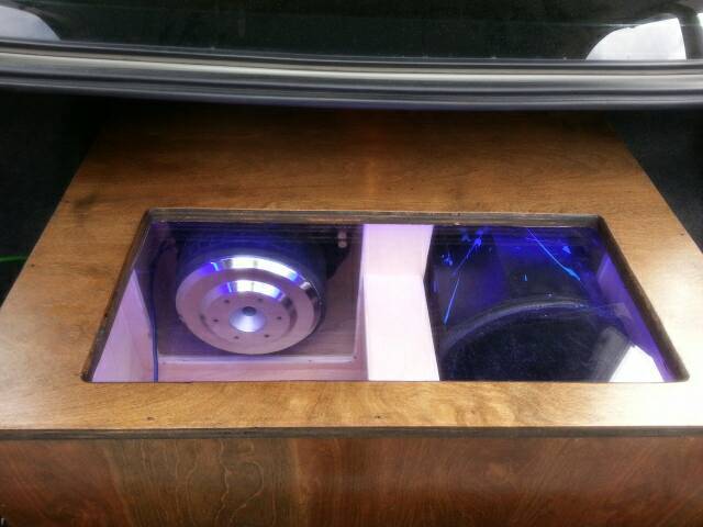

Thank you sir. Here it is completed.
Sent from my SCH-I605 using Tapatalk
//content.invisioncic.com/y282845/emoticons/yumyum.gif.0556df42231b304b9c995aefd13928a8.gif I bet that sounded pretty nasty with that sub! Very nicely done. I love the classy wood look!
After doing a box like that for a local guys like Platform 3 18", I decided to go with that look on a box I made for my old zvx-8. I have custom camo seat covers and was going to cover the panel the sub was on with matching material, but never got around to it.
