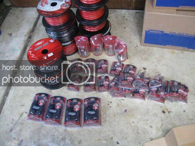

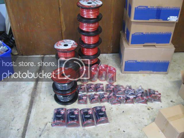

Well my Christmas gift came today from Tsunami, this is about 1/3 of the stuff I ordered.
After 20 mins of unpacking everything I'm left with this, and 20293813 empty boxes.
So what came today was:

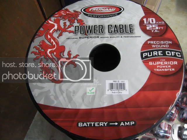

150ft of 0 guage power
50ft of 0 gauge ground

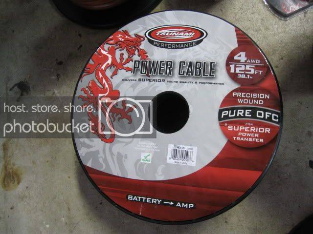

125ft of 4 gauge power
125ft of 4 gauge ground
125ft of 8 gauge

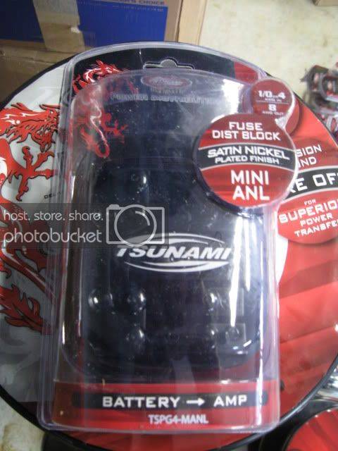

4 distroblocks mini anl
4 distroblocks

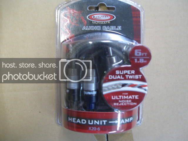

+20 X20 RCA "y" adapters
10 X20 RCA 6ft
Going to give these a try
I thought getting 4 of these would make it easier to get power to the 16 600w amps going in

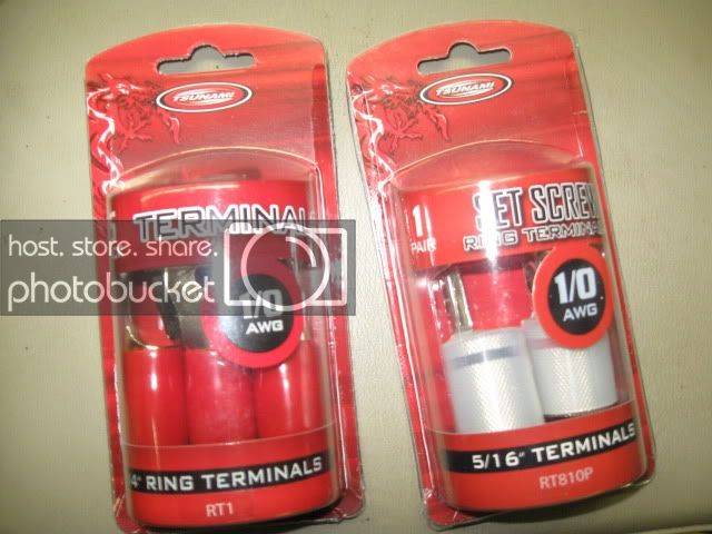

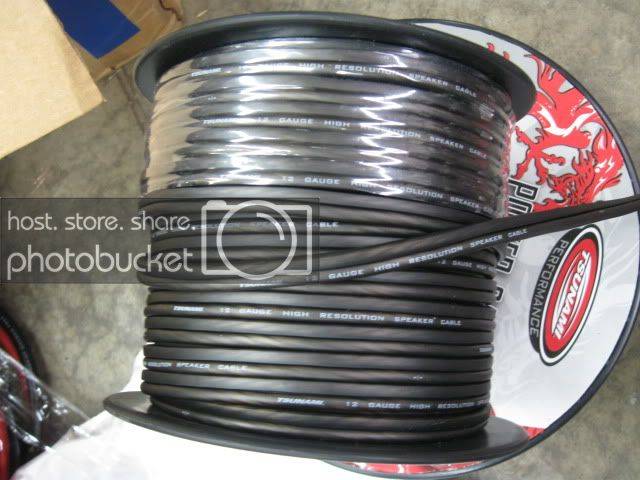

I got a couple other boxes from Tsunami yesterday, mostly ring terminals and 250ft of th speaker wire.
I love getting boxes like this

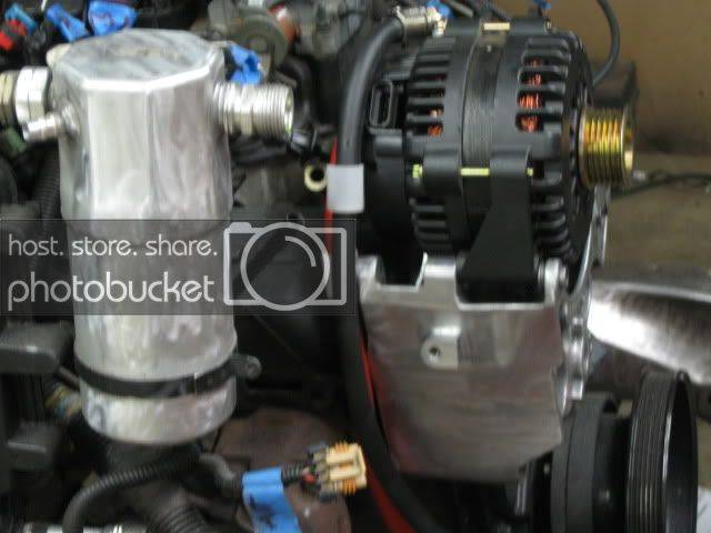

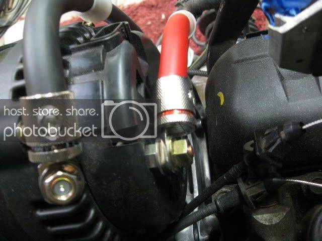

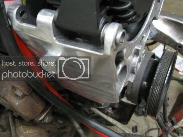

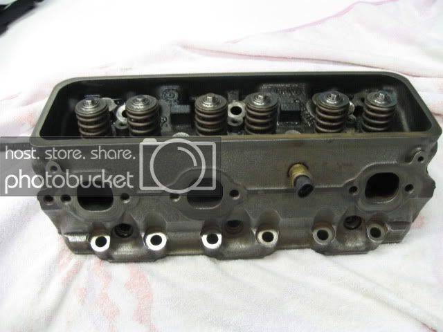

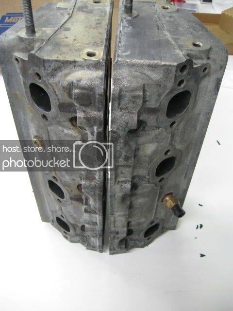

Now here's some pics of what it looks like spot fit on the alts.

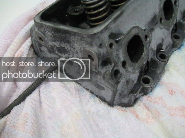

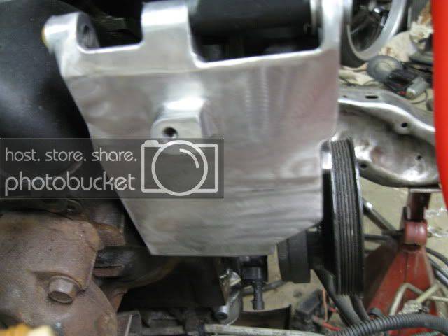

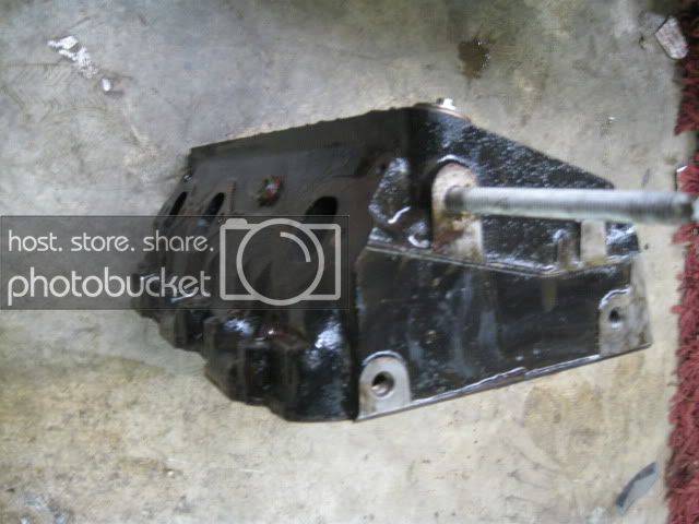

The last couple days I've been resurfacing various parts, the two I'm working on right now are the caste aluminum mounts for the stock alt and the A/C
I didnt take a "before" photo, but this block looked like hell before, and I'm still not done with it yet.

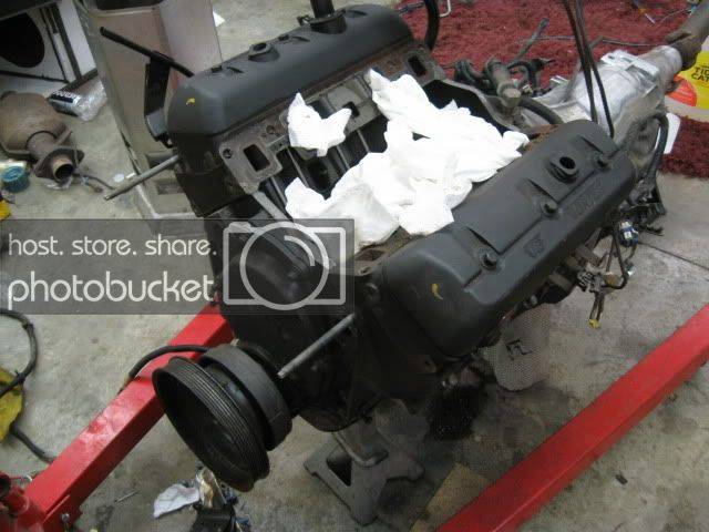

Today the engine is actually being pulled so I can refinish the block and the rest of the frame... yes I'm pulling the engine just to clean everything up lol. The work schedule is that I should have the whole underbody and engine bay sealed and coated by Sunday, and then it's reassembling everything (ugh)

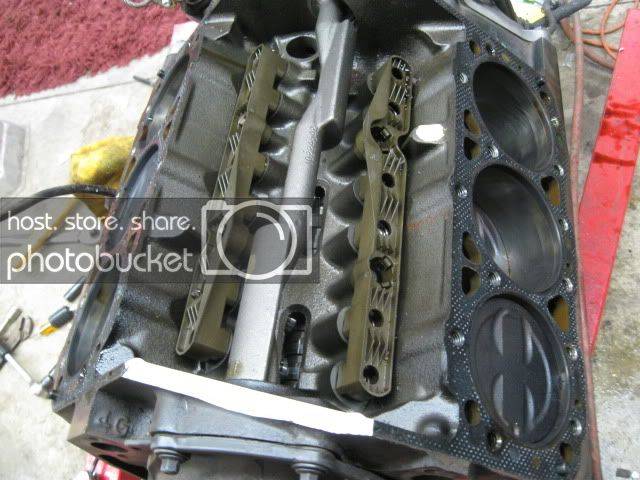

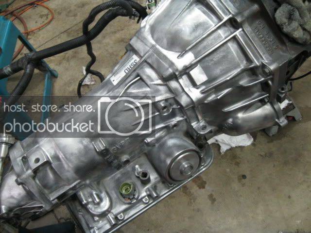

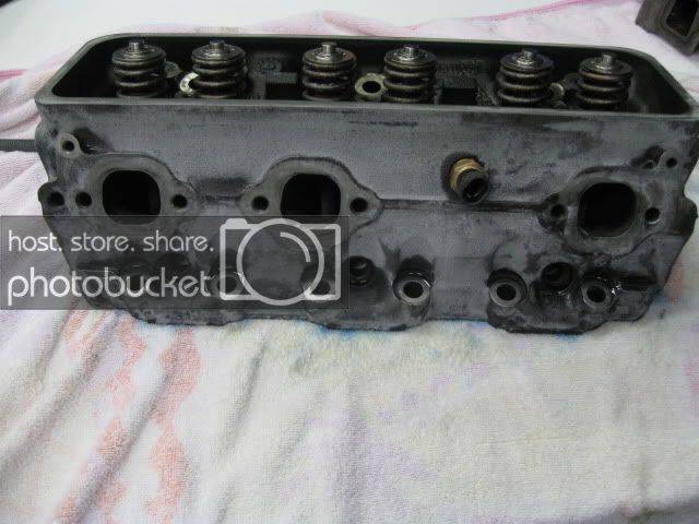

Here's some new pics, I pulled the engine out to do a nice tune up and to paint the frame and underbody as well

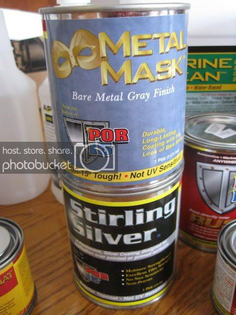

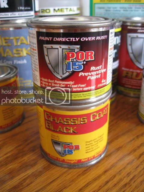

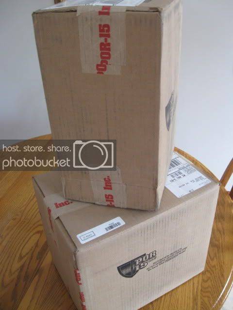

Just got my order of paint today, went way overbudget, but it's totally worth it, I never want to have to do this again, and POR-15 can actually guarantee that.
I'll get into a little more detail in my next post on exactly how to paint with this stuff if you don't already know

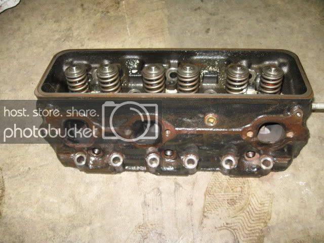

Here's the prep process of what needs to be done before something is painted. It can be VERY time consuming :shrug: but patience is key and in the end totally pays off.
Step 1.
Get your part!
Step 2.
Strip the old paint. For paint stripping, I used POR-15's POR strip. It works very well, but still it's time consuming.
Step 3.
Degrease the part with POR-15's Marine Clean. DON'T use any other degreaser! Other solvents can leave an invisible coating which my cause problems with the paint sticking correctly. But honestly, Marine Clean is the best degreaser I've ever used so I defintely recommend it even if it's not for paint prep.
Step. 4

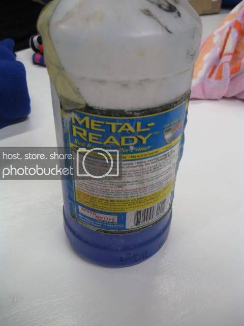

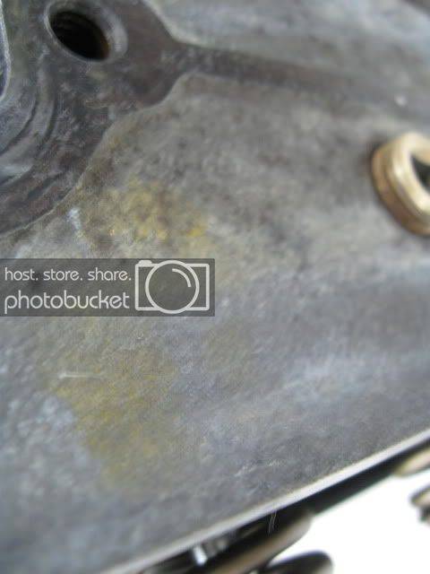

Apply Metal-Ready primer. If painting clean metal you need to apply this. READ Directions! After the part has been rinsed, it will have a grimy goldish hue. This is the best surface for POR-15 to be painted on.
Before the part is rinsed
After rinsing
What the metal looks like now
