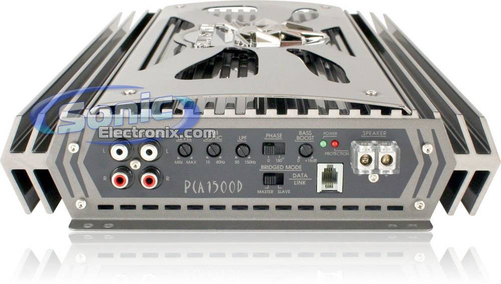

hello all,
the other day i recieved my soundstream amp from this website "www.vminnovations.com" it was refurbished
i connected it to my brand new set of 12" pioneer w308D4,both of the subs set to 4 ohms final impedance
heres the strange part, after i connected everything, i wanted to hear how it sounded so i turned my car on, and had all my amp settings on default low position, i noticed my amp turned on, but my subs were barely moving at all, didint even hear bass
first thing i did was to turn up my HU volume, i have a kenwood MP205, and its maxes at 35, so i put the volume lvl to 20-22, but still sounded like crap, no excursion, so i moved the gain 1/2 up, a little excursion
i know for a fact that theres something wrong, my old 1 12" memphis pr at 4 ohms on a kenwood 1800 watt amp sounded way louder than both 12s but i dont know what it could be
my amp is rated at
800 watts rms at 4 ohms
1100 watts rms at 2 ohms
1500 watts rms at 1 ohm
i even tried changing the ohms of my subs and had both subs at 1 ohm, i know its to much power for my subs since both subs are rated at 400 watts rms each, but i needed to see what the problem was, so i did it and turned my amp up at 1/2 gain and the exurcusion went up a little had my volume lvl at 25 but still my subs didint blow or clip, so im guessin that my amp isint producing much power, because if it did, those subs woulda been toast
i bought 4 gauge wires from ebay, dont think thats the problem
i know my HU is rated at 2v at the pre-out
i did the big 3
and just yesterday morning i turned my car on to troubleshoot again, and for some reason i think the amp blew, or something because i noticed that the power light on my amp just turned off outa nowhere and i checked fuses onboard the amp and under the hood, all look good. so now my amp doesnt come on, and i just got it
anyone please help, i dont know what it coulda been, if you need more info on my setup please ask me and ill tell you
sounds like you turned your high pass filter all the way down to the lowest frequency cut off so its cutting everything out, but that really doesnt matter if you say the amp isnt even turning on.
lvl was at the 1/2 position
subsonic filter was at the default 15 hz setting
LPF was at the default 50 Hz setting
bass boost at 0 because i heard that if i increase this, it will decrease the life of my amp
i sent my amp back to vminovations, hopefully they will exchange my amp for a better condition one
i just dont know what it coulda been, i resetted my deck to default settings, and still my subs seemed underpowerd
is there a way to measure the amount of power that goes from the car battery to the amp? maybe my ebay 4 gauge wires isint producing enough power to my amp
should i purchase a Oscilloscope or a DMM to measure the current going or comming from my amp?
any feed apreciated thanks again you guys

LPF at 50 will keep a LOT of subwoofer material from reaching the sub. 80 is the usual rule of thumb.
With the ISF at 15 and the LPF at 50 you basically turned it into a bandpass sub with a bandwidth of 35hz

you tell us, when you get it working right. turn up that filter like we asked and go from there. we arent giving you advice that we think will make you waste your time, we are trying to help
i'd also turn up your boost a tad, i understand that everyone hates bass boost, but a little aint gonna hurt nut'n //content.invisioncic.com/y282845/emoticons/wink.gif.608e3ea05f1a9f98611af0861652f8fb.gif
Leave the bass boost at 0, you don't need it and it only distorts what the bass actually should be
Set the LPF all the way up (at 150hz) just for testing purposes. If it solves your problem, then adjust it where you like it, if your still not getting any decent output, then your problem is elsewhere.
