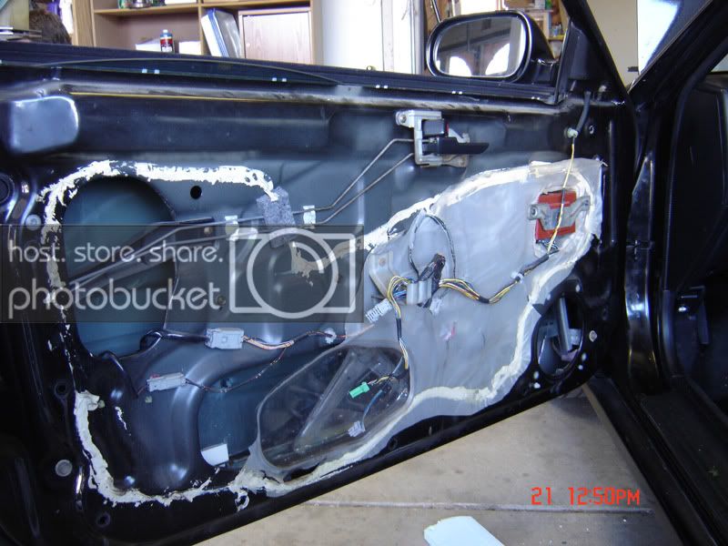

Sooooo, how do you Dynamat doors like this?
KooK
I mean, do you just put it up against the shell (outside) of the door, do you slab it everywhere you can, I've never dynamatted before and I have no clue how to. All I know is it actually looks tricky in places like this. I'm guessing with the type of adhesive they use, it would probably be best to use a heat-gun to apply it with? So should I just slab it everywhere though?
Wipe it all down to remove dirt and grease. Then I would hit the door skins with a layer or two. Then do the outside of the doors. Covering all the holes will help "seal " the doors. It will tighten up the sound of drivers mounted in the doors. //content.invisioncic.com/y282845/emoticons/smile.gif.1ebc41e1811405b213edfc4622c41e27.gif
