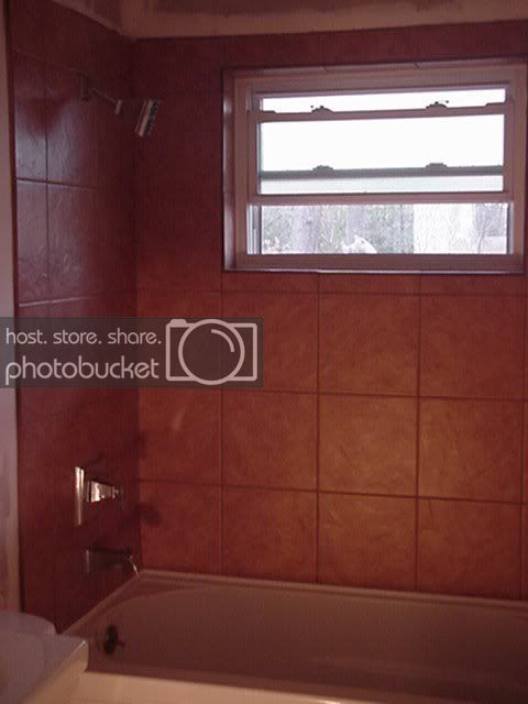

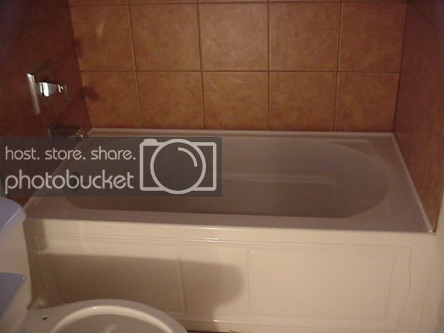

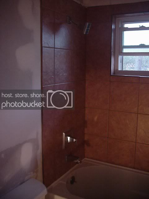

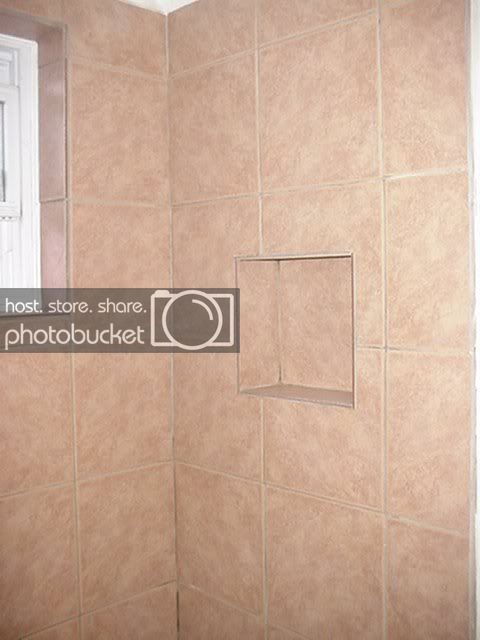

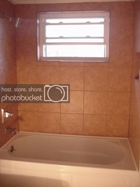

Im starting to take some pics of the stuff i do at work. Ill add as i finish jobs. Heres a bathroom i finished. Reframed it, built a new subfloor, added hardybacker, sheetrock on the walls, put finishing on the sheetrock(homeowner is painting it), put the tub in, all the fixtures for the tub/shower, and put in tile. Here are a couple pics i took.

Interesting . Why no bull nose around what I'm assuming is a soap / shampoo shelf ? //content.invisioncic.com/y282845/emoticons/smile.gif.1ebc41e1811405b213edfc4622c41e27.gif
i do tile work for a living. i notice that you didn't use any bullnose or trim pieces. are you saying that the tile work is a $5000 job? if so, i call bs
no im saying the whole job is a $5000 job. she just wanted 45 degree grouts on the outer-edge. She likes it the way it is, so i left it like that.
you mean on the floor? 45* lay-ins are usually more in labor due to having to cut/trim more pieces. looks nice, given the lack or trim units. there should be bullnose at the top (if it doesnt touch the ceiling) and on the front edge down to the tub. not to mention there are pre-made soap dishes you can buy. also bullnose around the window.

i did 45 degree grouts on top to. Then she is going to use a straightedge to paint right next to them on the side and top. Can someone show me a pic of all the trim pieces you are talkin about. as i said this is only the 3rd time ive done tile and was the first time i have done a wall and box. So i could use the help for future refrences.
