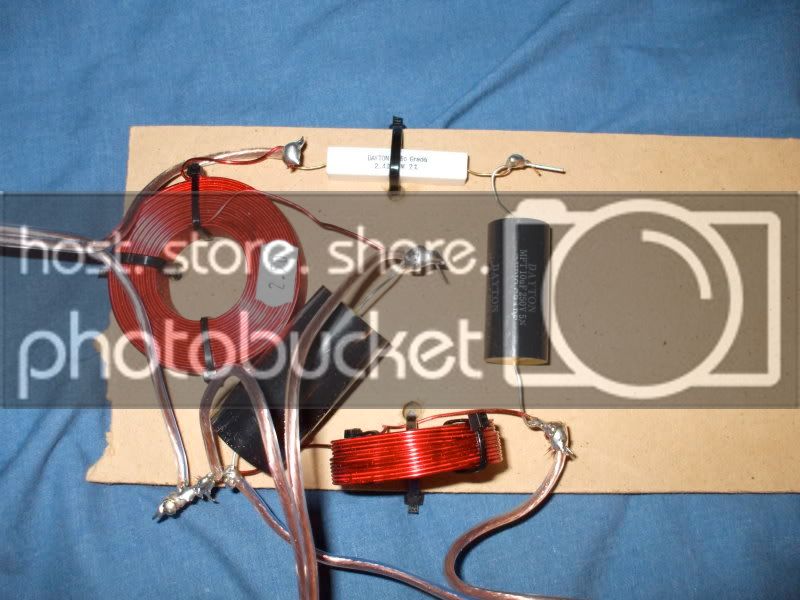

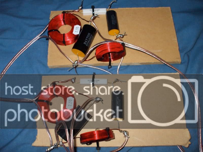

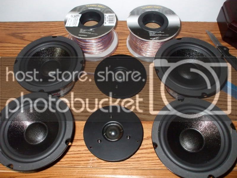

Some Dayton drivers and 100 ft of speaker wire For my Tritrix towers. Just got done building my first crossover, took me about an hour from start to finish. Hopefully I did them right. I'm cutting the wood for the towers tomorrow.

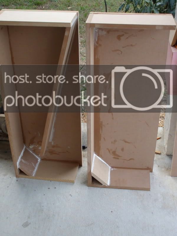

I took some 3/4" MDF, put it vertically, and tapped a screwdriver with a sledgehammer to split the MDF in half to make some 3/8" MDF. Then I just zip-tied a few of the components, and will silicone the rest when I pick up some silicone from HD tomorrow. I'm also going to trim the excess MDF off the sides.

It sucks when you only have enough clamps to glue one piece at a time. Along with doing all of my cuts without a table saw, it makes for a long and tedious process to build boxes.

I used those same 5.25" drivers to build these. They sound awesome for a low cost mid!
Nice, I wish I had the cash to spend $500 on mids.
Honestly, crossovers look more intimidating then they really are. My first crossover was wayyy easier to build than my first box. I'm not gonna be getting these done any time soon because I don't have any router bits and I'm going to be heading back to college in a couple days.

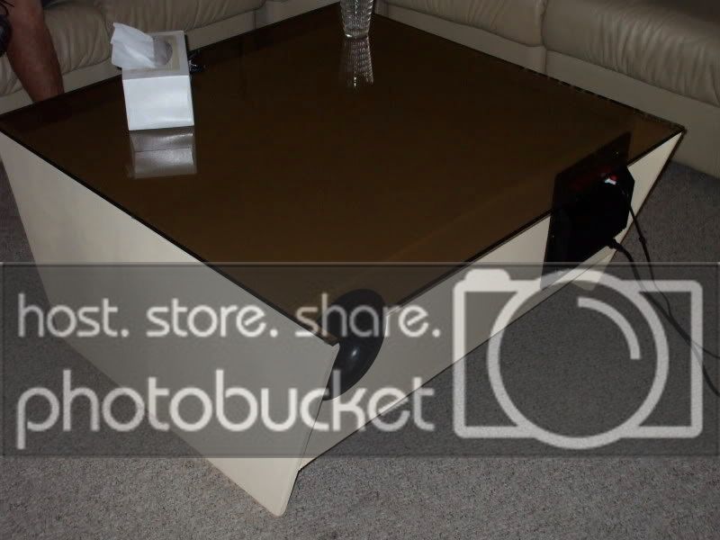

Primed/painted (it's light-yellow) the table to match the room. 5.5 cubes tuned to 17 hz with a 4" aero, houses a 15" JBL GTO on a 270 watt plate amp. The camera seems to show some imperfections in the paint but in person it looks flawless.
All I got done today //content.invisioncic.com/y282845/emoticons/frown.gif.a3531fa0534503350665a1e957861287.gif I'm a slow worker.
