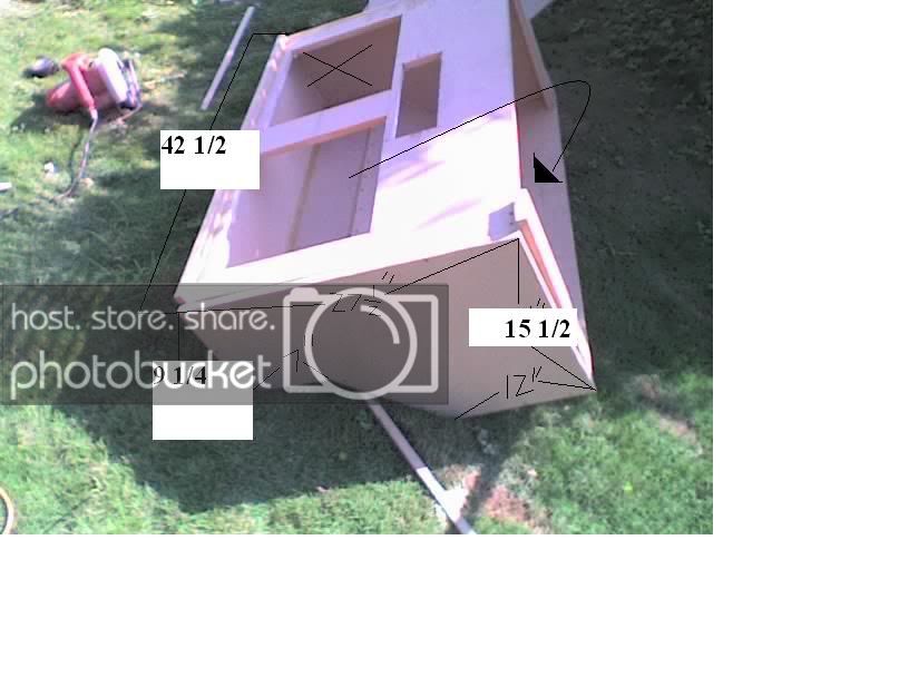

my orginial box. my sub blew. sold the body. now there's only 1 solo X left to play with. i want to break this in HALF. tune to 40hz.
according to the kicker specs per sub
6 ft3 (170L) + port displacement FB 45 HZ
port: 60 in2 (387cm2) area x 6x(15.2cm)long
power handling 2000 watt peak
im used to this site to buildin my box but it wont do my dimension.
http://www.reaudio.com/speaker_box/LPort_Box_Calc.html
help?
option A. ok so trace one side duplicate it twice and then you have your ends
figure out the sq in of that end and multiply it by diff depths untill desired cubes can be reached / now you have you overall dimentions ( remember to go bigger than desired to account for port/sub daiplacement
tune to desired freq
option B. pm me and i'll cut you a design
