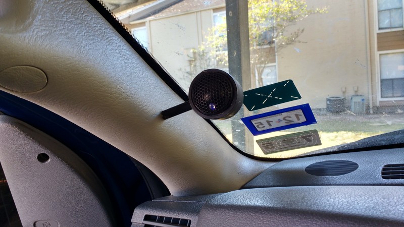

pvc endcaps are less than 3 dollars, use them and a hollow bolt to mount on your A pillar. Every easy to do.

I used the PVC method and love mine, didnt require a ton of modding. Just needed to glue the cap to the tube and paint them, then put a hole in my pillar. Whole thing including paint was maybe 12-14 bucks and hour or two of work.
