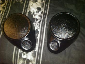

I infamous_e46 5,000+ posts hArRy_DaNgLeRs 26,366 257 California Oct 2, 2010 #1 i heard you cant glass plastic Click to read more...
OP I infamous_e46 5,000+ posts hArRy_DaNgLeRs 26,366 257 California Oct 2, 2010 Thread Starter #2 //content.invisioncic.com/y282845/emoticons/frown.gif.a3531fa0534503350665a1e957861287.gif
subzero 5,000+ posts CarAudio.com Veteran 6,940 135 Chandler, AZ Oct 2, 2010 #3 trash em? you can glass plastic. just drill holes and shit. give it a rough surface.
helotaxi 5,000+ posts Kilroy was Here 8,961 73 South Central (New Mexico that is...) Oct 2, 2010 #4 Use epoxy resin instead of polyester. Rough the surface up with some sandpaper.
