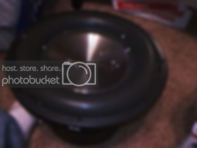

So got my eclipse today....
brmcm15
Oh lawdy!
88120 TI - D3, well really a D4
so thinking some where around 2-2.5 cu ft. @ 32hz off of ~800w rms
what do you guys think?

but working on the box design now, any ideas?
Keep an eye on that surround because this can happen
It got to the point where the tinsels leads were CUTTING the two spiders due to high excursion. I was pouring 1000 watts RMS to each though, maybe more.
Patch any cracks with liquid electrical tape as soon as you see it or it'll just get bigger and bigger.
