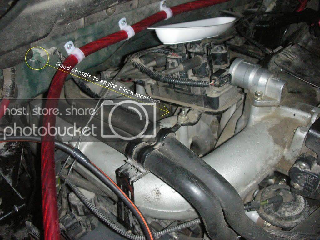

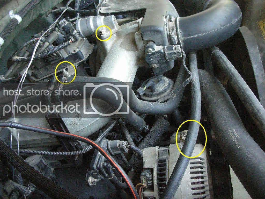

Trepkos 10+ year member CarAudio.com Elite 709 0 Mississippi Jun 16, 2008 #1 Which is the best engine block location for the chassis to engine block? Also how is this for a chassis location? Click to read more...

Johnny Drama 5,000+ posts Banned 21,345 126 Dramaville Jun 16, 2008 #2 Which is the best engine block location for the chassis to engine block? Also how is this for a chassis location? Click to expand... If you're doing the "big 3" there should be a stock location that the battery grounds to. Find it and use it. If you simply can not find one, find an existing mount somewhere on the frame to use.

audioarsonal 10+ year member JaMarcus 4,260 0 close to home... Jun 16, 2008 #3 If you can't find one,number 3 would be my choice.
J jrwalte 10+ year member CarAudio.com Elite 986 0 GA Jun 16, 2008 #4 #3 is my choice, too. That chassis location would work, but see if you can find one closer to #3. The shorter the length the better.

skittlesRgood 10+ year member CarAudio.com Elite 1,147 0 fremont, ca Jun 16, 2008 #5 why not just go straight to the battery -?
