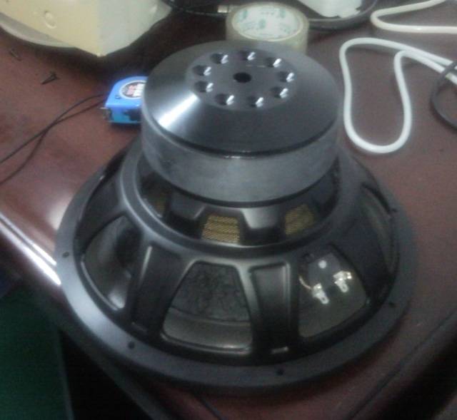

I am not planning an 8" for this line any time soon... but I am planning 10s, 12s, and 15s... also... I do not have an ETA just yet, first prototypes are on the way then testing will be in order for a while to make sure the design suits all of my requirements.
Just though I would offer a sneak peak of the 15" model.
I AM planning to use spring loaded push terminals on production... I don't like the spade connectors.
Some T/S Specs measured on the Klippel machine at the factory... I will measure them myself as well once my prototypes arrive.

high Q on that 15, sealed box only?
One would imagine... but I've found that there are ALOT of high Q subs that people love to port.
DD 1508, DD 2515, etc... have both of these in here @ the shop at they are both just below the 0.8 Qts range.
I will be testing them thoroughly, though, and if I don't like the sound that I'm hearing I will adjust as necessary.
i like the basket for a stamped steel,nice cooling on it.
copper coil?
spider?
CCAW coil -- cooling is excellent //content.invisioncic.com/y282845/emoticons/smile.gif.1ebc41e1811405b213edfc4622c41e27.gif
Spider size is somewhere in my notes... it's a big one for a 2" coil, let me check the exact size.
