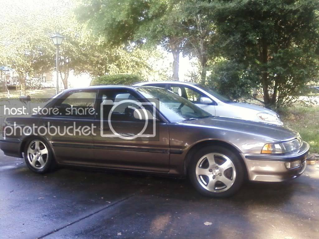

Bought the car a few months back then sold the problematic CR-X.
Goodbye :teary:
Hello new project (soon to be hotness) de-honda boy'n it as I go along too much ghetto rigged ish as you'll see further along
