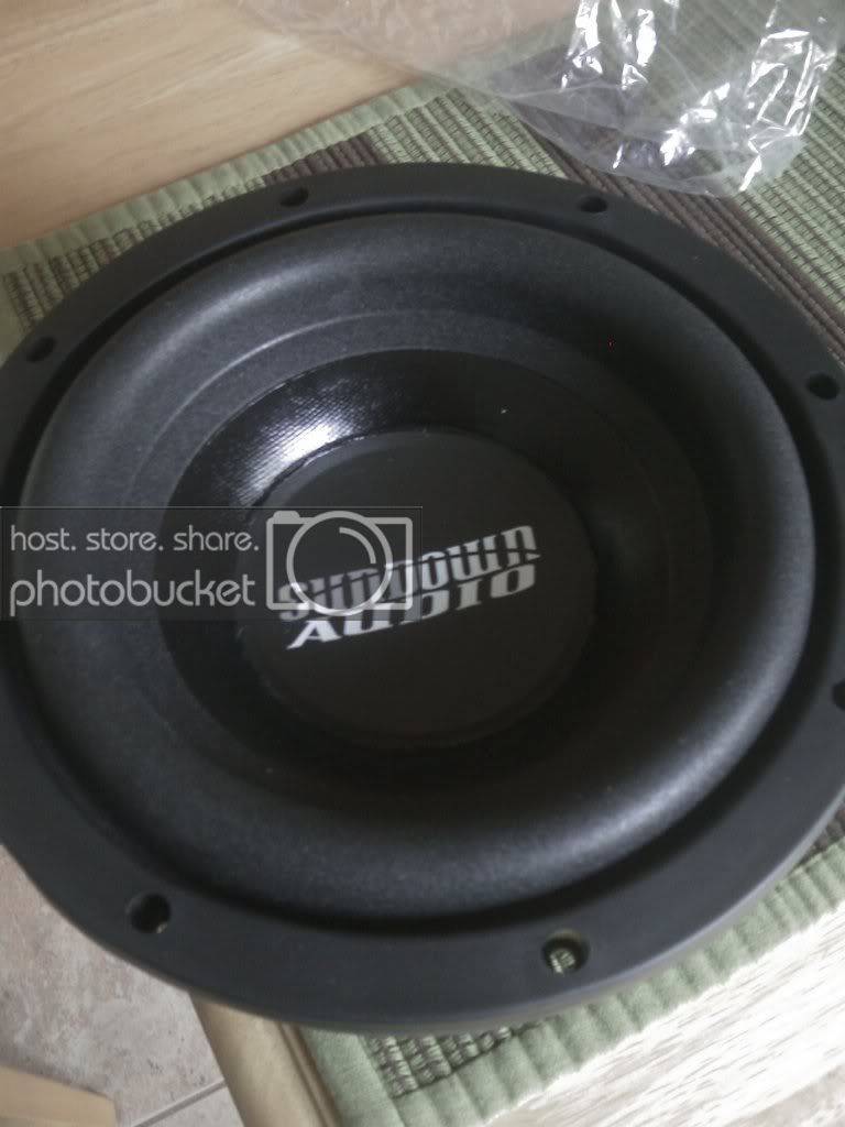

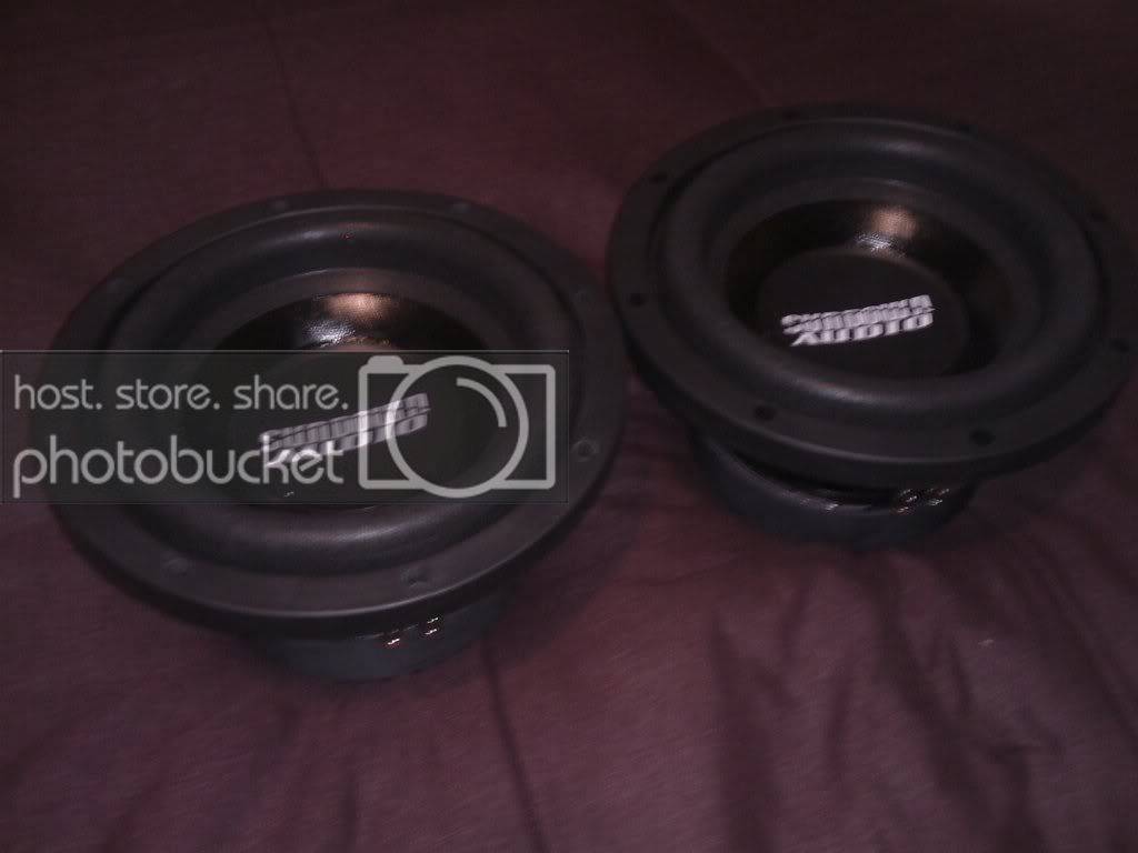

Two E8s
1.6 cu ft. @ 32 hz

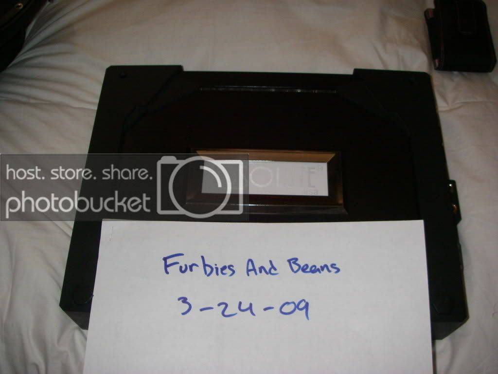

Absolute EVD-2200 @ 2 ohms ~600w

Here's the last picture i took of the amp

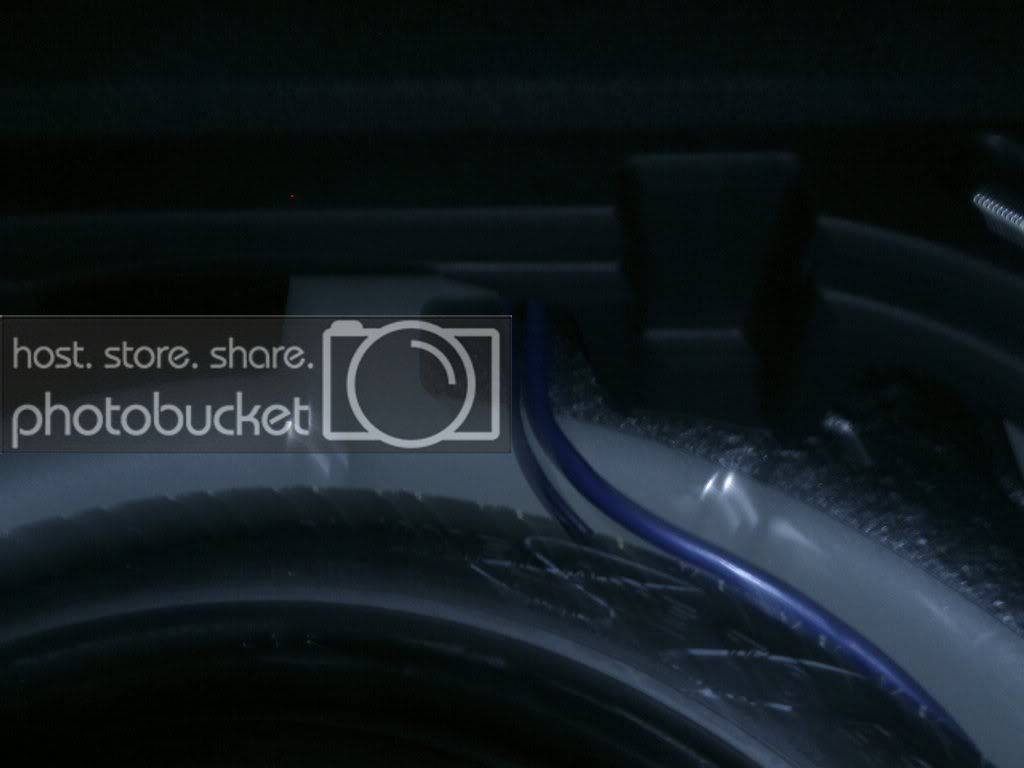

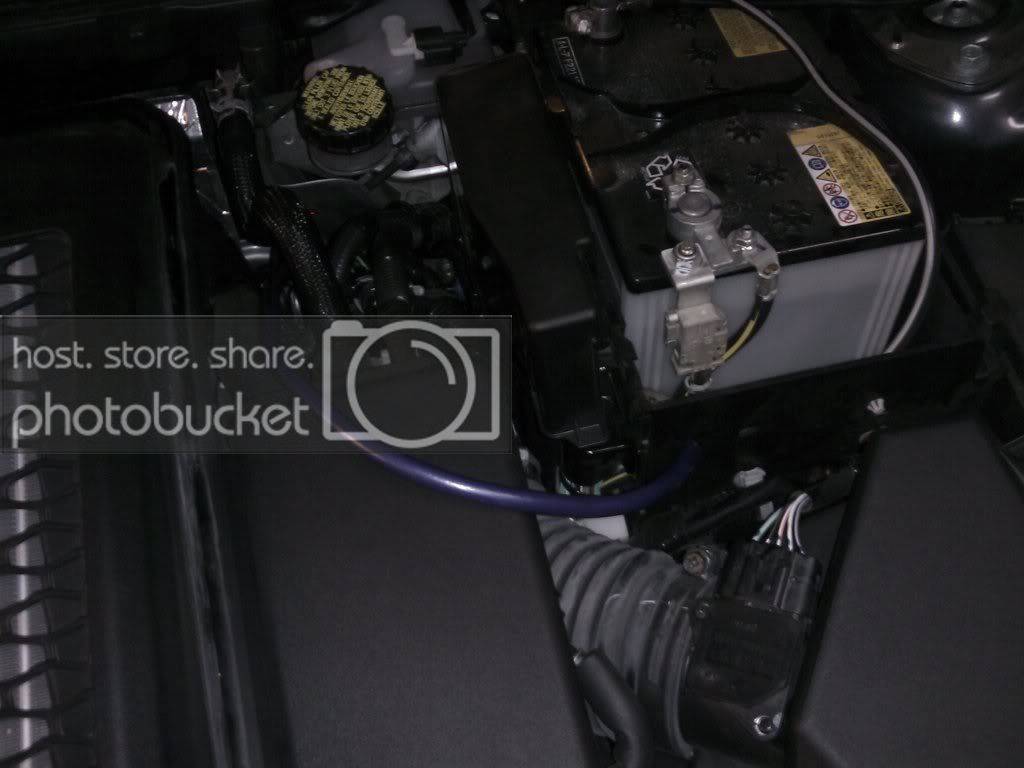

Power Wire run
This has been split loomed and going to install the fuse holder later

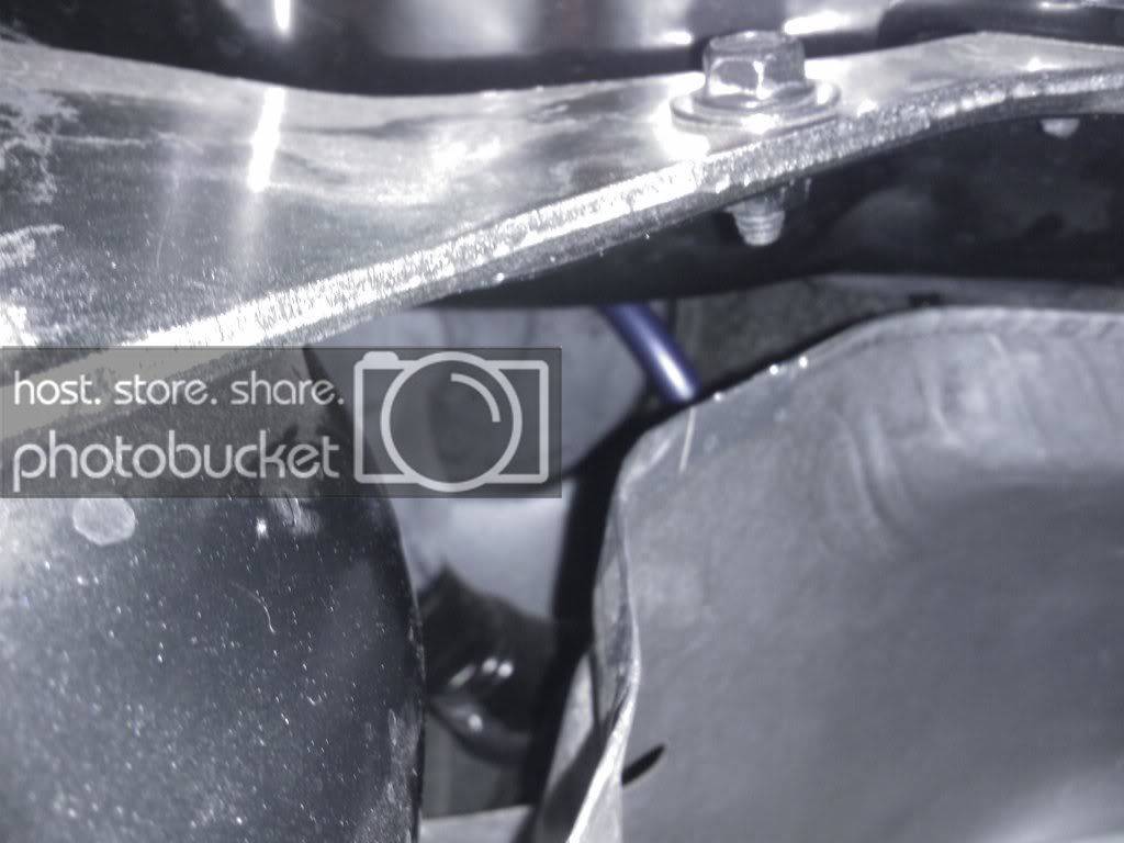

The grommet for the firewall
All the way in the trunk

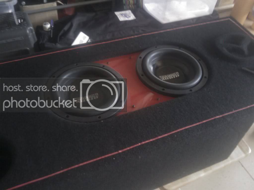

Finished installing everything //content.invisioncic.com/y282845/emoticons/smile.gif.1ebc41e1811405b213edfc4622c41e27.gif

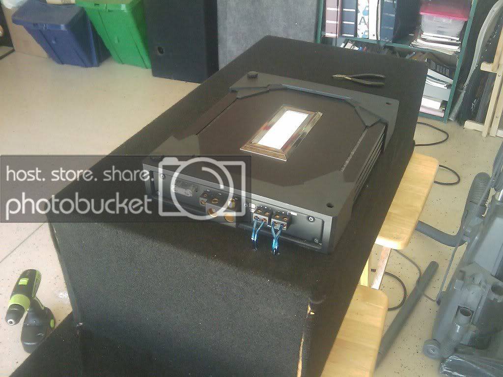

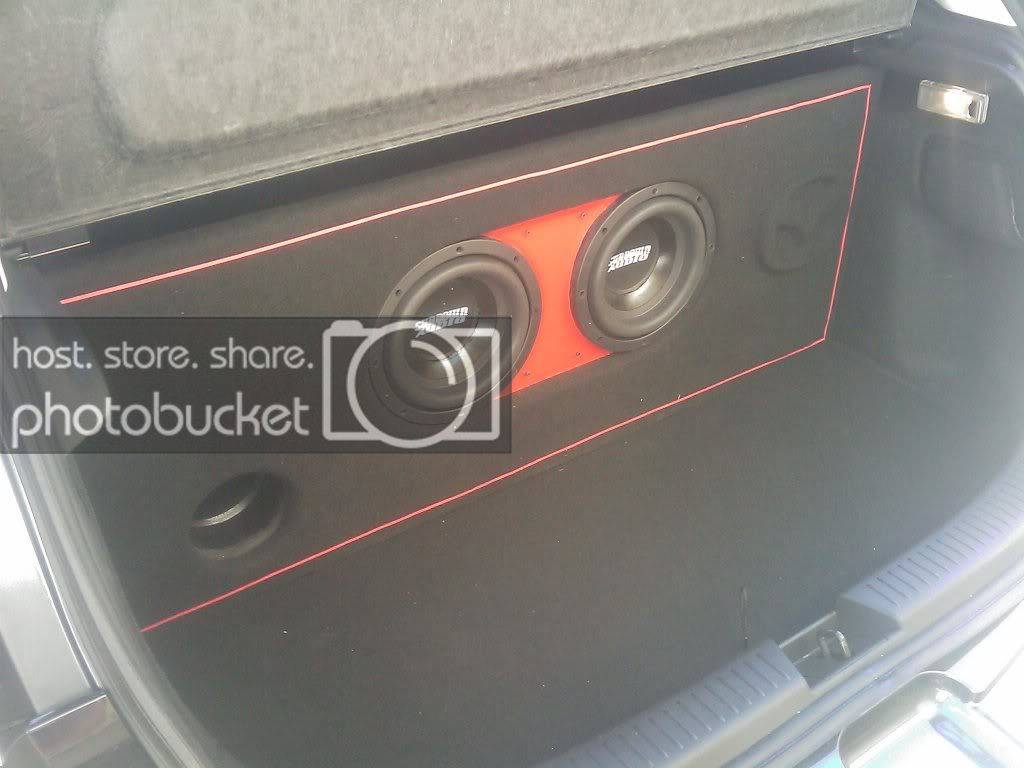

I messed up the box d_man1 made for me cuz i touched the paint while it was still dry. I sanded it and instead of repainting, I cut a piece of acrylic to size and painted the back side of that red. I also added the red strip around the box just to make it stand out more.
I attached the amp to the back of it and drilled holes by the speakers terminal to hook them up
And here it is in my car, fits like a glove and looks amazing //content.invisioncic.com/y282845/emoticons/biggrin.gif.d71a5d36fcbab170f2364c9f2e3946cb.gif pictures really dont do it justice.

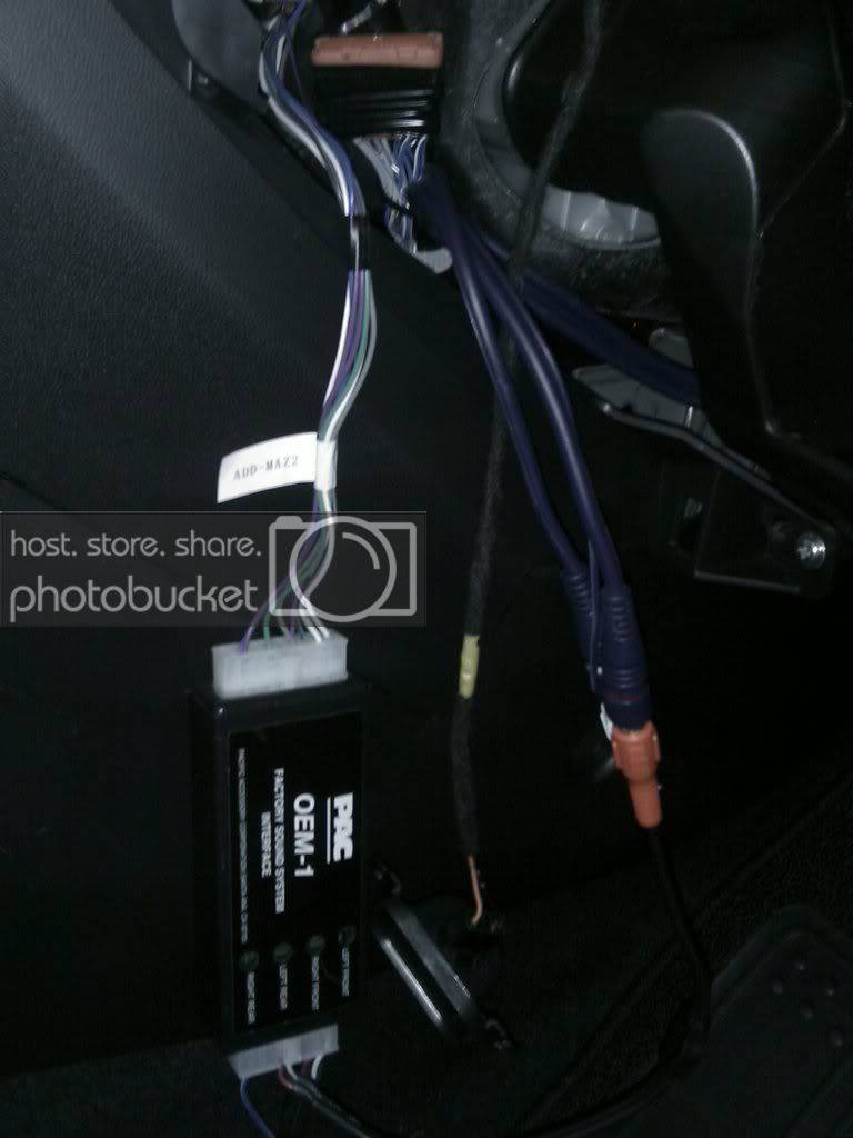

Nice. I am curious how you got the PAC OEM1 to the kick panel. I have a 2010 MS3 and put my PAC in last week, and the wires arent long enough to reach that far.
it's not the kick panel. It's the plastic to the right of the stereo. And this PAC is the one that connects right into the factory wiring, no need to splice anything. Im not sure if the one i have fits 2010 or if they've made one for the 2010 yet.
I have the same exact PAC, no change to 2010. ALready installed and working perfect. To the right of my stereo is the glove box and no where to put it. Darn.
