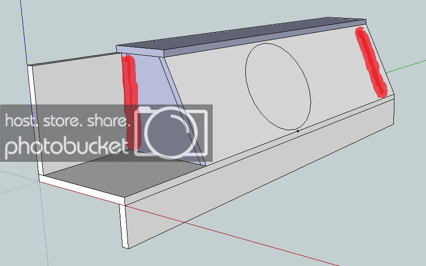

This is the setup that will be in my Ranger
With that setup, the sub is in the middle, the box is oriented to the drivers side, and it leaves a space on the passenger side to rack the amps, in this case I'm going to be using an Alpine MRP-M1000 (already have it) and an MRP-F300.
What I'm wondering is with a slot port, does the slot have to blow to a full open space? In the pic above, I marked 2 areas with red. The one on the left would blow out behind the amps, the one on the right would blow out towards the edge of the driver seat. Would it be muffled if it blew towards the seat?
Would I be better off with a round port in my case?
ive always heard port aimed at the drivers' side panel gives the best output. and you generally want at least a port width of clearance. i aim for about 1.5X port width of clearance(more if im talking home theater with tuning below 25hz)

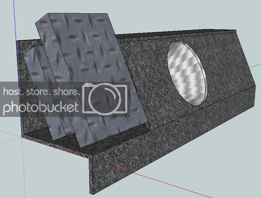

Ok, a buddy of mine spent some time helping me learn Sketchup, so I was able to finish the model of the box.
Box is modeled with the Kicker CVR 12" I have now (which has similar ported box specs to the Sundown SA-12 that I want later), the Alpine MRP-M1000 I have, and the Alpine MRP-F300 I plan to buy to run the front stage.
With this setup, would I be better with a slot port out by the amps, or a round port through the top?
Port at the bottom would run into the sub. Also trying not to move the amps upwards, because then they start to get visible through the back window. I guess I should mention that stealth is a little bit of a goal here. The sub will have a dark grill over it to minimize visibility from the front, and with the current design the box is pretty much invisible. I'm starting to think a round port might be my only options in this truck. If I only had an extended cab lol
