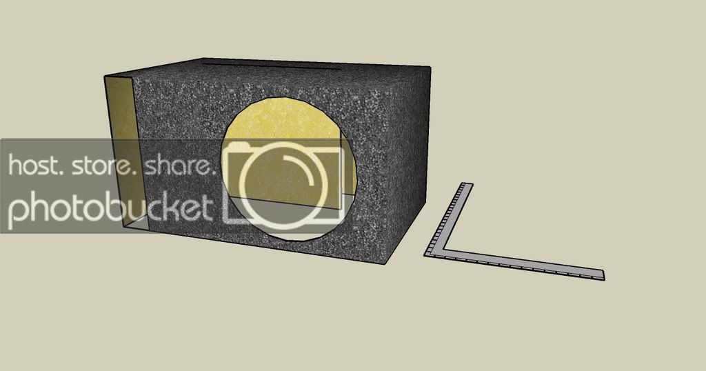

what would you guys says is the minimum width of a slot port without losin performance? 1 inch? 2 inches
if i wanna tune my box to 32hz with the dimensions i want it calls for 1 inch wide port opening, but i can change dimensions if that isnt big enough
With the dimensions I used, it had 20.5 square inches of port. Maximum height is 14 externally, so 12.5 internal. I guess I will try to figure around some more with the width and depth cause I want the port facing up along with the sub. That may have to change tho idk.
The dimensions I had were height=22 depth=22 height=12.5
basically would look similar to this
Internal dimensions..
Height=13
Width=23.5
Depth=16.5
Port..
Width=2.5
Height=13
Length of first board=18
Length of second board=12.5
Is this box close to 2CuFt at 32Hz?
