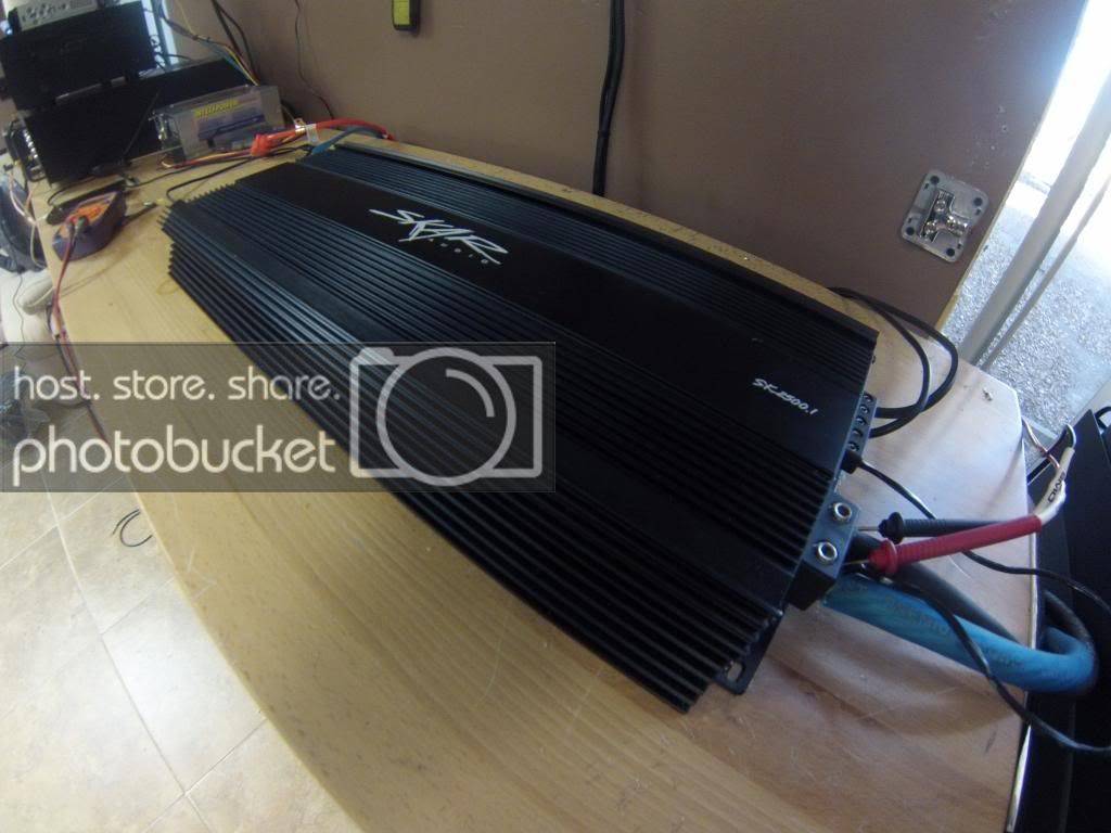

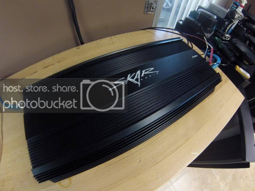

After much demand we have finally gotten around to putting the Skar Audio SK-2500.1D on our test bench and the Dyno Results are in...

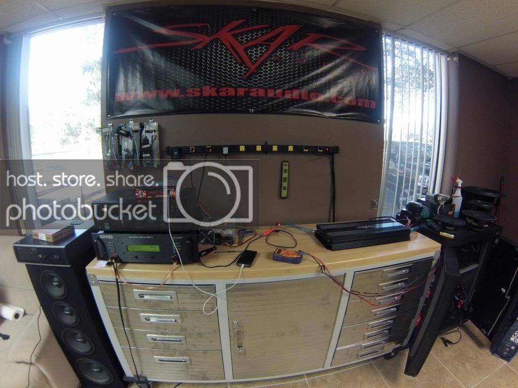

We used (4) Shuriken 16V Batteries for testing and this was a non-charging load. The purpose of using the 16V batteries is so that after the heavy draw from the amplifier during the testing, we get real power ratings at that 14.4v~ load as you will see in this video.
The SK-2500.1D proved to stand up to its ratings and then some =)

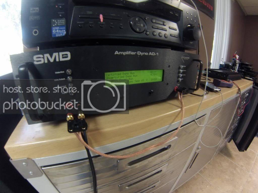

Dyno : SMD AD-1 Amp Dyno
