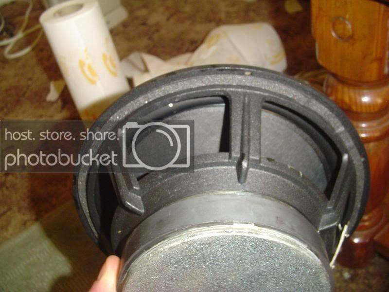

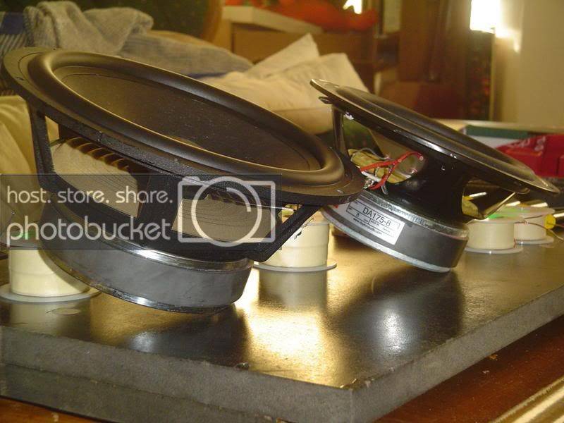

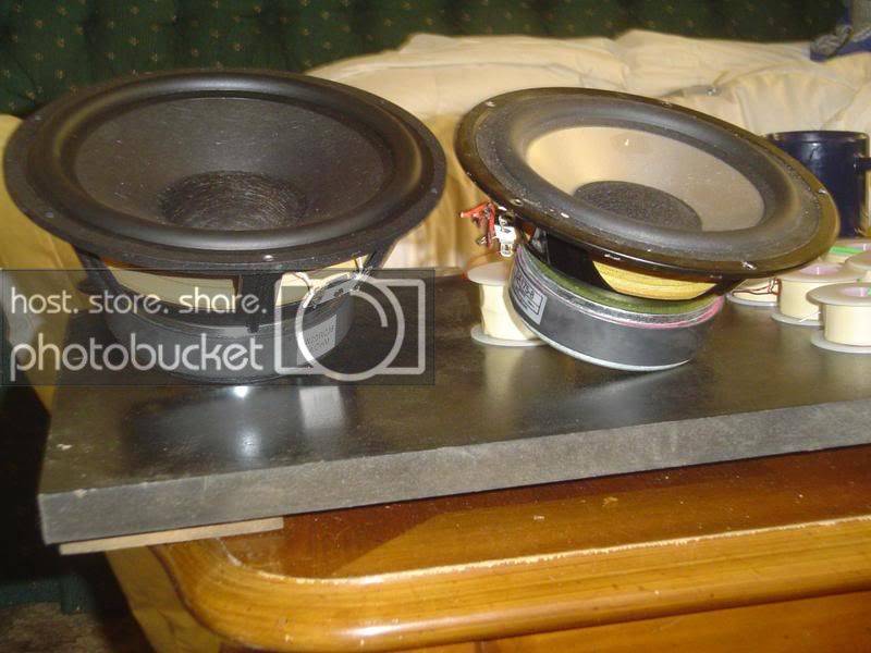

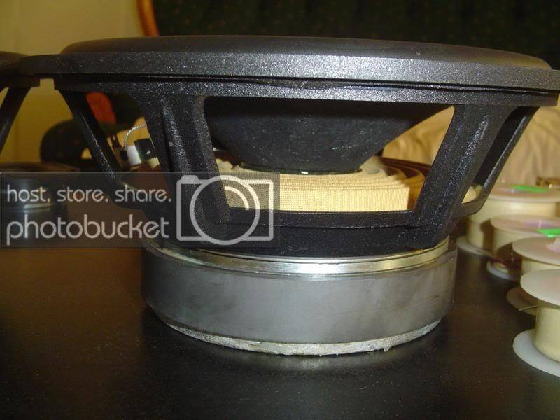

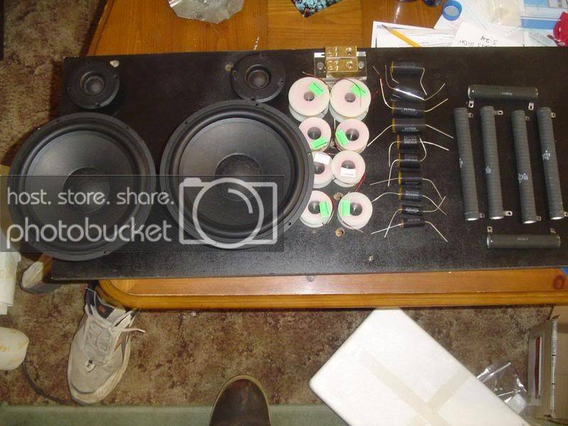

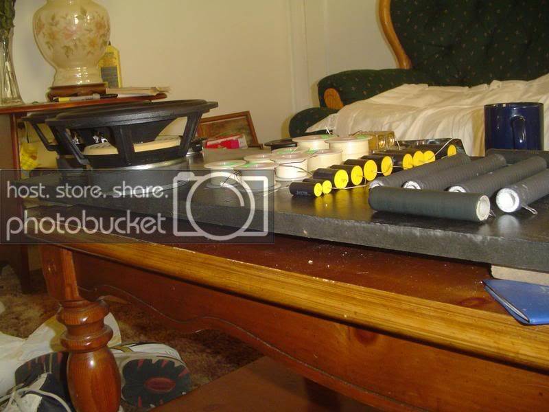

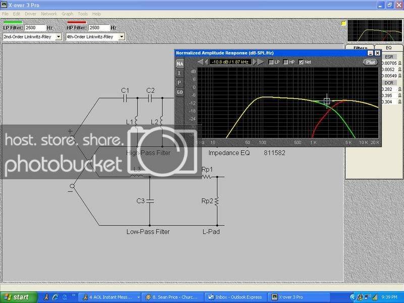

Hey all, I'm just getting prepped for a build here
I will be utilizing a pair of Silver Flute W20RC38-4's and a pair of Peerless 811582's
Passives will be using Dayton Poly caps, Madisound 18 and 19g air core inductors, and some heavy Dale/Vishay resistors.
The Silver Flutes will be housed in a 15 liter birch enclosure, tuned to 50hz, flush mounted. The tweeters will be flush mounted also.
Crossovers consist of 2nd order Linkwitz Riley on the LPF side, and a 4th order Linkwitz Riley on the HPF side. Both at 2500 hz.
The woofer has an L-pad, and the tweeter has impedance equalization (Zobel)
Paired next to a Dayton DA175 7" aluminum cone midrange
Happy Family
Midrange closeups
Predicted Response
Just figured I'd share this with you folks
