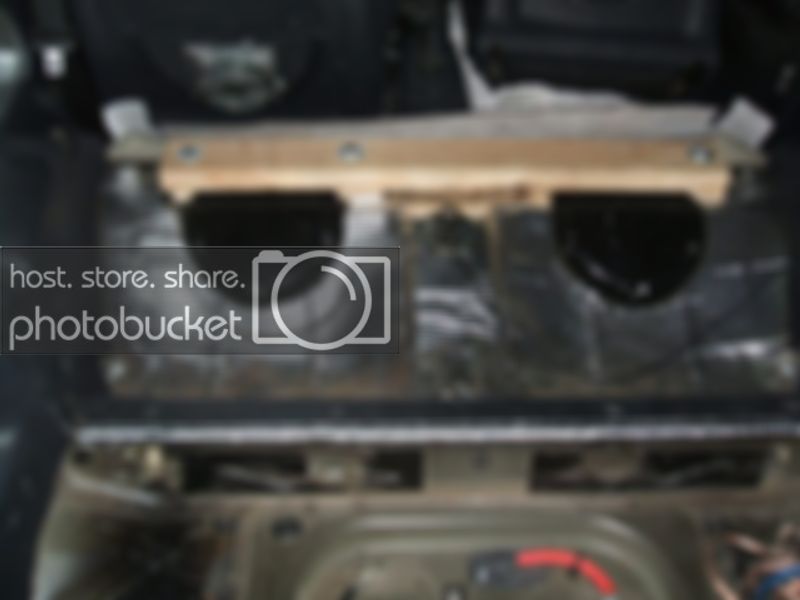

first i put the 2x4 on the front to level it with where the box would sit on that back piece (dont mind the ghetto cuts i made on the metal lol)
just so happened that to get it level with that back metal piece, it took a piece of 3/4" birch, and a 2x4, and that leveled it perfectly.
bolted it in.

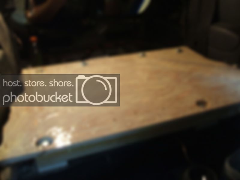

then i put in the actual floor for the box to sit on. i cut out the holes in the floor so it would sit flush over those 3 bolts in the 2x4, and i bolted it down in the rear.
then i put one more layer, covering right over the front bolts, and cutting holes for the last layer to flush mount the rear 4 bolts, so the box has a 100% smooth surface to sit on.

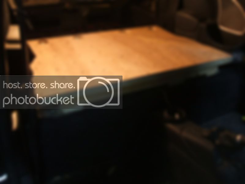

from there, i built the box (the box had a floor as well, so overall, the total bottom of the whole thing is 3 layers thick of 3/4" birch)
the box itself overhangs that false floor as well, by about 3" up front, and 3" in the back.
