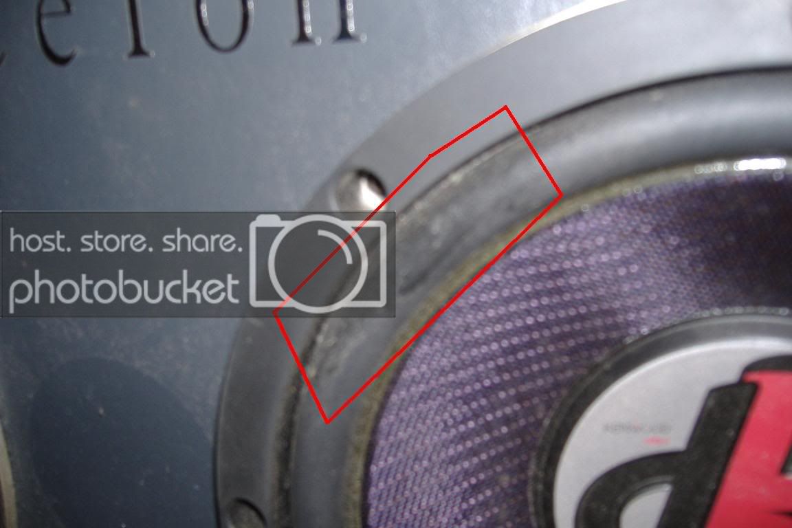

No, No, No, No.
Let me reiterate that ~ NO.
If silicone sealant was detrimental to rubber speaker surrounds (I cannot speak to its effects on foam surrounds) then doing this would have been a really bad idea:
See the area enclosed by the red line. The idiot that I had helping me put these 10s in their box made a slip-up and while trying to sink the mounting screws screwed up and ended up punching a very small hole in the surround of that sub. I coated that section of the surround with a thin layer of silicone sealant to make sure that very small hole did not become a larger one.
That was about three years ago now.
No adverse effects as of yet so I would assume there aren't going to be any.
Thanks I heard people do that before is why I asked cause i thought it was ok but my buddy said it would eat the surround.
The mids are orion P6.2's and they have the rubber surround so I am good to go.

x10 thats what I am talking about I have done the same thing it wont hert shi!t to put silicone on a speaker at all.

Well, the hole in my 10 was made the very first day I owned them before they ever saw the first watt of power coursing through the coil. I banged on 'em pretty hard for close to a year and a half before I bought the Diamond M6 12" that I run now.
Those 10s are now in my bedroom as part of an uber-ghetto setup and still playing strong. //content.invisioncic.com/y282845/emoticons/smile.gif.1ebc41e1811405b213edfc4622c41e27.gif
