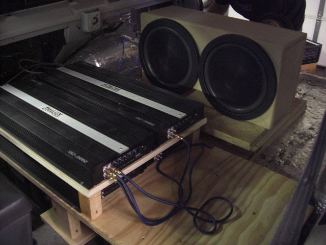

Si bm mkiii 12" spl fun!

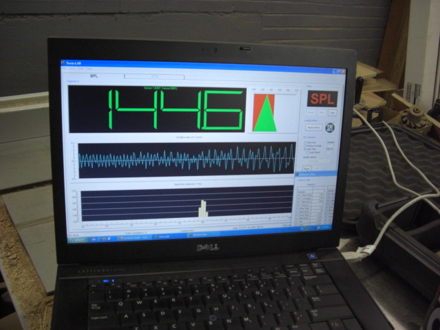

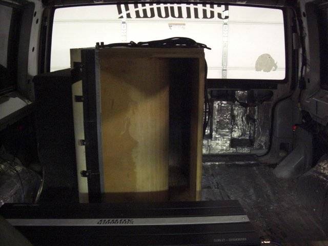

Pics of the loudest box position (we tried like 20 ways) and the score :
Video Uploading now...
That's cool, its fun to see what you can get out of subs that aren't supposed to get loud. Cherokees are great SPL rigs too...

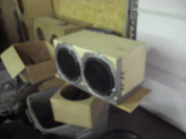

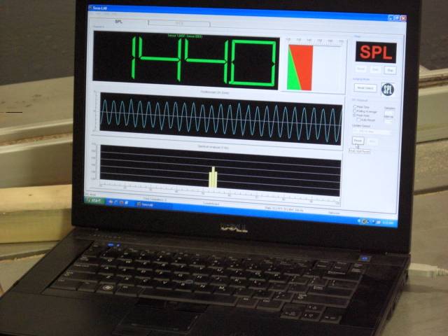

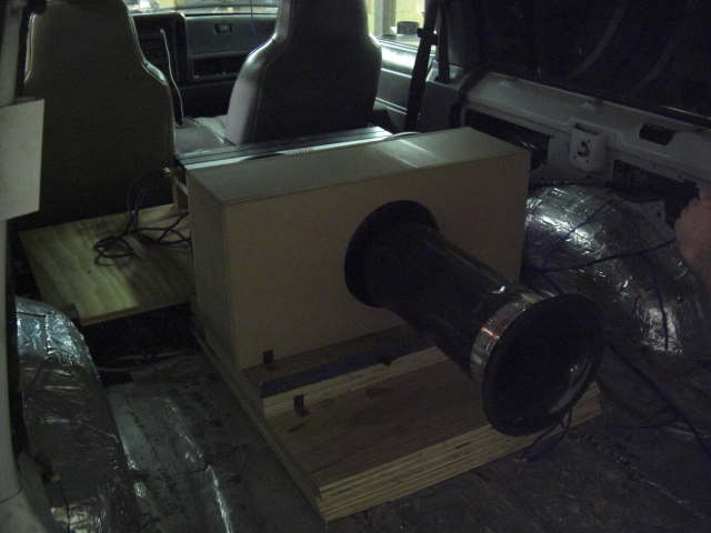

First we made a REALLY small ported box... but the tuning was too high and extended the port messed up the phase relationship...
Not much better than the single woofer at it's best so we quit on this box.

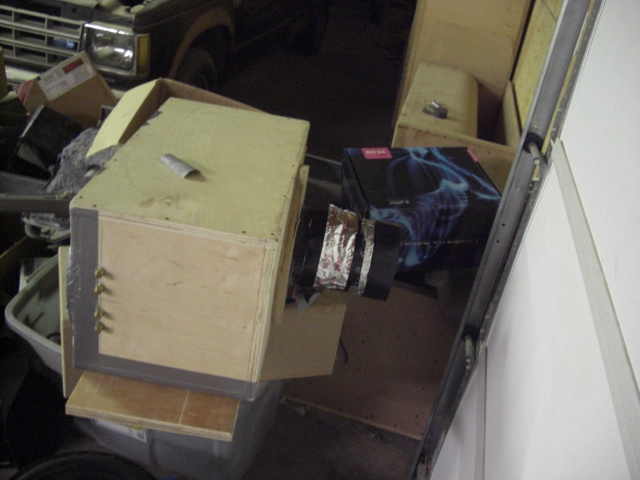

So... we modified one of my dual 8" woofer boxes to hold two 12s -- about 75% larger than the first :
I forgot to take pictures yesterday... the port did have a flare on the end. MUCH shorter port.

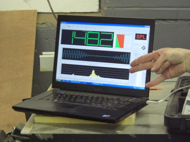

This is what we got :
