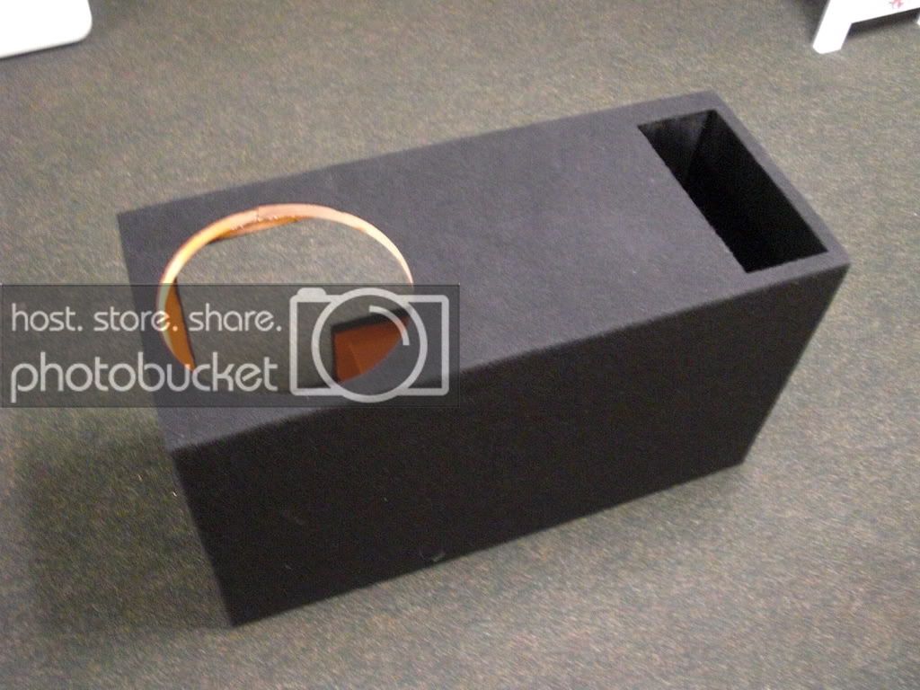

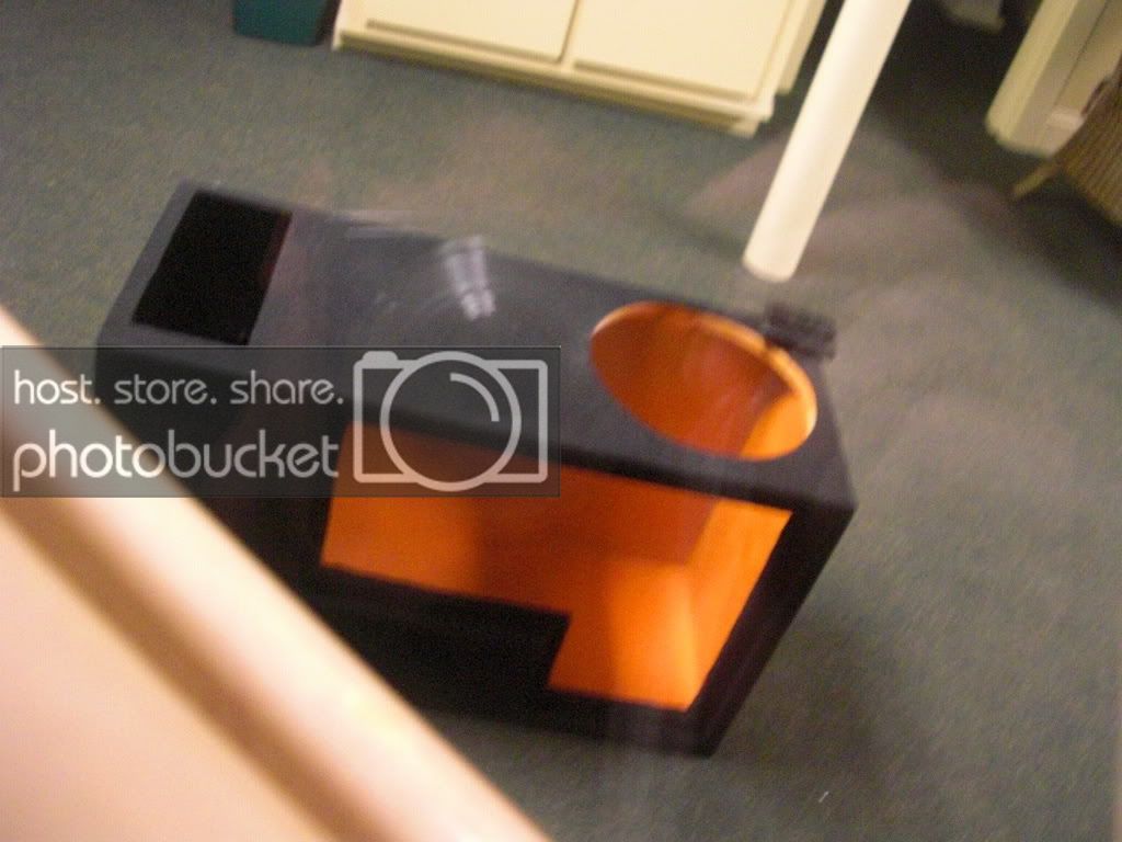

here u go, this is my NEWEST enclosure build 33x13.75x19=3.6686f^3
The window cut-out on the side of the enclosure is 0.11f^3
The entire port displacement is 1.291f^3
3.6686+ 0.11=3.778
3.778-1.291=2.487
Sub displacement is .24
2.487-.24=2.247f^3
2.487 cubic feet tuned to 33hz.

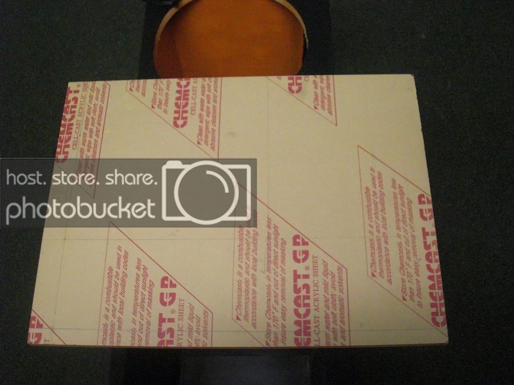

Photos of Plexiglass

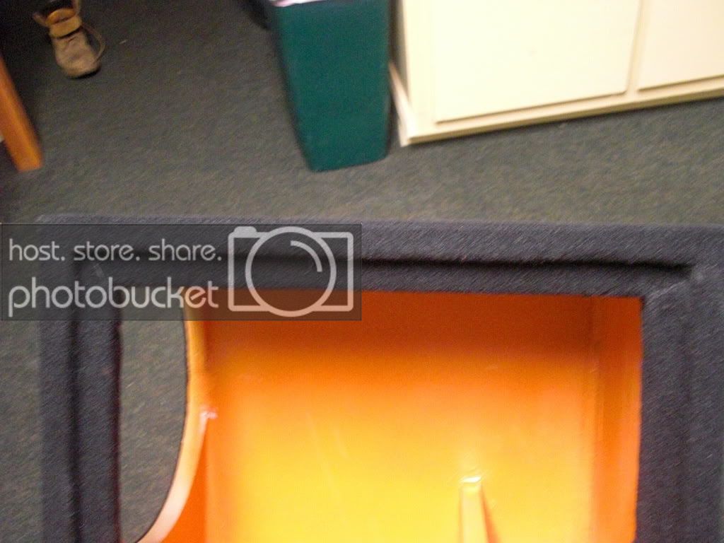

This is a side view showing the end of my enclosure where the seams would be
Here is the view of the side with the seams
PLxiglass cutout
