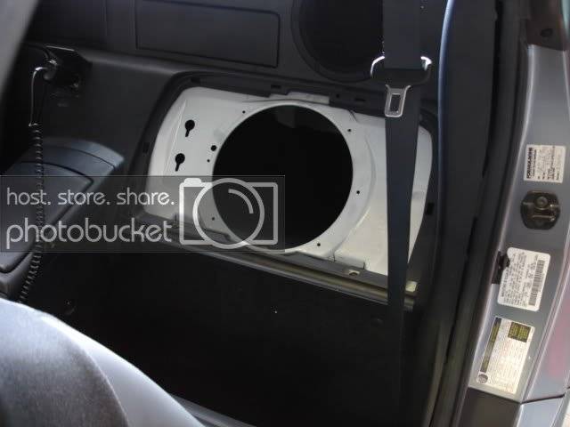

This is the slot behind the driver seat (This has the bracket/metal to mount the factory sub.. mine is just a square hole..)

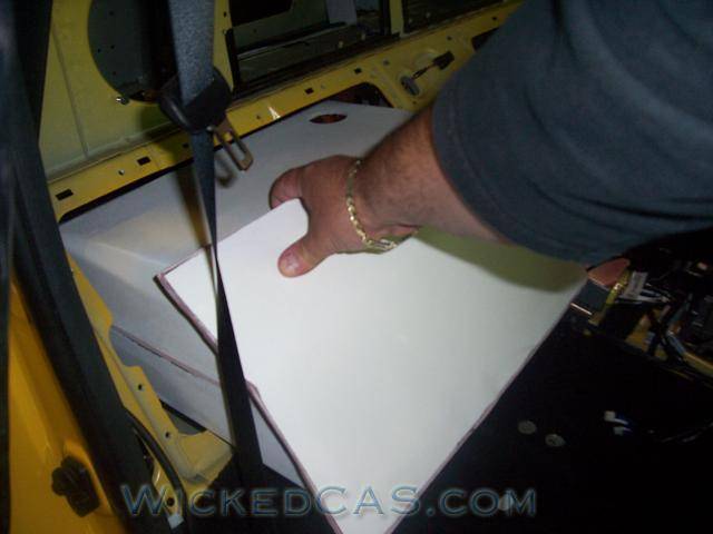

Here's someone who's put a similar box into that location (gives you an idea of how big it is):
It fires downward,.. the guy who has the fabrication shop says he tried every angle and that was the best sound.

We've installed a pair of those boxes in a convertible Z and we used a pair of the Focal KX27 11 inchers. We had to mod it just a little but they sounded great in those boxes. If fact we ended up getting the boxes back because he wrecked the car and they are in the stock room ready to be sold to someone.....
SRQ Customs is Ryan's shop and he's one of the best custom fab guys in the business......

We've installed a pair of those boxes in a convertible Z and we used a pair of the Focal KX27 11 inchers. We had to mod it just a little but they sounded great in those boxes. If fact we ended up getting the boxes back because he wrecked the car and they are in the stock room ready to be sold to someone.....SRQ Customs is Ryan's shop and he's one of the best custom fab guys in the business......
Awesome. Someone who's put one (or two in your case) of these custom boxes in a Z (even if it is a convertible and mine is coupe),.. and knows what it sounds like.
Might I ask what size sub (and if you can remember what type/power?) -- I'm trying to gauge how much this SINGLE sub in that box firing downward is going to sound and more over IF it will rattle the car and reasonable volume levels without trying to dynamat the vehicle.

As for sound deadening, etc.. on the custom sub enclosure area.. there isn't any extra room to sound deaden in that location.. box fits the entire area.. you squeeze that sucker in there literally. And as you say,.. yes.. if some rattles come up, I'll go back and tackle them bit by bit.
