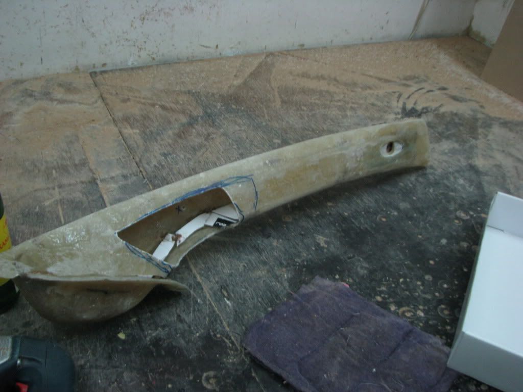

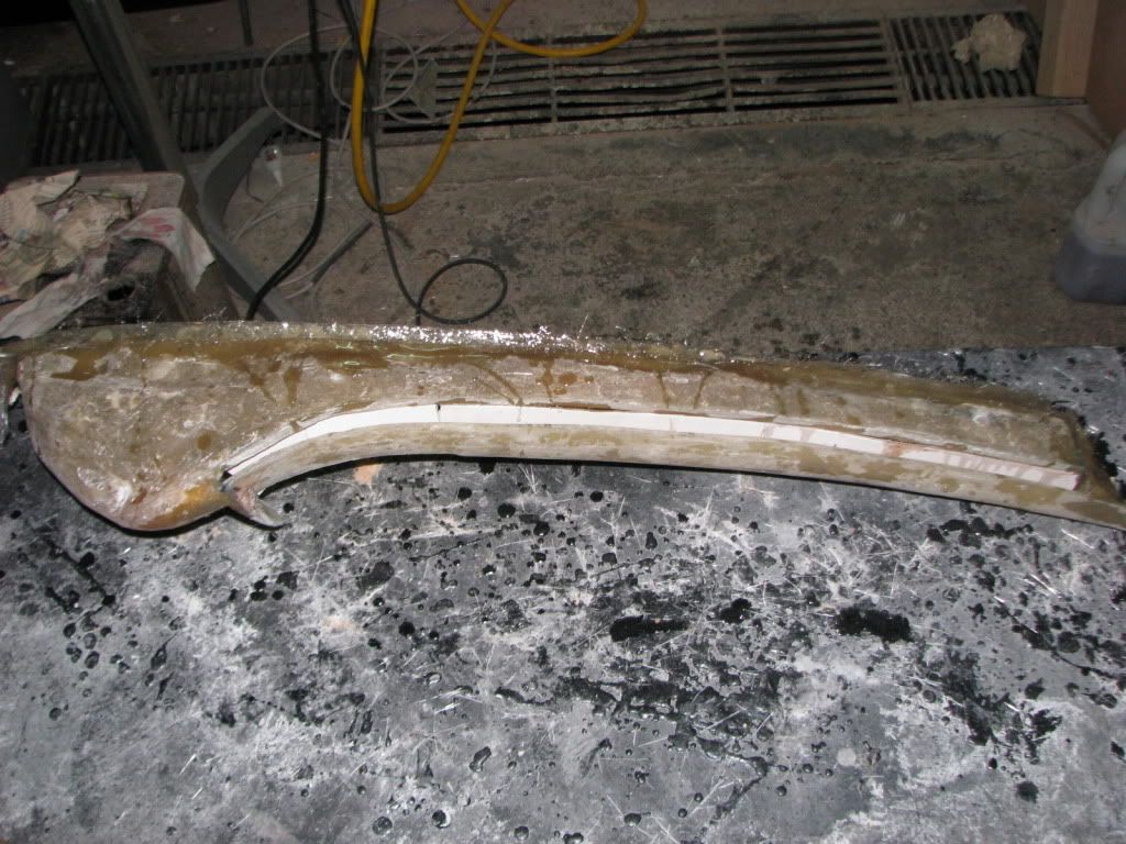

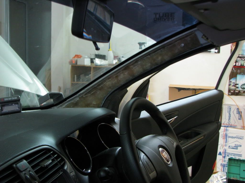

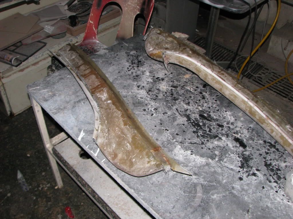

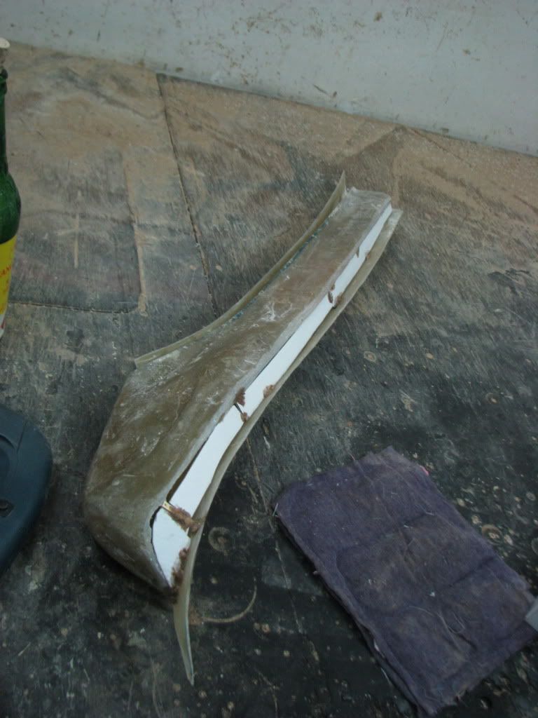

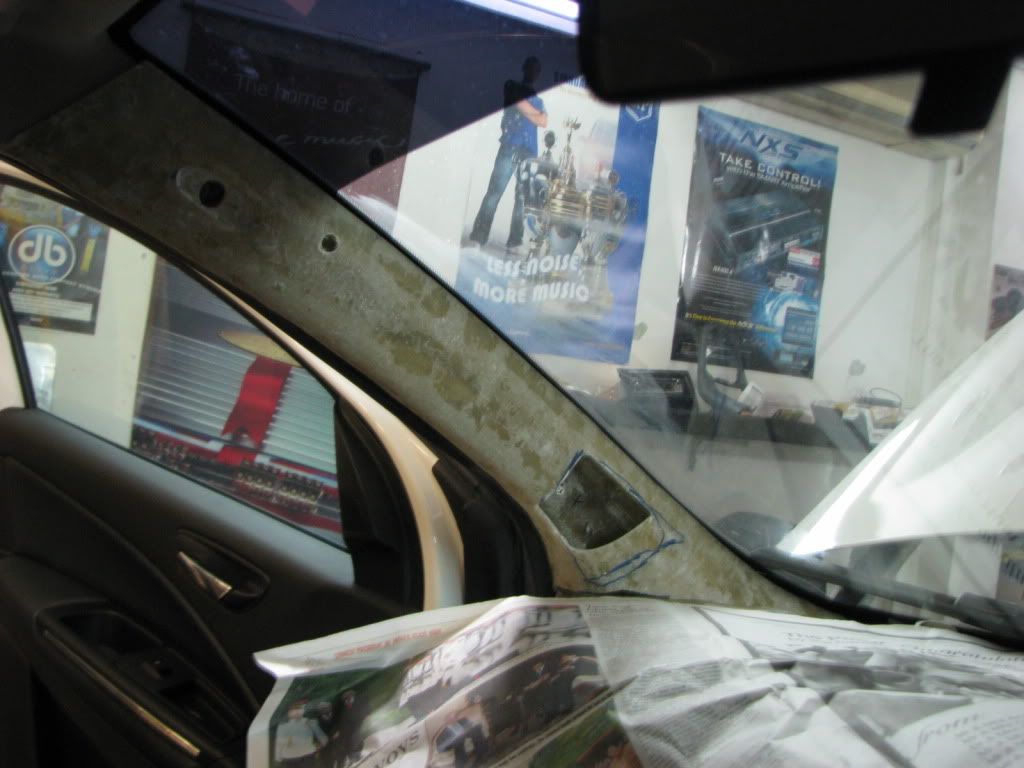

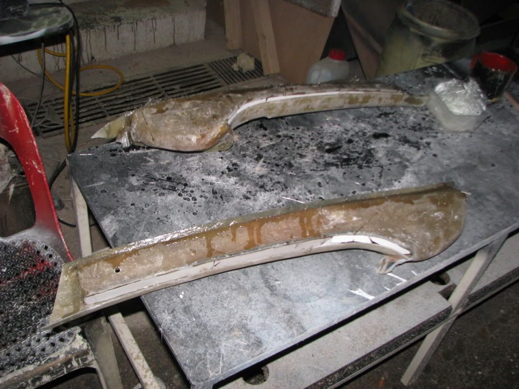

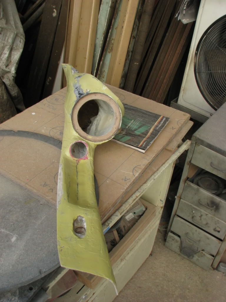

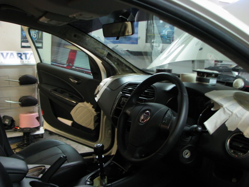

But what I do have are pictures from another fiat bravo, using the same exact speakers. The A pillars for the Comp car was built in the same exact way. So here are some pics to give you guys a better idea how this massive A pillar was built

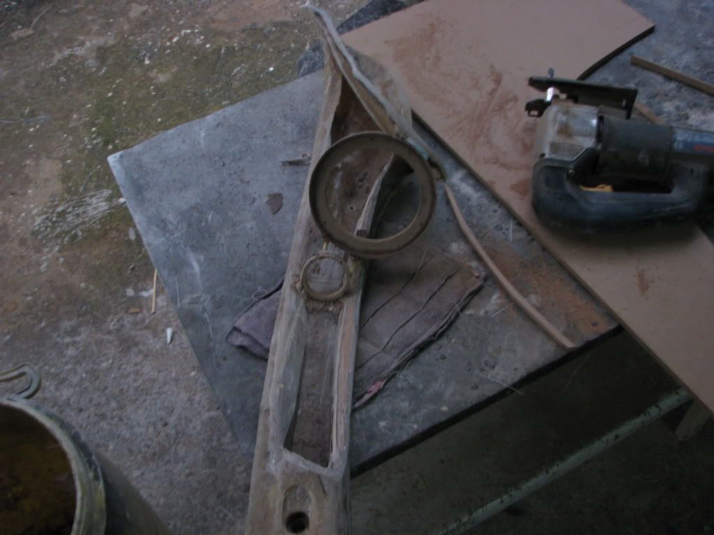

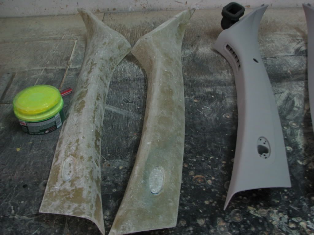

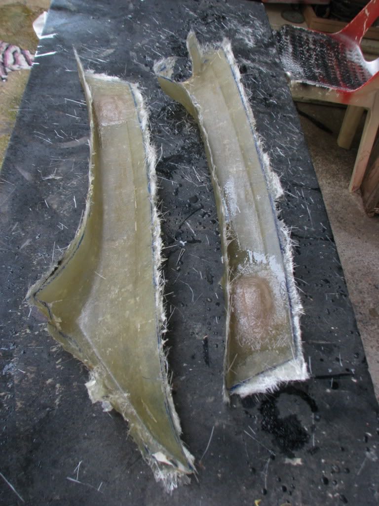

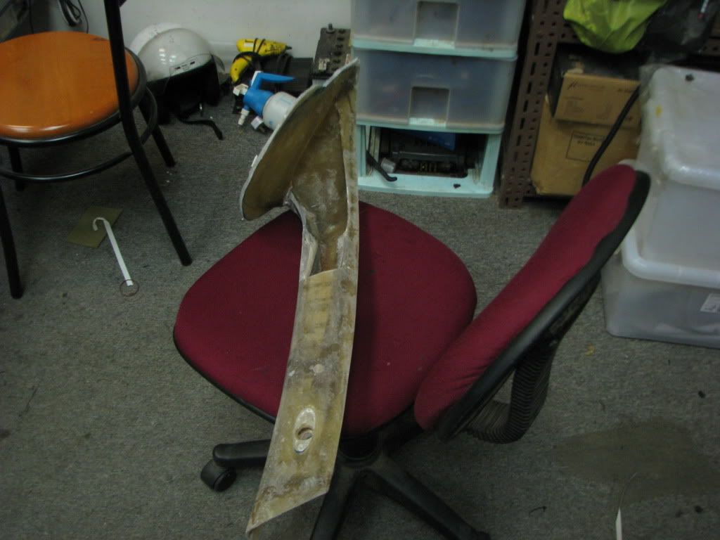

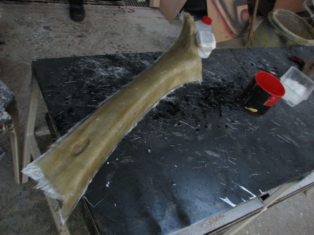

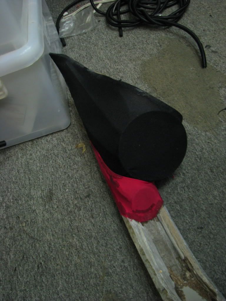

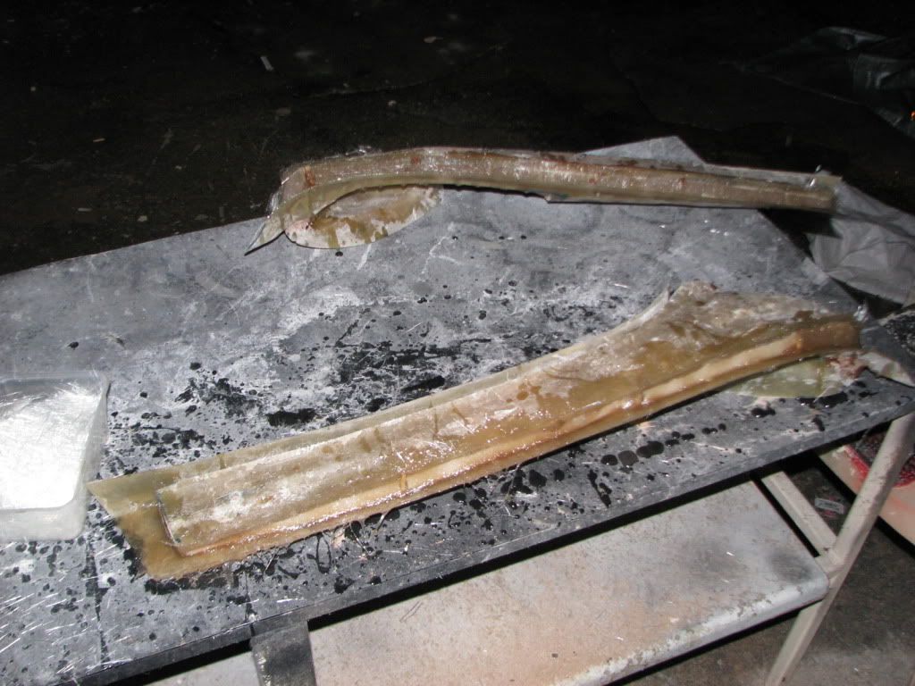

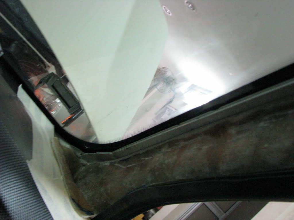

The original A pillars are taken out a mold is made
tadaa!
Instant A pillar!

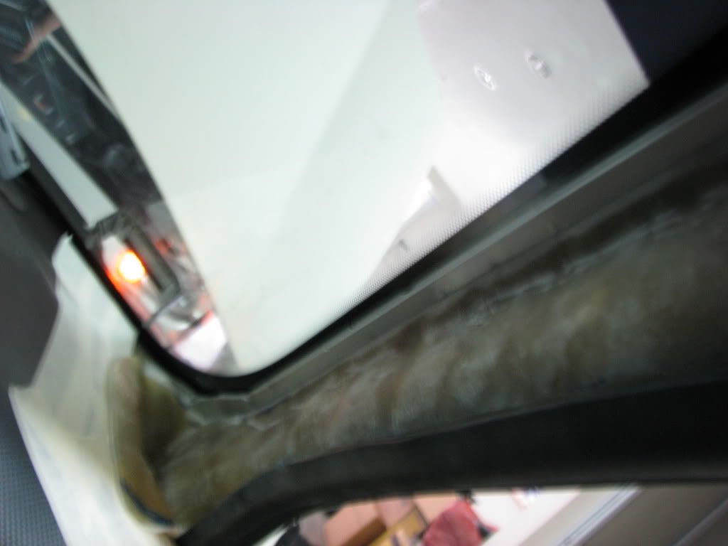

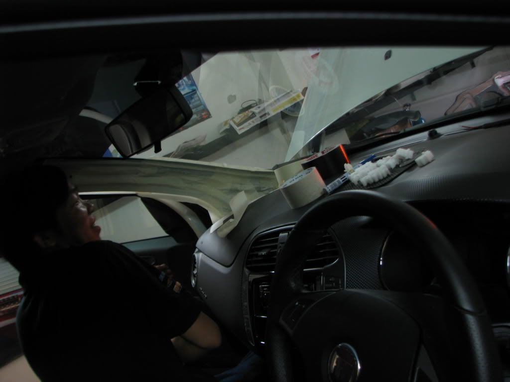

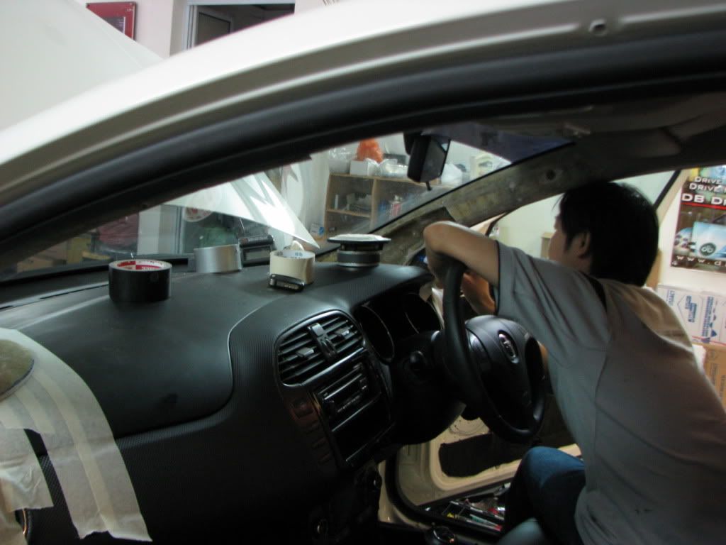

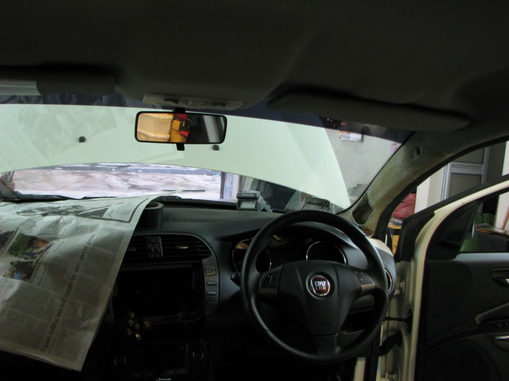

Now for the “ enclosure”.. have the car all taped up
now the fabricated A pillar is put on top
now the 2 pieces are taken out and put together
That’s all for today, more pics up tomorrow.. heheh..
Cheers all

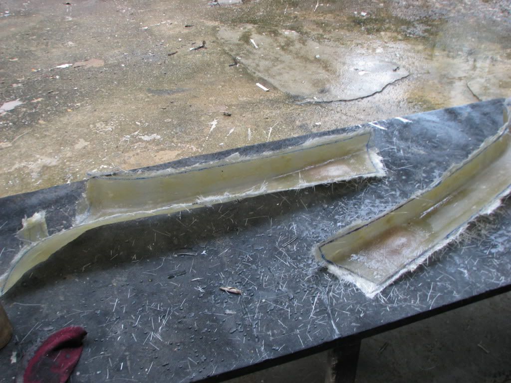

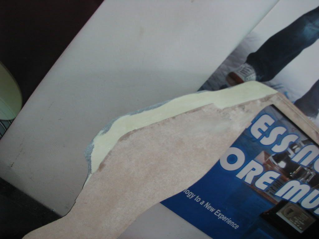

Here’s part 2 of the A pillar build
Now its time to seal off the “ A pillar”
and here we goooo

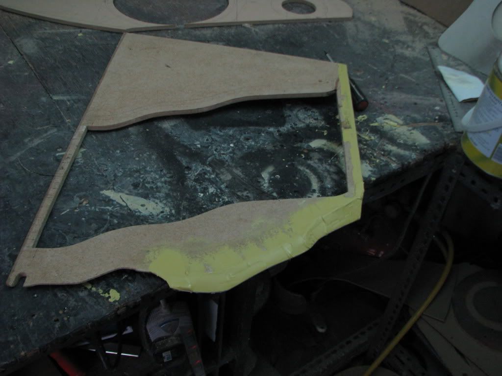

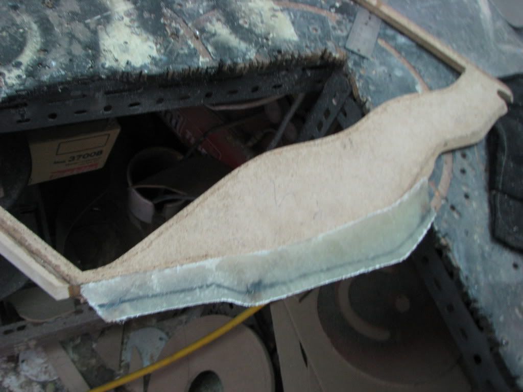

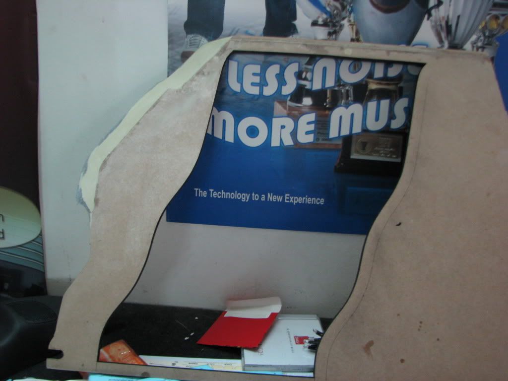

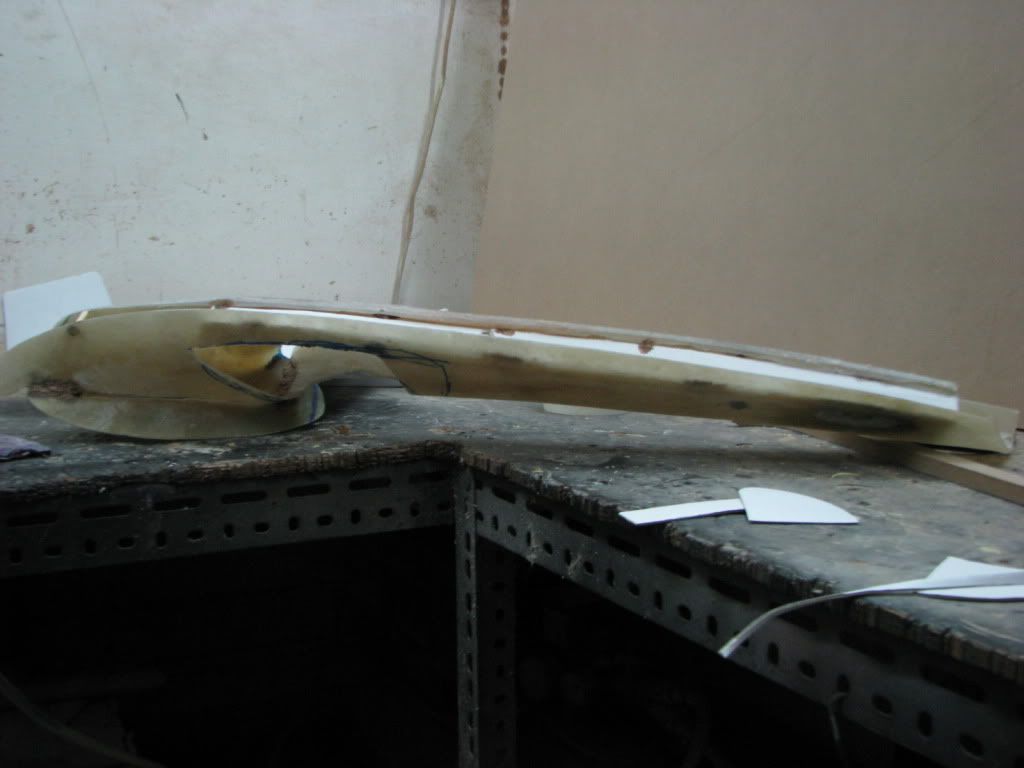

now this is the base of the A pillar. This is the part where the baffles will be mounted onto
taking measurements on where to put the tweets and 4 “
and here we go..
That’s all for today.
Cheers!
Hey all,

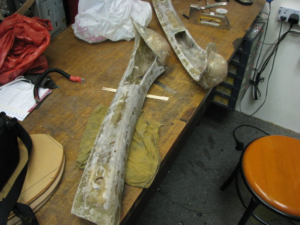

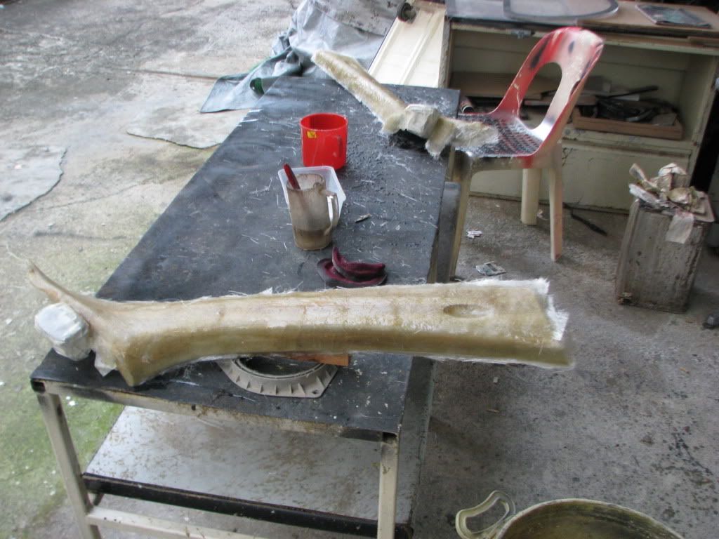

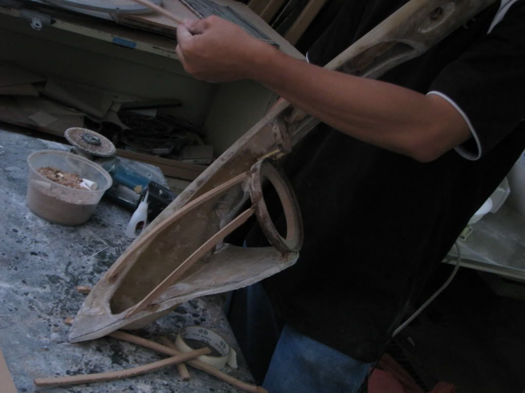

Now onto the last installment of A pillar build

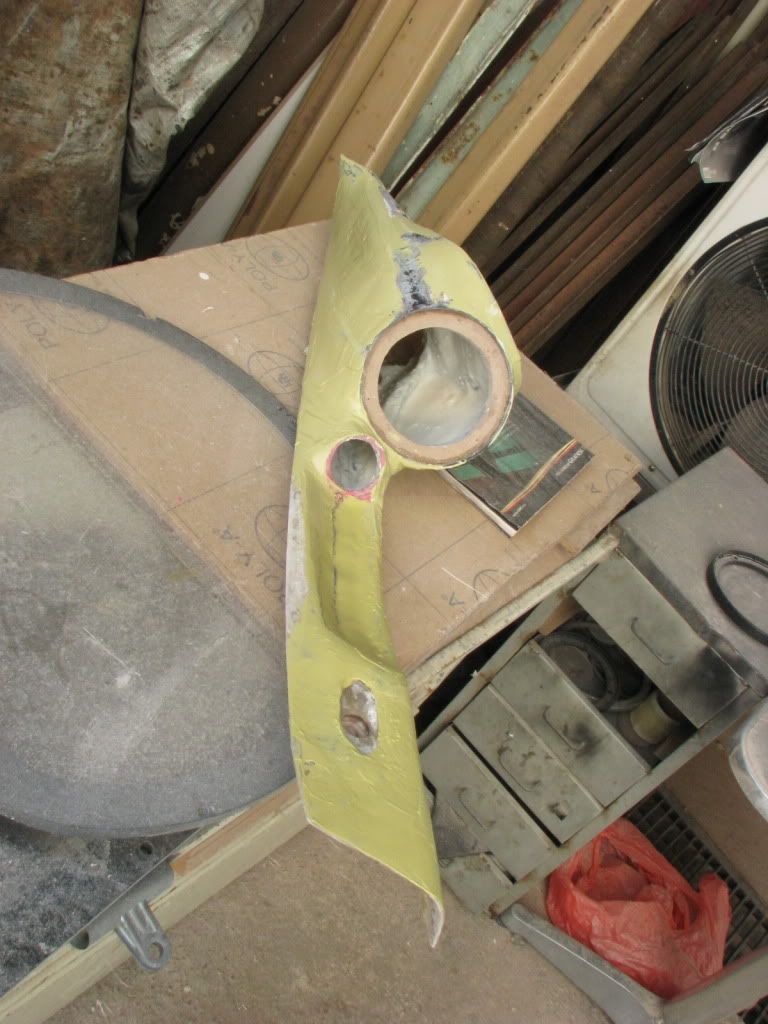

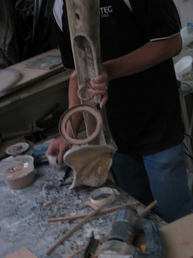

Putting the stand offs on the baffles
what I like about this A pillar is the frame work. Its as though it has a skeleton.

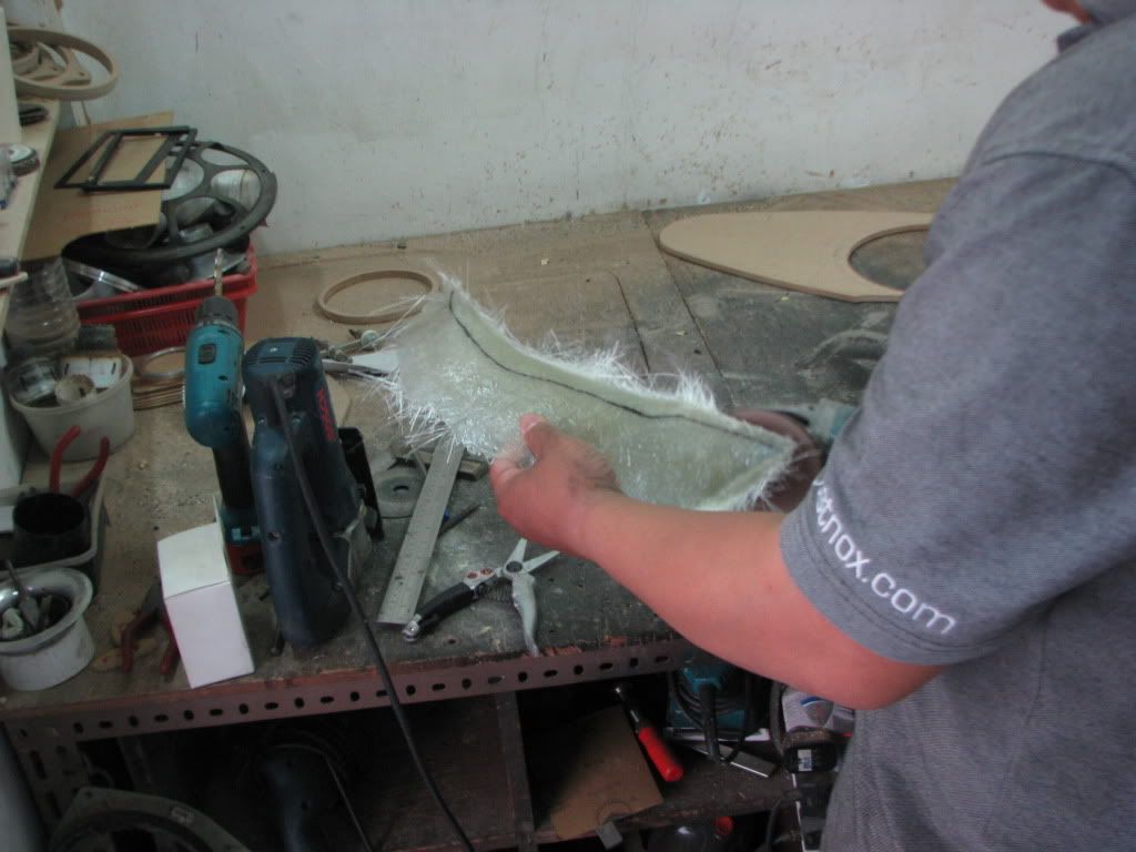

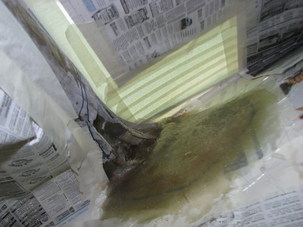

now to pull some fabric over

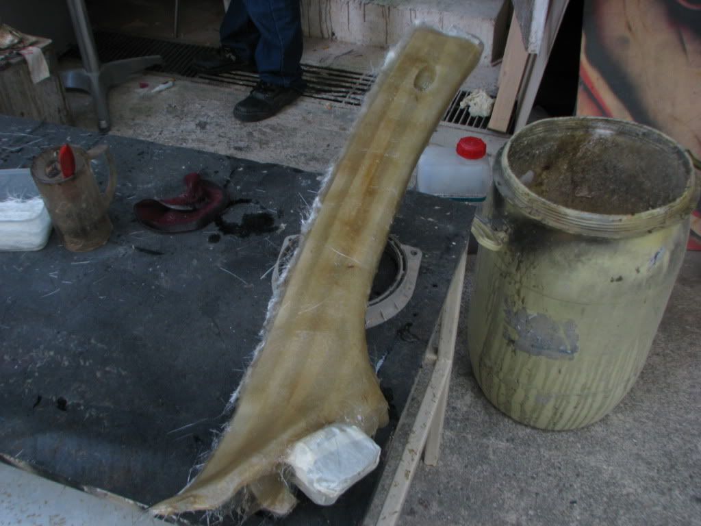

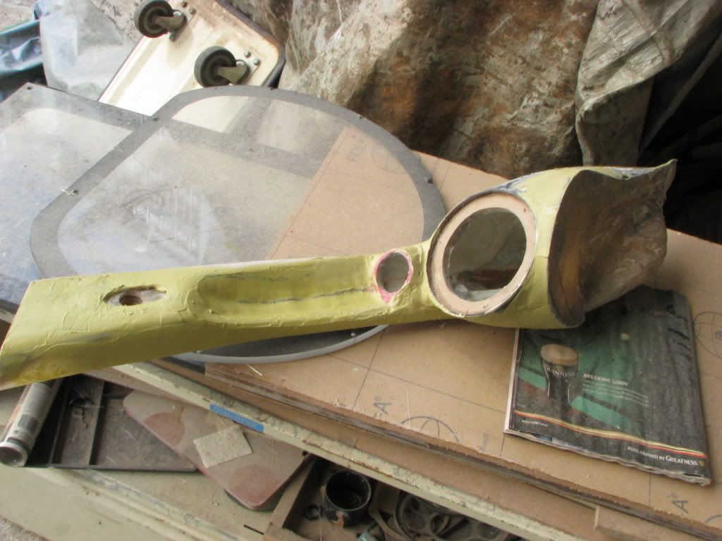

applying resin is pretty straight forward,
So here’s the end product
from here on, the A pillar just needs a shit load of sanding and its all ready 

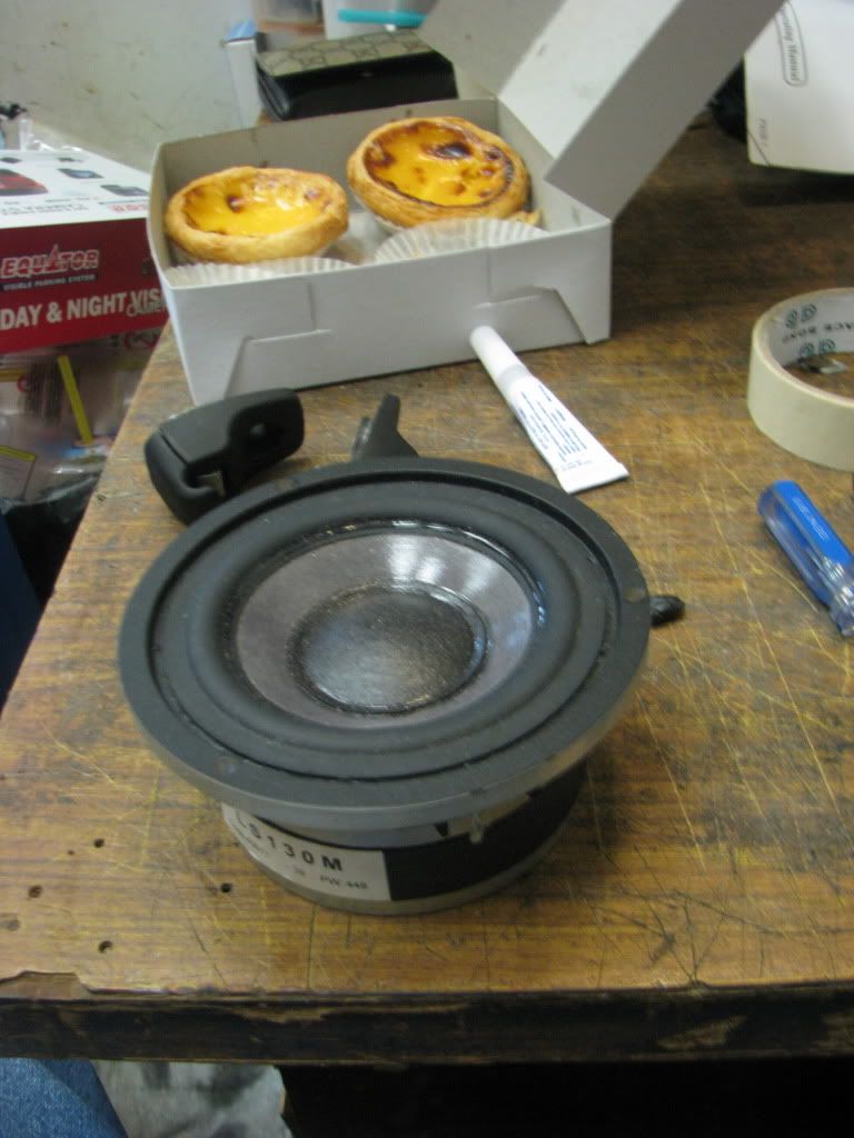

The test car we had this setup on used a Clarion D2 ( 9255 for the US folks). Now we have it on the #F1 and it’s a different beast.

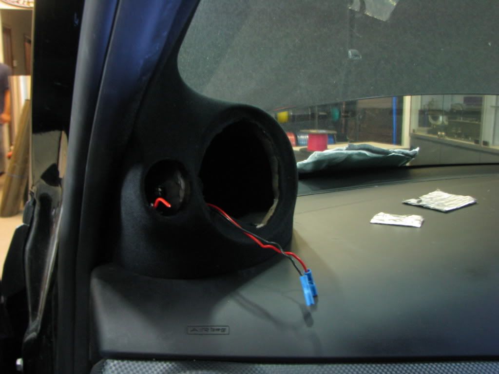

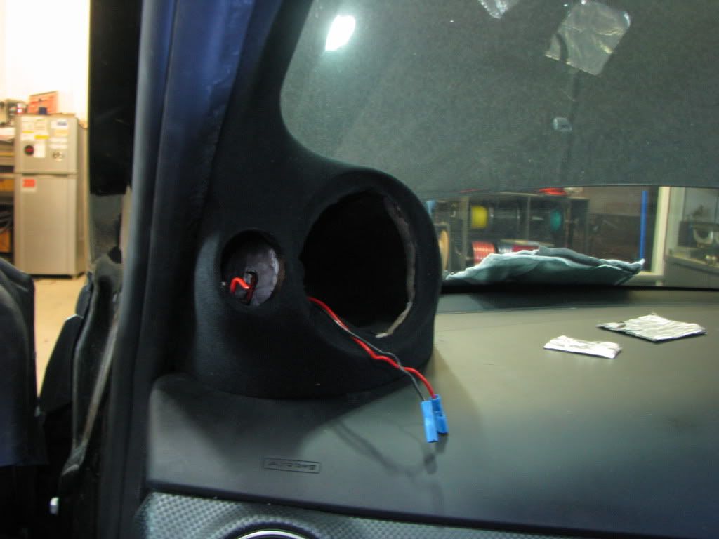

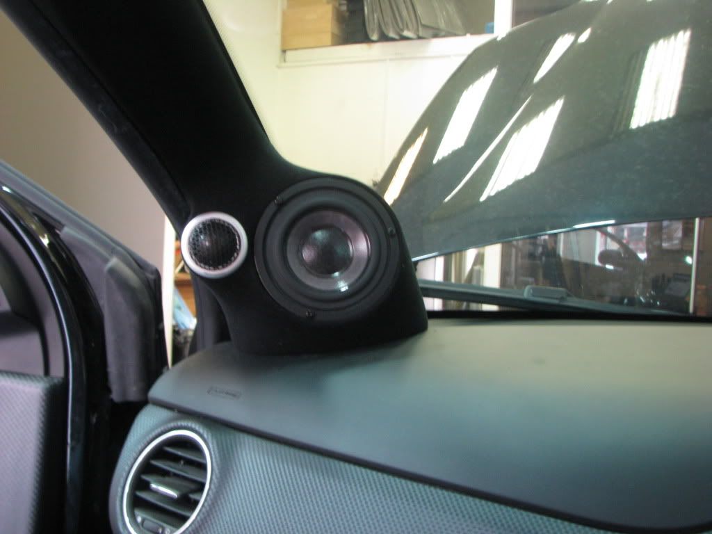

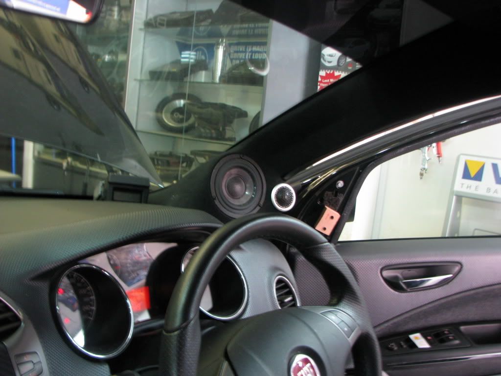

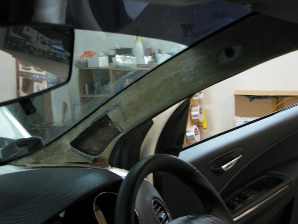

We got the A pillars in.

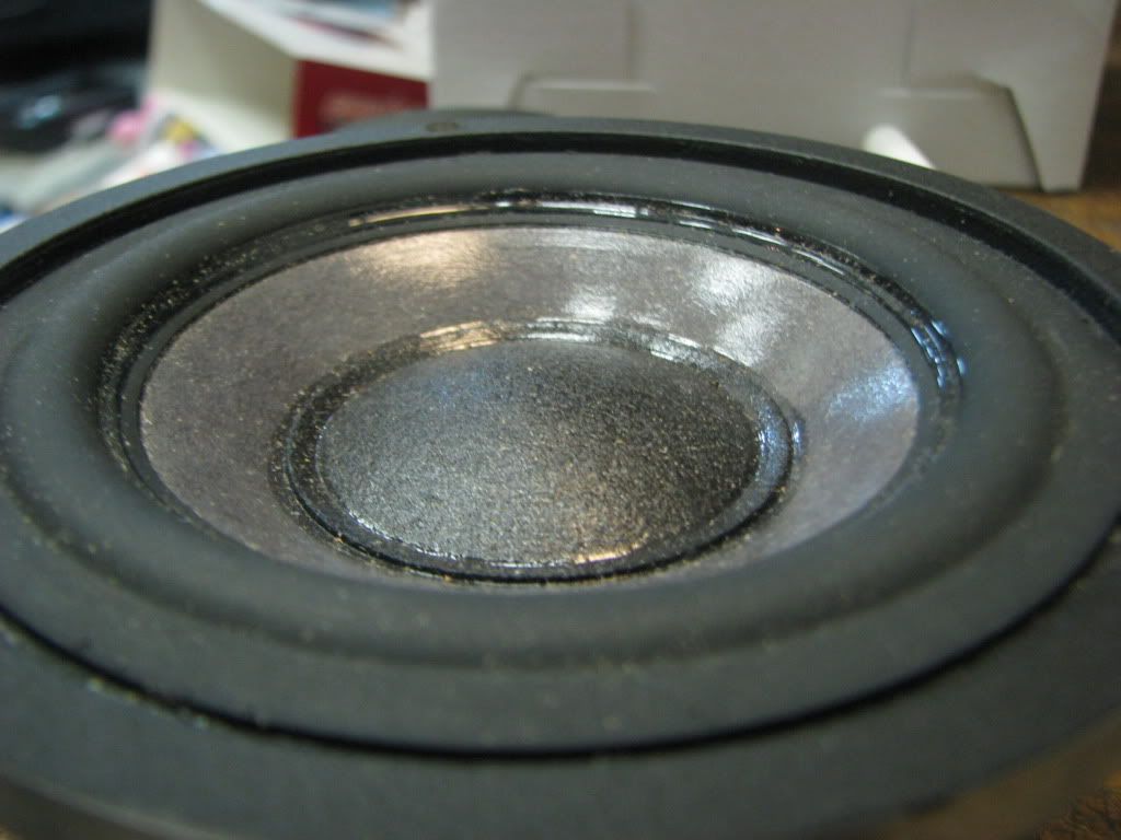

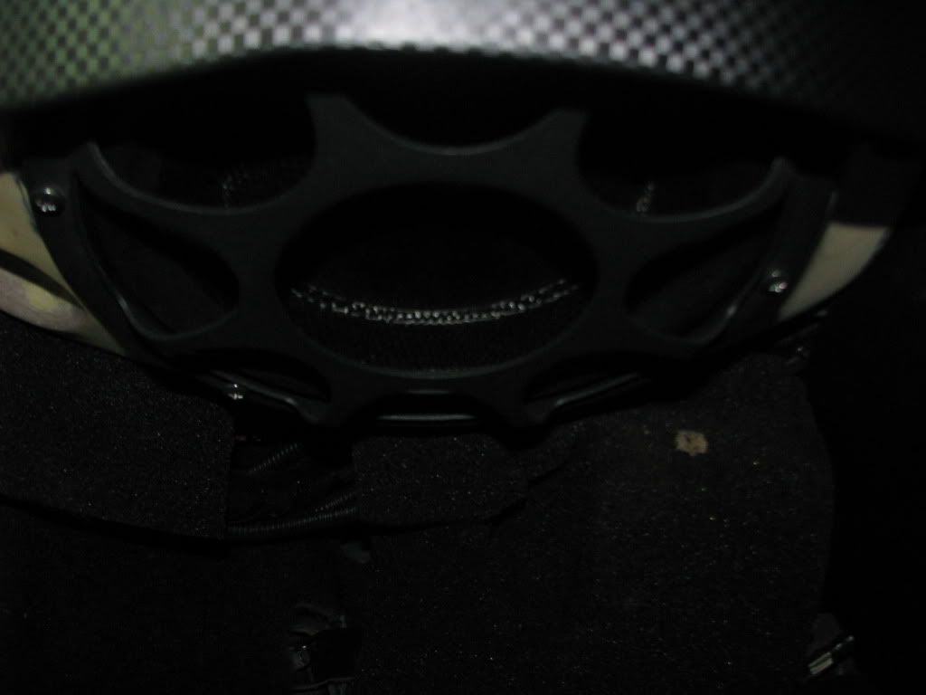

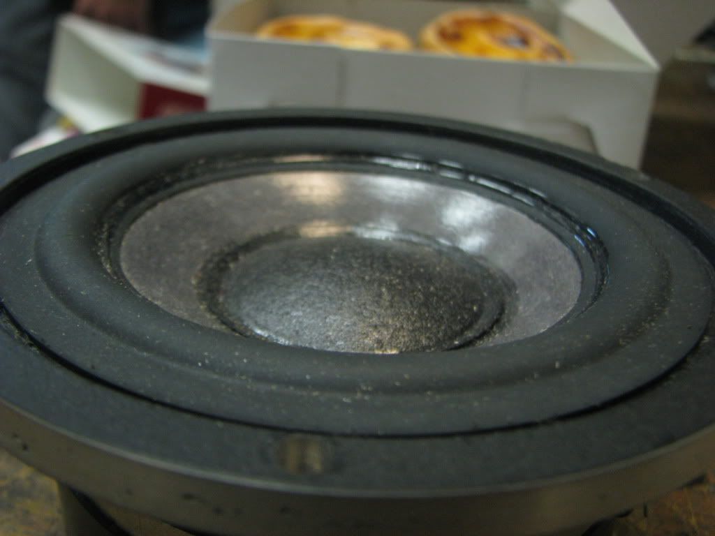

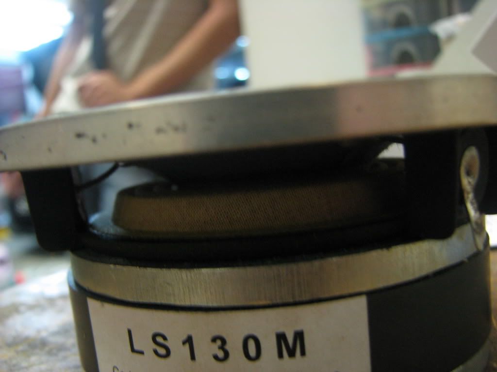

Here’s some close up shots of the mid range, EB tec LS 130
speakers in

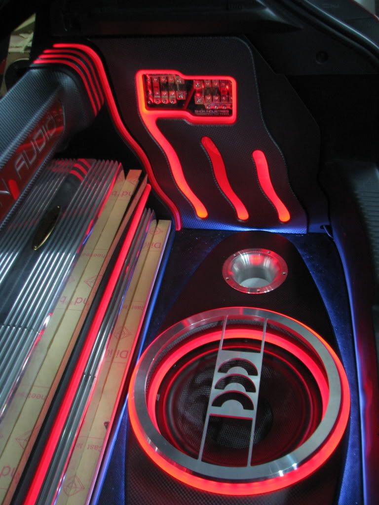

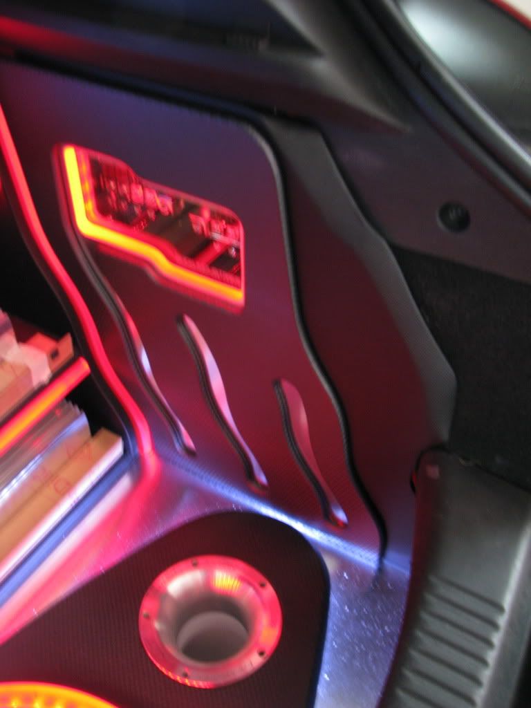

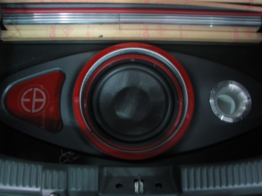

Now we actually hit a little snag along the way and are re-doing part of the layout.
Problem was the colour scheme, it is TOO RED! It looked like vegas when we open the trunk at nite.
So well, some things gotta change. Look out for it.

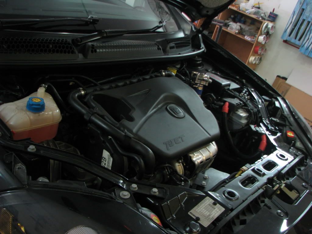

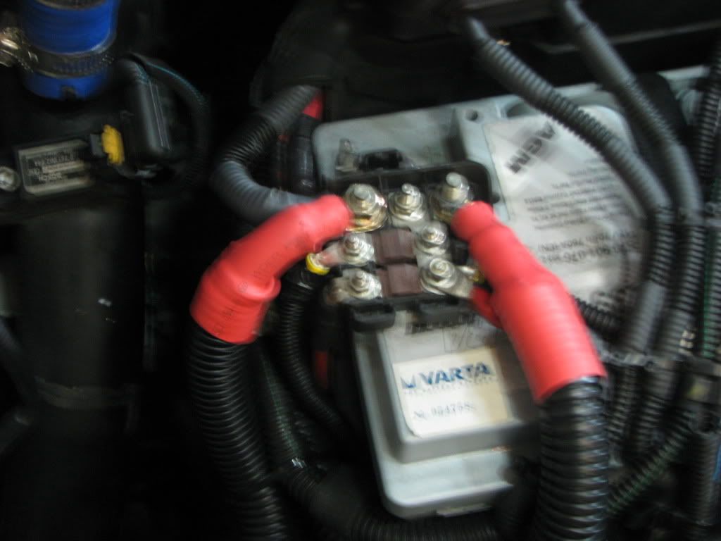

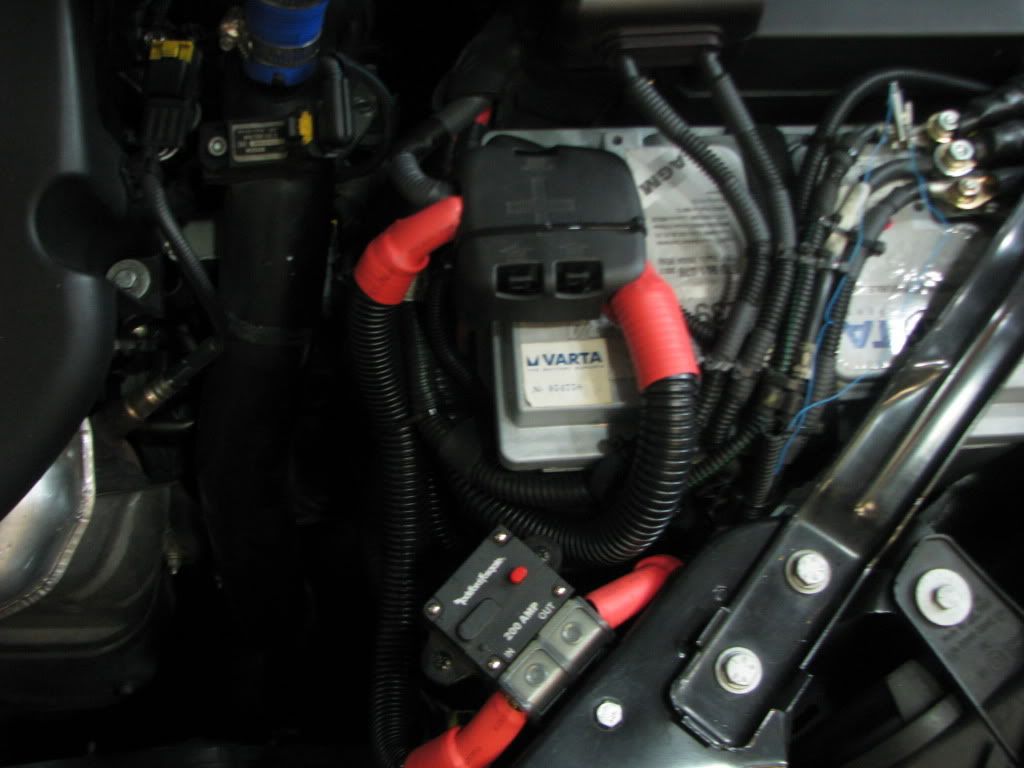

Well, we just got a new jack for the car.. hahaha.. pretty cool colour too!

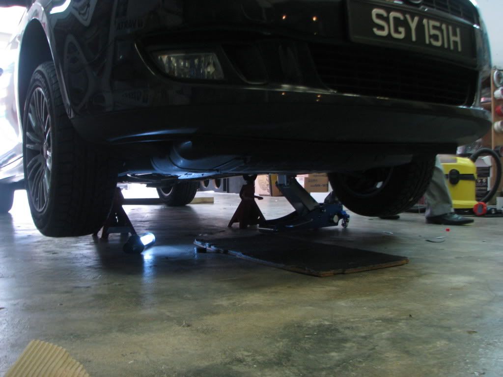

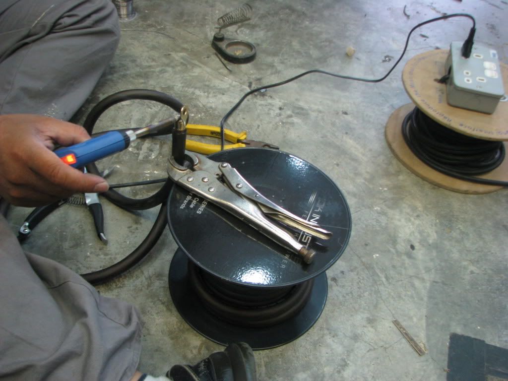

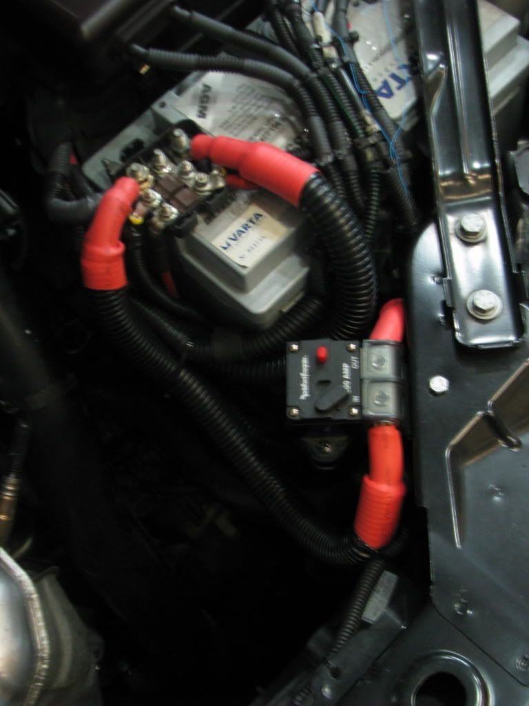

Anyway, bad thing about the Fiat Bravo is that the dam alternator is under the car and we have to jack up the car to gain access to it.
Engine bay shot
jacked up the car

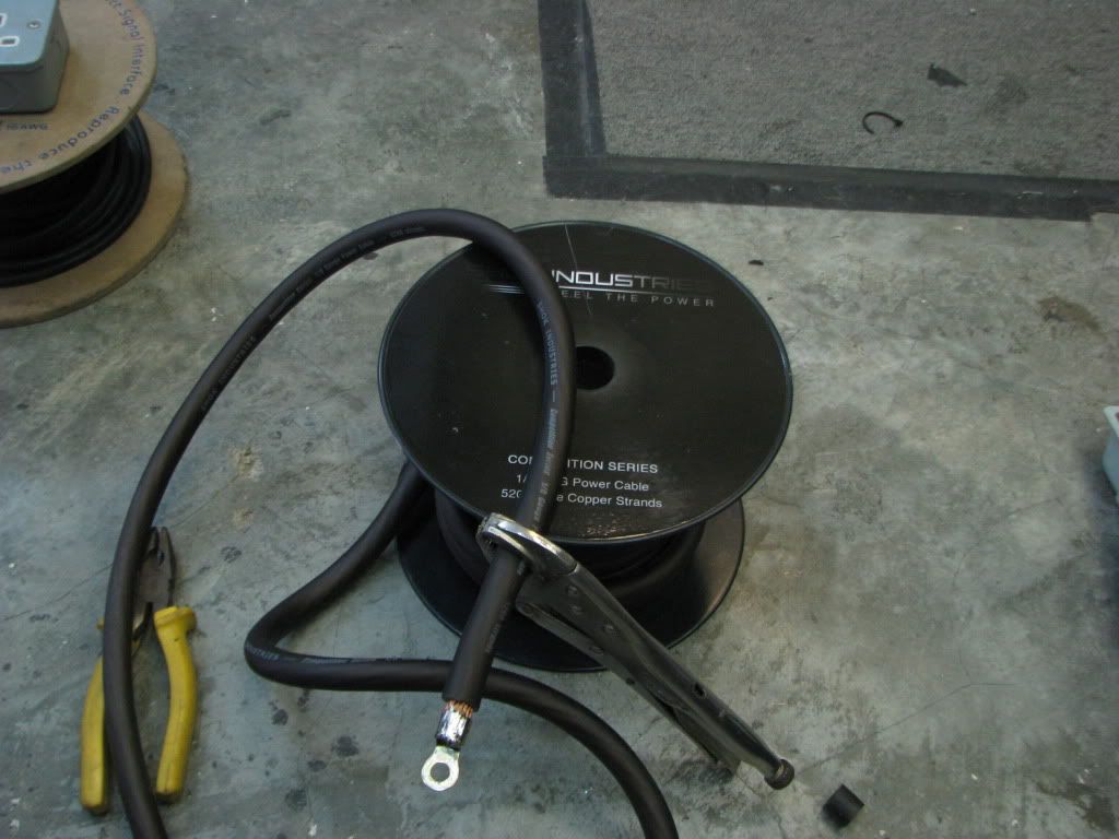

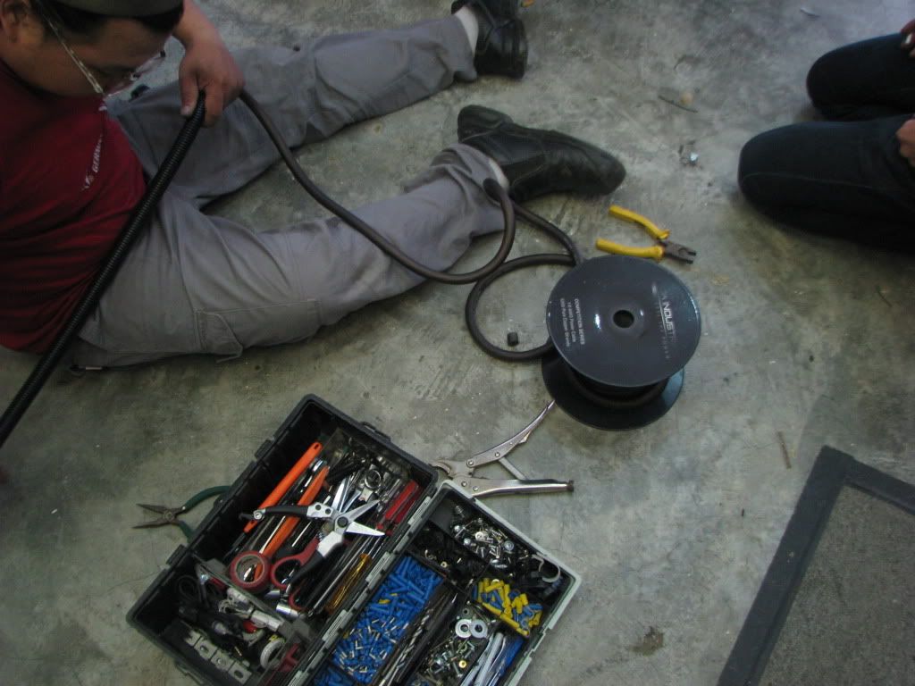

preparing the cable
and there we go

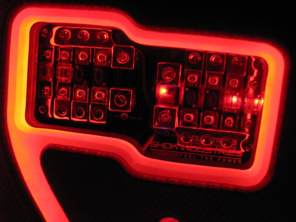

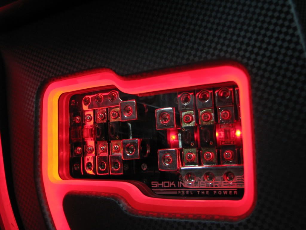

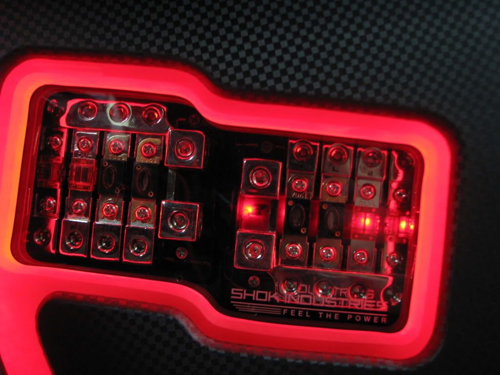

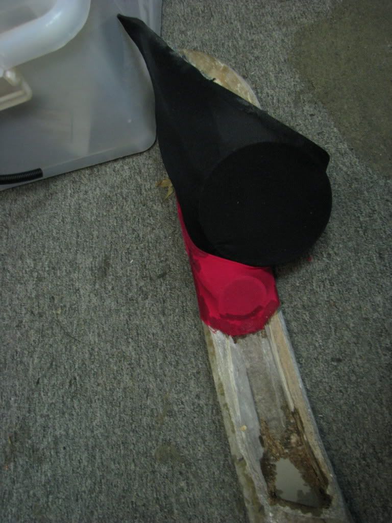

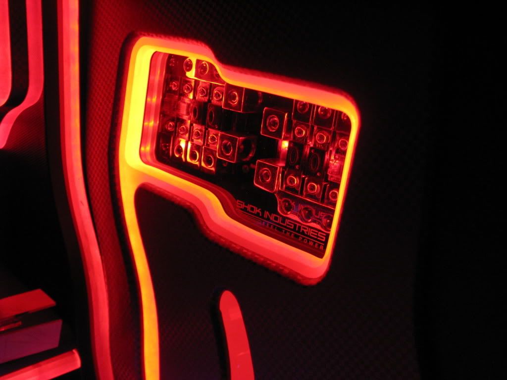

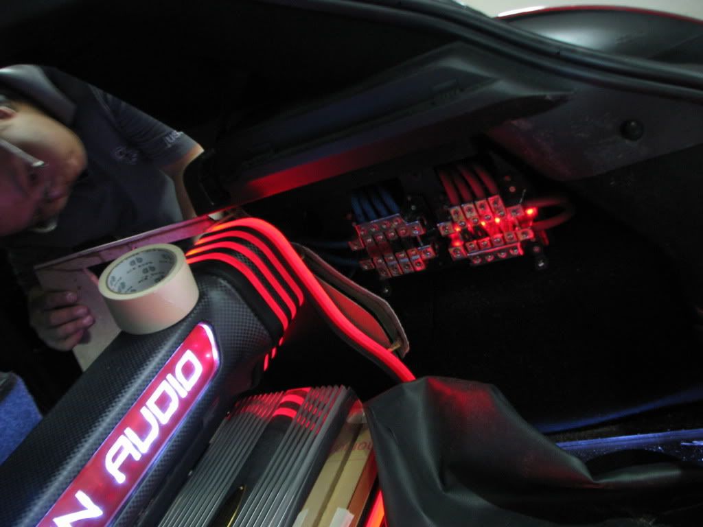

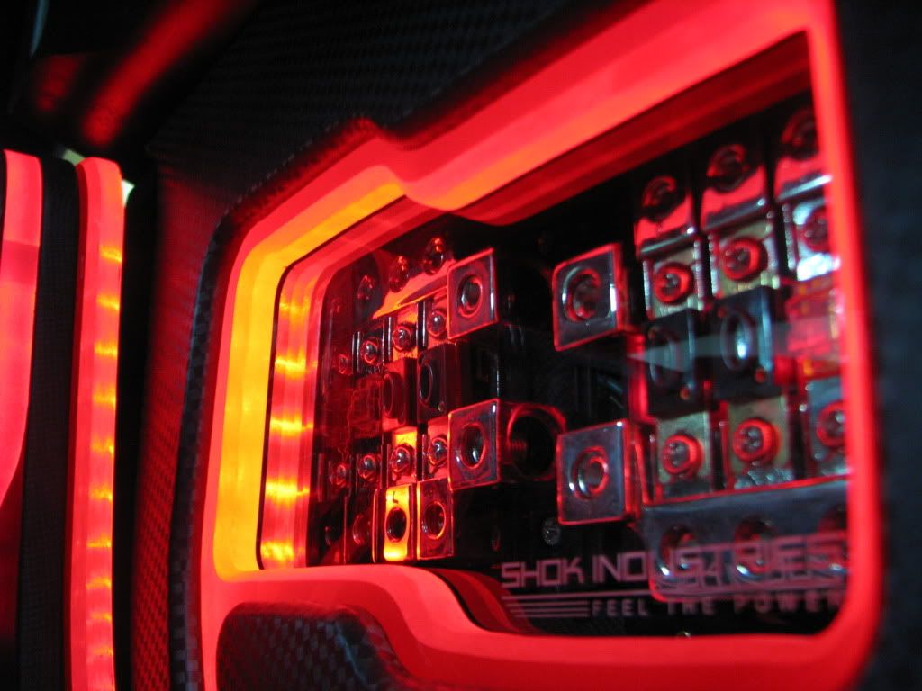

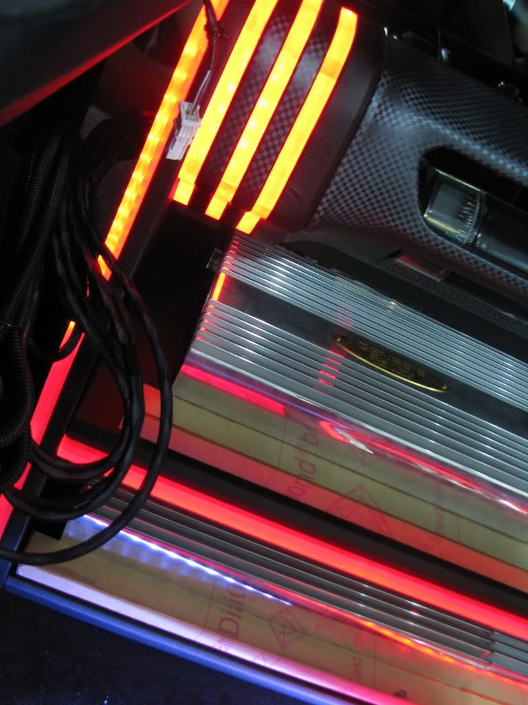

As you all know, we had some problems with the colours, well, here are some of the things we’ll be changing.
This has to go
though the design is cool, think there’s too much red, we didn’t expect it to be too dam red!
But I do like these pics..
hahahaa..

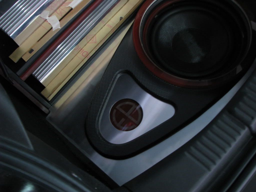

well. This will be the few red parts that will be staying
the woofer ring red will be GONE! Hahaha..
plus some things changed along the way.. so stay tuned!

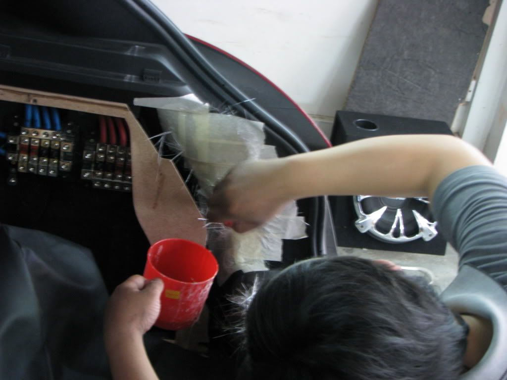

Hi all,

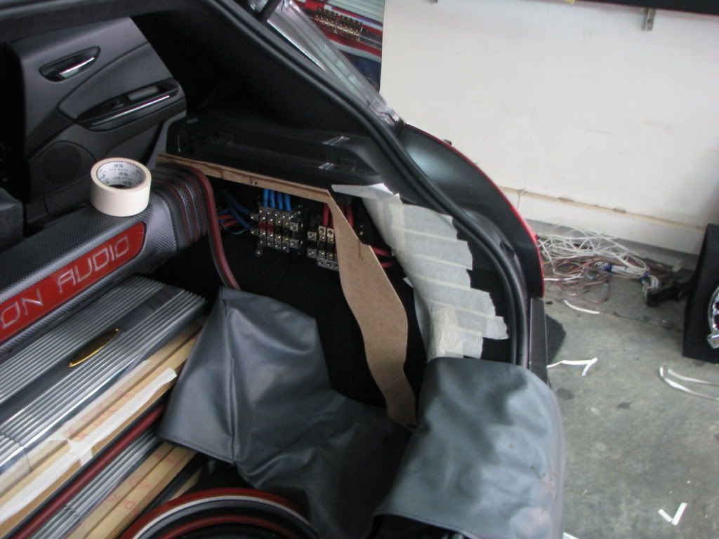

For today, just some little cosmetics here and there.

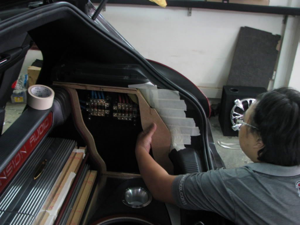

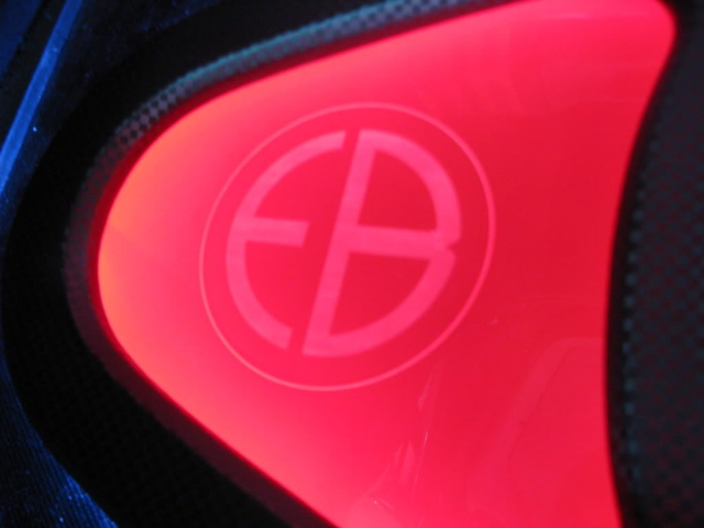

The new and improved EB Tec logo

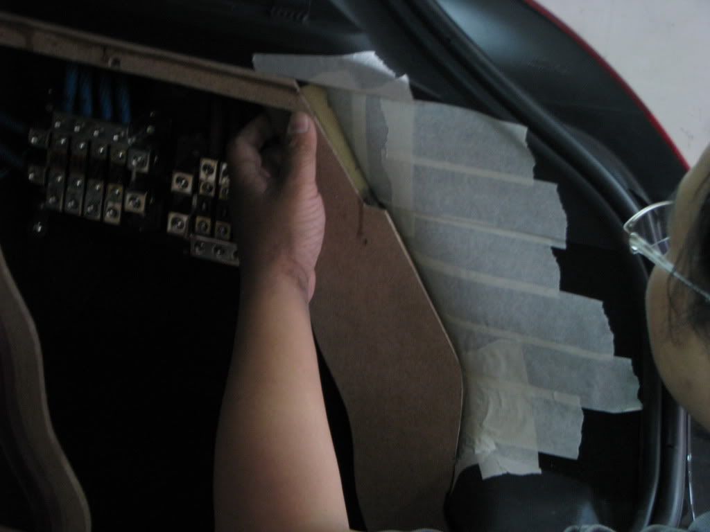

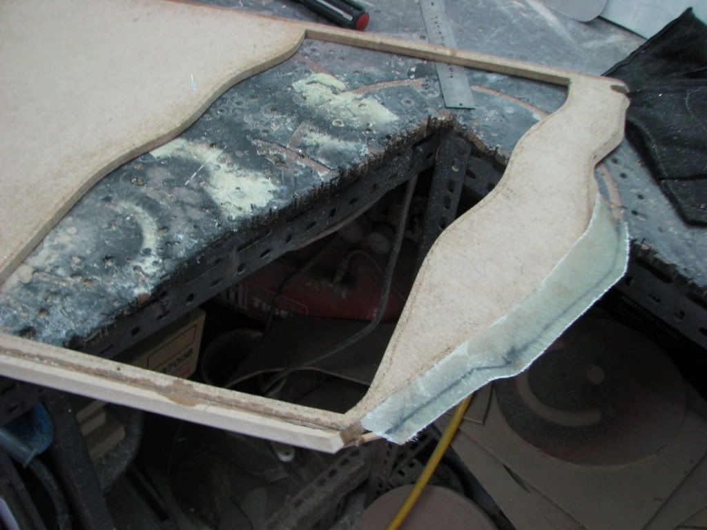

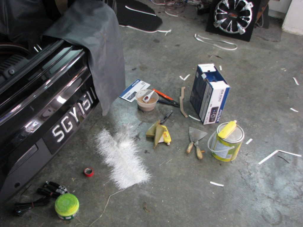

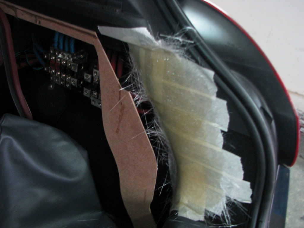

Some little attention to detail, had to flush the end of the side board to the edge of the boot.
Preparing for fibreglassing
dum dee dumm
time for some sanding
