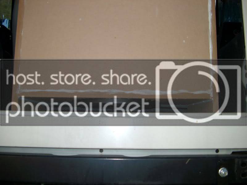

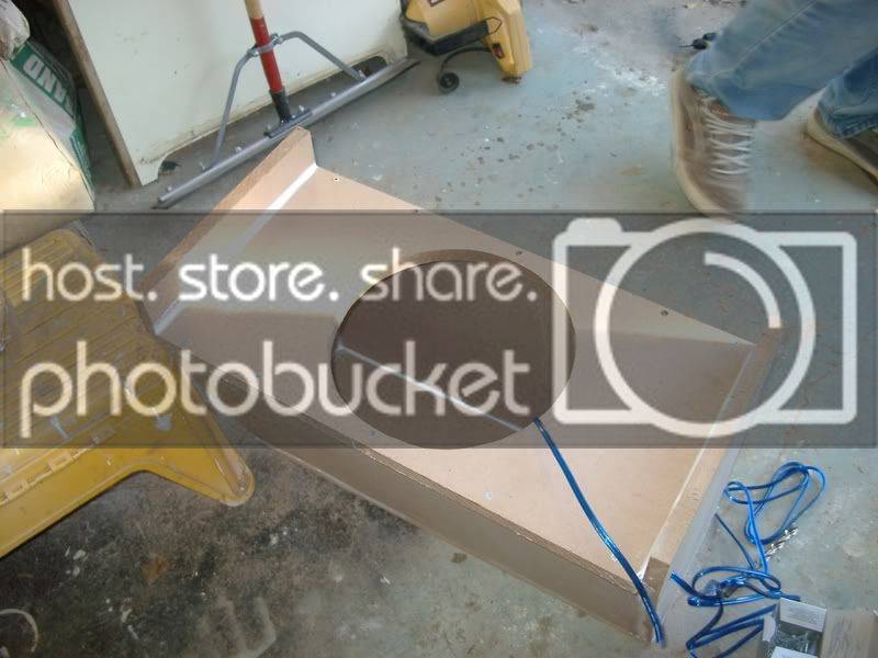

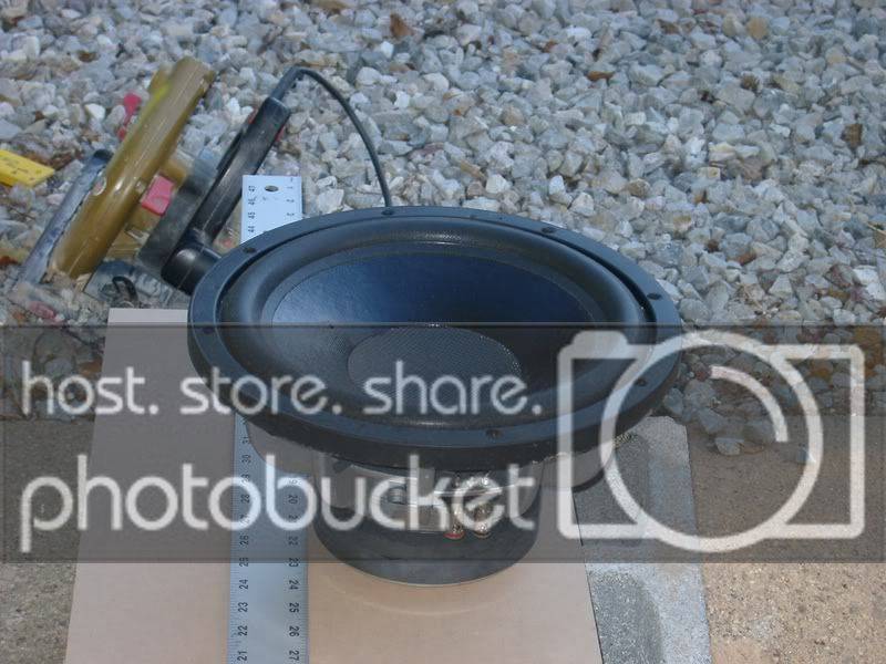

Just spent 4 hours building a downfireing box for my friends wrangler. Its holding an Atlas 12 and should be ~ 1.5. It sweet sq and got louder than i expected. Lacked a little on the lows but thats expected. I built it all from scratch b/c of the angled back.
unless someone has the keys 2 his car they cant take it since the doors can only be locked and unlocked by the key(no automatic stuff). And since its angled with the back of the seat and the subs on the bottom they cant take it out
ill be installing his amp 2marrow which is a RF 350s so ill be getting 100 more watts than it was 2day. Also im on rattle patrol which shold be pretty easy since wranglers arnt the most complex cars

How did you get it done in 4 hours? It took us that long to get the wood cut..and then another 4+ to get it all together //content.invisioncic.com/y282845/emoticons/crap.gif.7f4dd41e3e9b23fbd170a1ee6f65cecc.gif.
i dont know i have skills. It took from 12-4 for with 2 of us with a trip to the hardware store. To save alot of time measuring get a big T straight edge so your sure everythings a right angle and for the cuts use a hand circular saw with a long straightedge measured however far the edge of the guard is away from the blade(4 inches for me) and clamp it. Then use that as a guide so you get a perfectly straight cut everytime.
