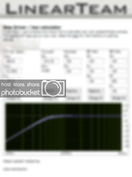

Looking for thoughts on 2 SD-10's or 2 ID10's v.3
Subs will be sealed in .5ft^3 each with the appropriate amp to power them (haven't bought it yet).
I know they will both have decent sound quality so I'm looking for comparison in terms of spl.
The ID's have 17mm xmax compared the the SD's 12mm. However the SD's have a higher power rating and lower efficiency - Better for tiny box right? Soo if I throw gobs of power at them = louder than the ID's?
I've graphed them in winisd (online version). The top line is the ID.

Anyone care to do some modeling to shed some light on this?
