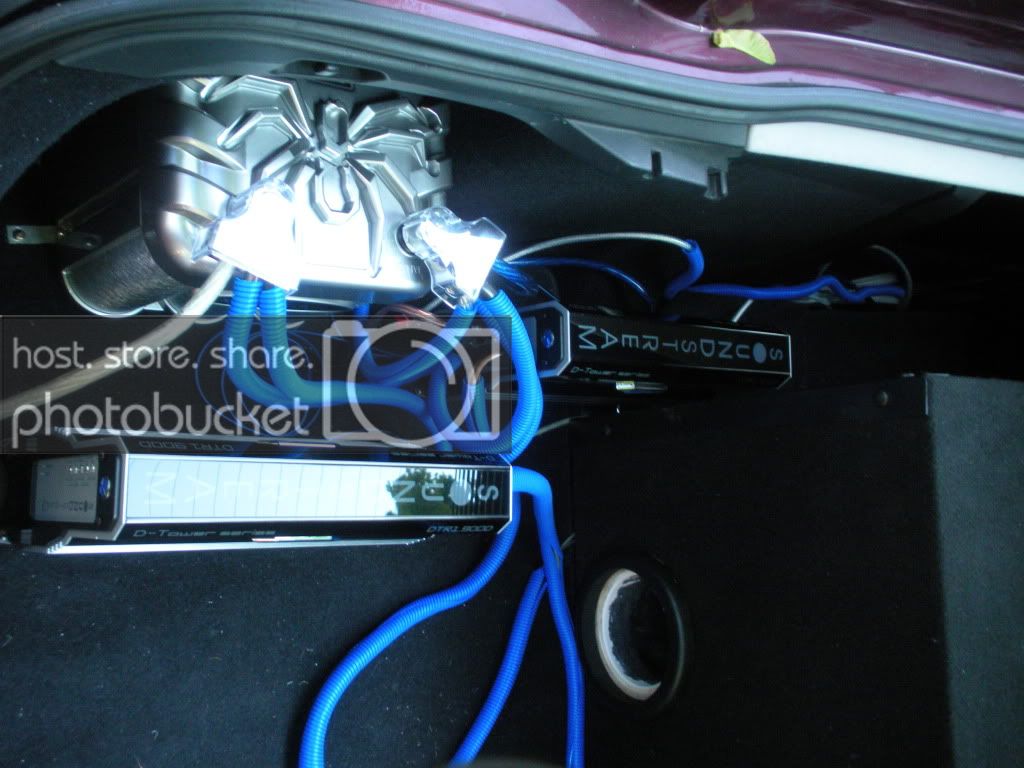

thanks so much bro! just curious, is there room under seats or anywhere else to put two or atelast one large c&d batt? i can put em in the trunk but thats a shitton of space to use
the width I gave you leaves alot of space on each side of the enclosure to put a batt + more.
Here's a pic of my old set up, as you can see minus the amp the battery (in this case a soundstream scell-1000) fits in nicely. The wheel well is very shallow on these cars, so unless you have a narrow battery and lay it on its side its not happening. The only way to even get amps in there is to remove the spare tire or one of the hard foam holder things on each side of the spare tire. These however provide support for the trunk floor so if you remove one be sure to add in a few smartly cut pieces of wood to add strength esp. since your enclosure and battery will be on top of it, I guess thats not an absolute, you could get away without doing it but I wouldn't suggest it. Almost forgot to post the pic, so here it is:
