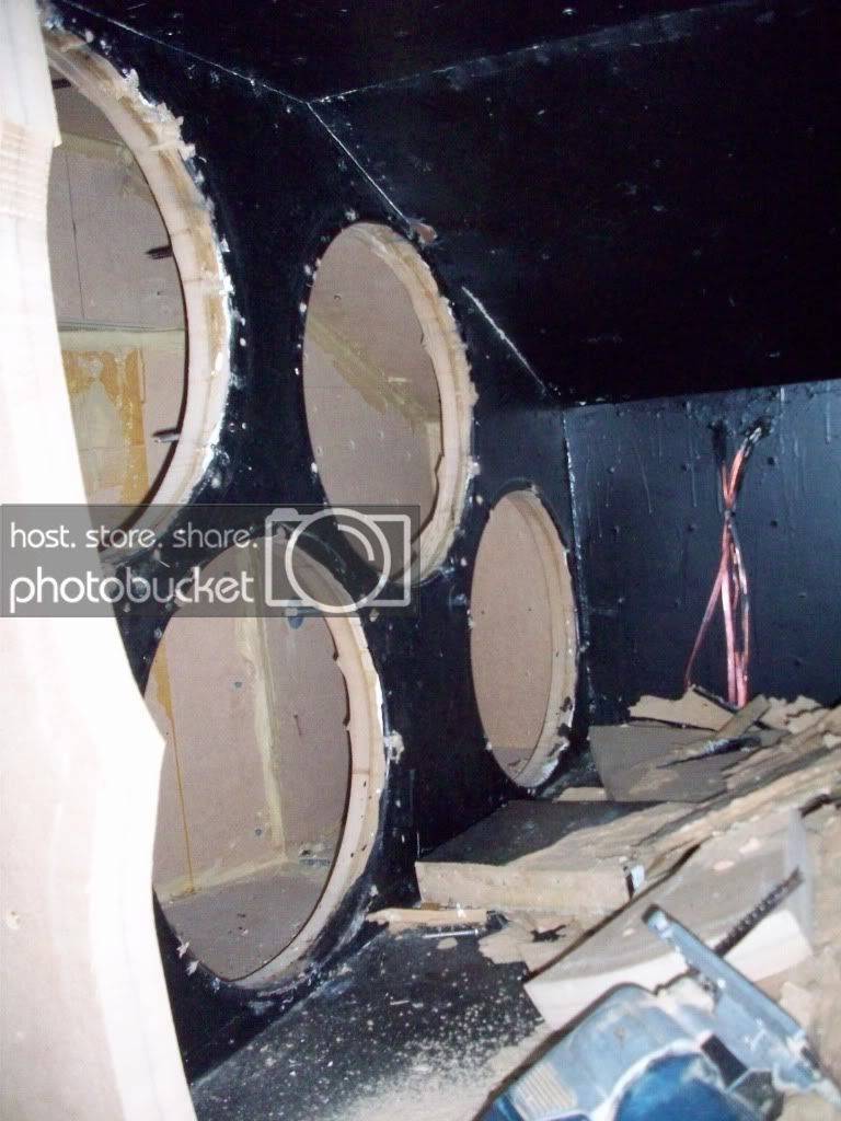

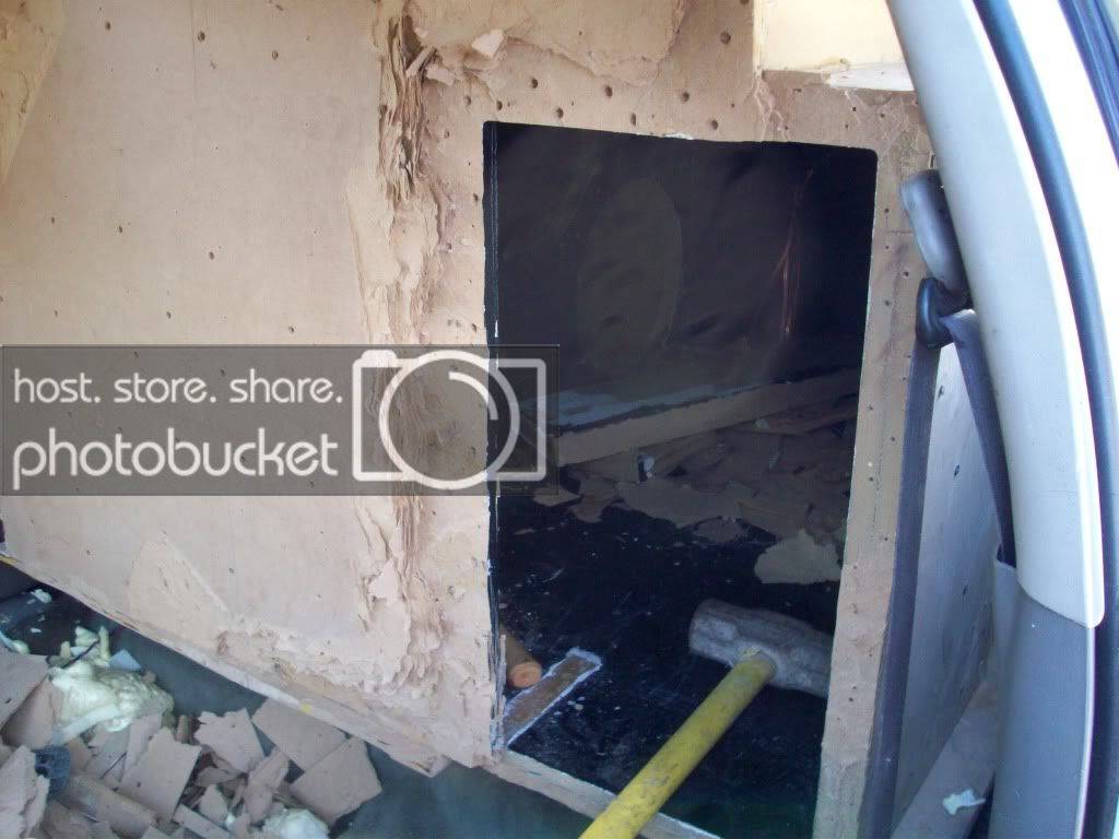

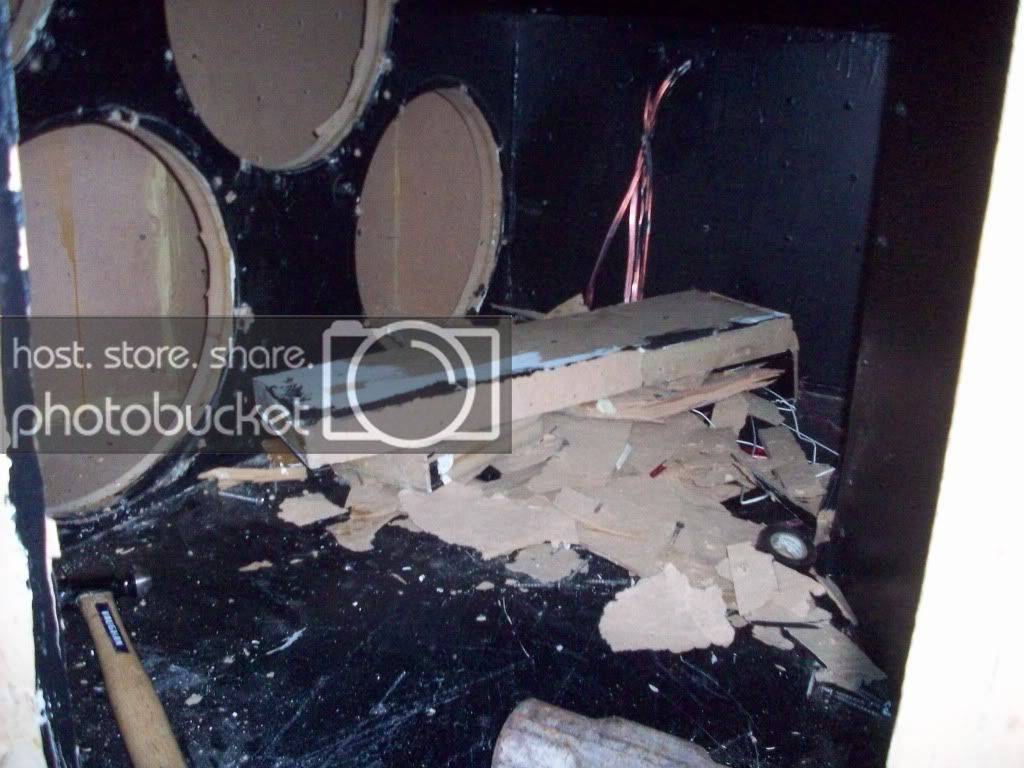

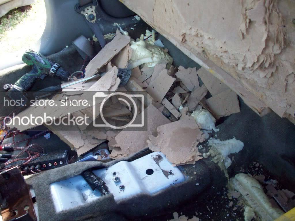

its a car sir. an 02 malibu. so shes been together now for bout a yr and some change... shes been used and abused... the dps are gone and the wardens are brutal.... so its time she went in for a face lift...

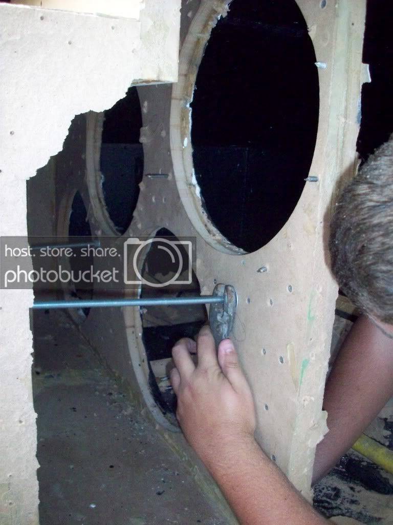

this pic right here is the life saver... flush mounted with as additional ring on the inside. groove and flush mount lock sub into place !!!! no guess work as far as lining them up. also screw holes are place so that there arent anymore tight places to try n fit a drill in.
also the additional ring on the inside serves as the seal against the surround for air tight seal of sealed section. FN GANGSTER IS ALL I CAN SAY ABOUT THIS....
THIS IS THE BRIGHTEST IDEA IN CAR AUDIO SINCE IVE BEEN ON THIS FORUM
