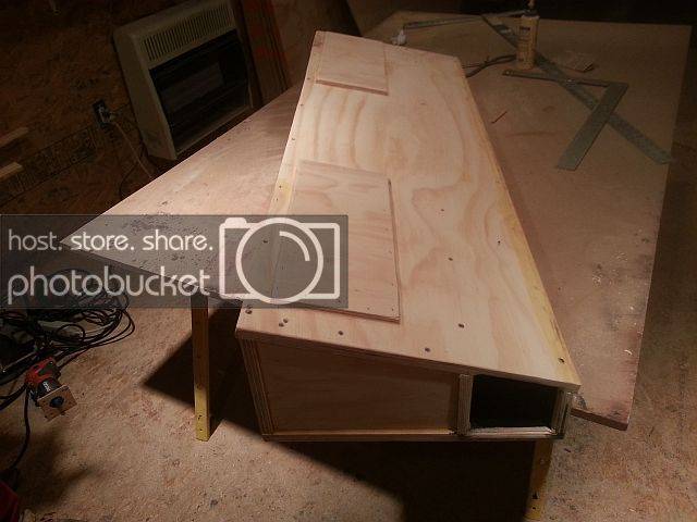

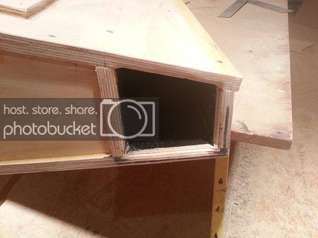

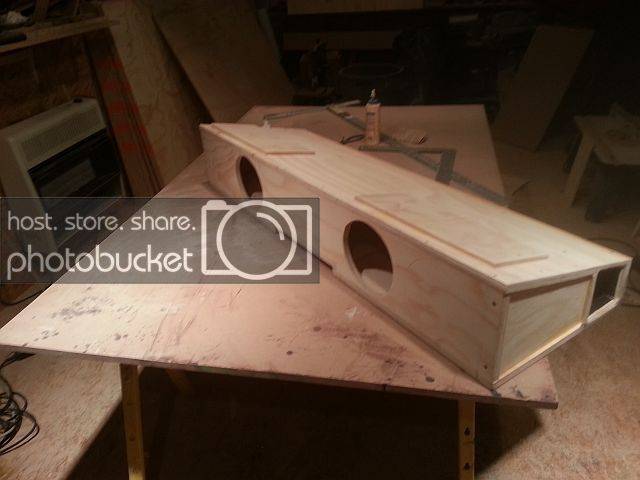

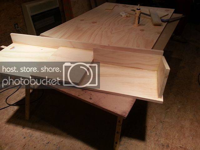

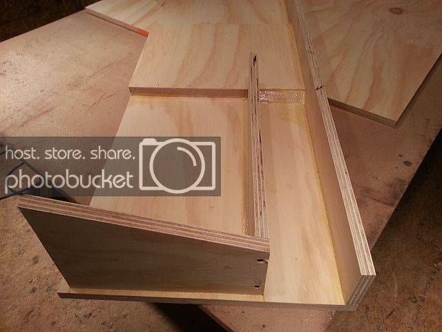

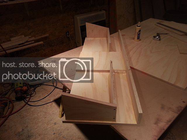

This is going to house a Quartet of SA 8s........2.7 cubes net (.67 per sub)....35hz.......Arauco construction...

I am only cutting two of the holes for him...he is adding the other two subs later.....He will have to be gentle with the power he puts on these 1st 2 because they will be in 1.3cf each till he gets the other 2 subs....
