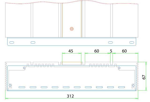

There she is //content.invisioncic.com/y282845/emoticons/smile.gif.1ebc41e1811405b213edfc4622c41e27.gif
Basically stretched the current amp out so it is as close to matching as possible. Feet moved to the ends to keep width increase down as much as possible.

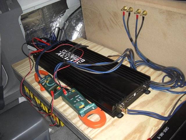

SAZ-4500D:
* SAZ-4500D in prototype case (production will look like above sketch)
POWER : 4870 Watts
AMP VOLTAGE (measured) : 76.0 V
AMP CURRENT (calculated) : 64.08 A
ACTUAL IMPEDANCE (calculated) : 1.18 ohms
SUPPLY VOLTAGE : 12.25 V
http://www.sundownaudio.com/misc/_AMP_POWER/4500D/CIMG2529.MOV
* Power Clamp
http://www.sundownaudio.com/misc/_AMP_POWER/4500D/CIMG2530.MOV
* Voltage Measurement
